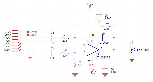

Line Output option
Just asking if this circuit can do the trick. I'm not asking to have this inlcuded on the PCB, but I may try to had by myself a small home made SMD pcb with these parts, mounted on the back of the PCB. I tried to used as many standard parts as possible (same parts used on the stock PCB).
Let me know if the circuit can work and if my parts values make sense. Just one channel is shown.
Thanks in advance..
SB
