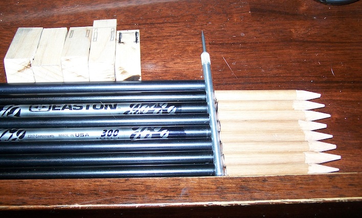

arms cut, headshells begun, Pivot "dowels" are cut and shaped.
I need to drill the dowelling to accept the pen nibs. They are shaped. The arms need to be drilled for the bearings, and the bearings installed. Kudos to Bernie for his headshells, because they are way more difficult to make than one might suspect.
About 30% done those.
Also, where do you folks want the holes drilled for the tonearm wire to exit?

Close to the pivot on top of arm tube.
lateral in opposite side of platter ,where there is a free space

Others: about 65% done making 8 arms. The headshells are a PITA given my limited facilities...
Ok, here's who I have down for an arm:
(that's 7) and????
So one more left (or if i forgot someone either PM me or email me) .
..for any that wondered what the corks were for, they were to stuff into the end of the arm to help reduce resonances (and give a more refined look to the tail end of the arms🙂.
I'm not including the corks as all must have something like that available. You can also use these to help weigh the headshell end down if added mass is required.
Regarding the opening for the wire exit, the holes shall be on the lower side of the arm adjacent to the pivots. I've decided this after some consideration. There is an intention to this location: If the exit for the arm wiring is facing upward, it may create a situation where the wiring will affect the arms' movements across the record. By exiting on the lower side and allowing the wire to loop up, the wire then can be fastened to the pivot holder (dowel), while having little effect on the movement.

headshells all busted....
I measure the diameters of the tonearm shafts, and drilled out the end of the headshells to accept it. I then attempted to insert the arms into the headshells and busted them all. I don't have any "precision equipment, and thus used what I had. This resulted in less than ideal alignment and ...well I busted them all. I guess I may resort to a method aI used previously and use dowelling and small plates as per the Schroeder design...

The headshells for your "219" like the one that I picked up at the Van Island Meet had the hole drilled in the end of the headshell and then was sawn lengthwise through the bottom to the mounting hole with a fine kerf saw in order that a little bit of spread is possible. Bernie seems to have anticipated the need to not only allow for some tolerances, but the possibilty to slide the headshell fore and aft on the armwand. I'm guessing that he figured that when all is adjusted correctly that a drop of glue, or perhaps a dab of hot glue, would fasten the headshell in place. I don't have an email address for him otherwise I would contact him directly and find out for certain.

I understand that Bernie cut the slots. I suggested it to him....the idea was to allow for a screw to be used to clamp the
I think I'll have to buy some tools to do this effectively. I've spent way to much time doing this. I used a table saw and "nibbled away at a plank to create the blanks. Then tried to drill vertical holes. The weren't vertical. Then I tried a couple more times. The problem is lack of suitable tools. Bernie's headshells (I think it was Bernie....) were modelled after an old Kencraft aluminum headshell that I had here.
So a drill press, and an inexpensive band saw.
