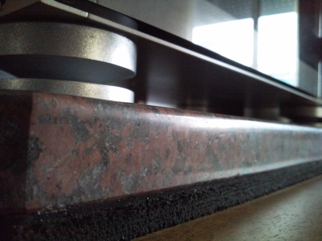

Before taking it home, i took careful measurements for a 3 cm thick granite base.
I decided on African red granite with a surface of 70 X 30 cm.
I handpicked the piece to be cut and it was in my hands ready and polished
within the week.
A wooden shelf on the right side of the turntable had to be cut in a semicircle way
so that one motor could fit in-space in my rack is limited!
With a jig that i use for cutting frames for loudspeakers it was an easy job...Done!
I spent a whole afternoon leveling my audio rack to perfection!
The turntable had adjustable feet but i would prefer leaving them in an up-tight position.

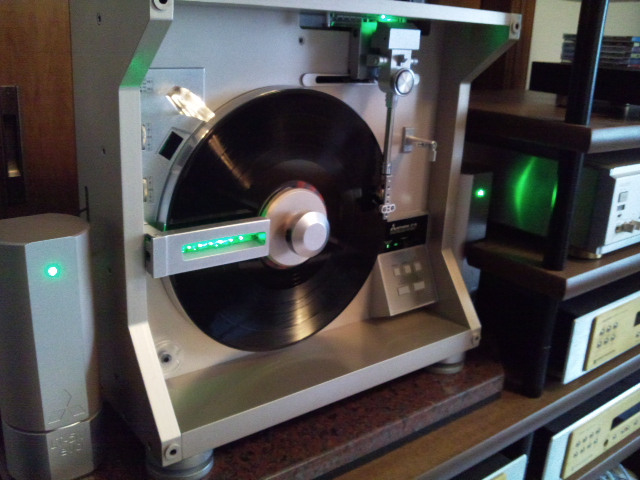

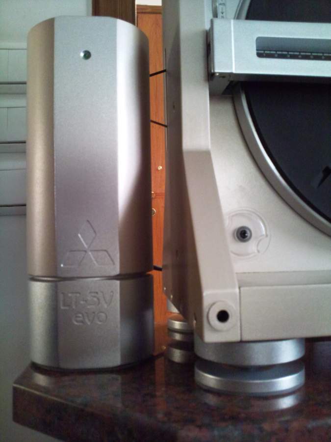

It was Sunday morning and after having a cup of coffee, i started the setting up.
It took me an hour to measure the exact places of the chassis and two motors.
The belts rotate so close together that the two motors need absolutely perfect placing
so that they don't rub to each other.

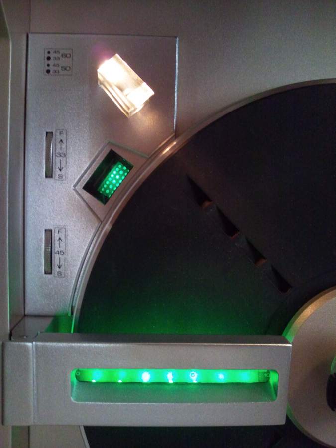

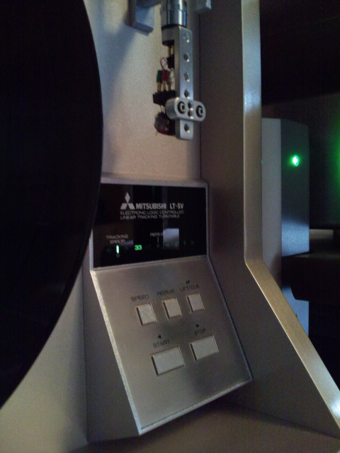

Check of individual speeds:With the front double pot at middle position i dialed the perfect
33 and 45 speeds on each motor just by adjusting the master trimmer on the boards.
Then they both could be tailored with the front double trimmer.Done!

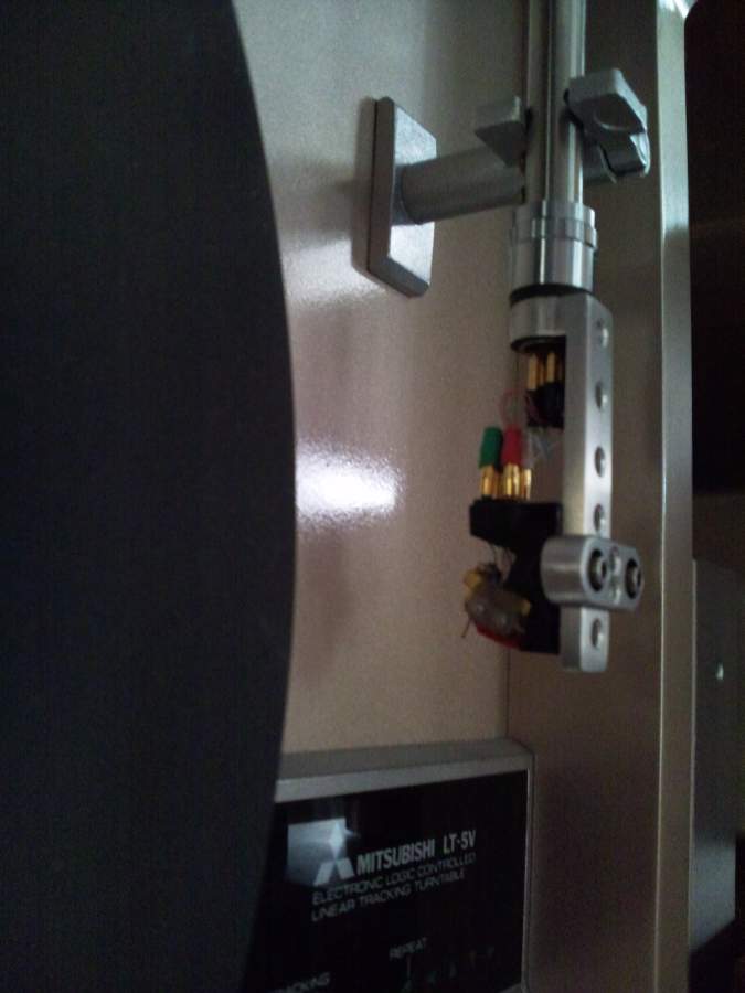

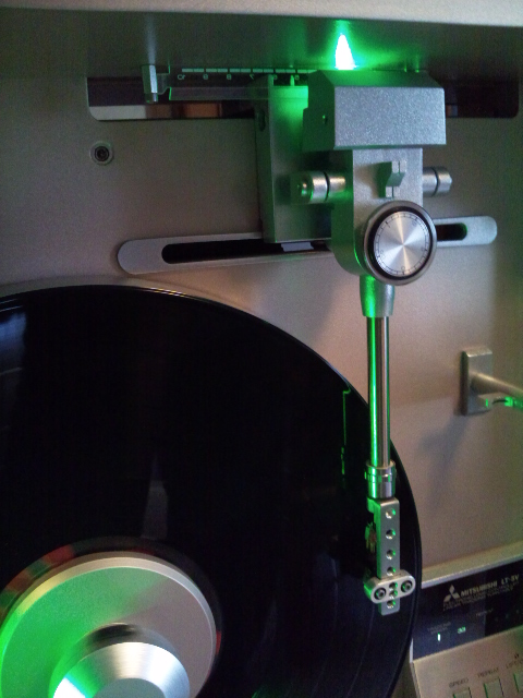

After another check on the leveling of the chassis it was time to set the tonearm right.
First i had to regulate a small rotating weight whithin the major arm weight,
so that the arm is aiming straight down to the center of the earth...
When this was set, with another screw at the side of the arm's base
i set the arms sensors so that they know where the "0" tracking error point is.
With my new headshell loaded with my trusty Van den Hul Condor and my favorite record on the plater
(Elly Ameling sings Bel canto) it was time to rotate the round micro-metric weight
on the face of the arm until it was absolutely parallel to the record.
That is point "0" on the tracking weight.I turned it to a 1.35 grams and double checked it with my digital scale.
Done!
A quick listen through the earphones to dial in the arms "taming" on the back said that things were looking promising...

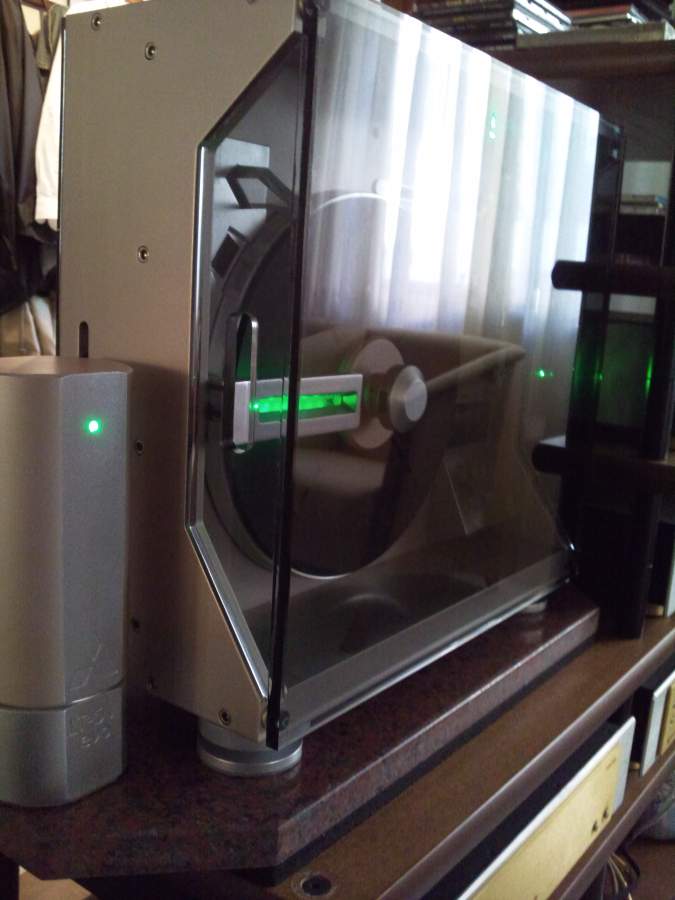

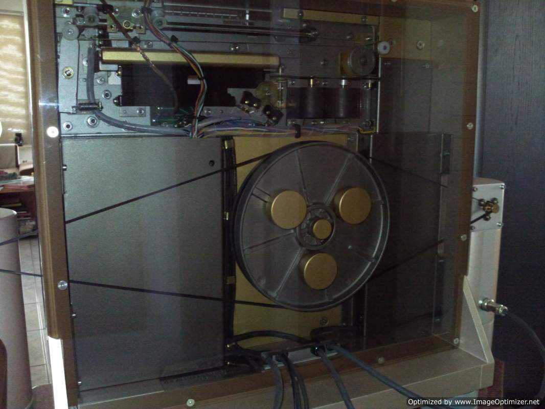

It was time to close the back after a thorough cleaning and dusting off.
With the soft rubber flange attached, i had a nice,non rattling ,secure fit...Done...

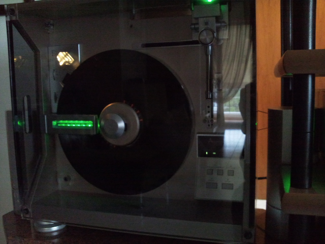

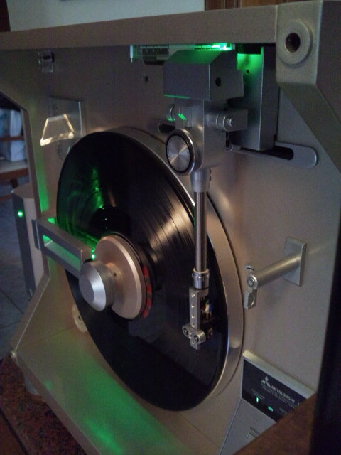

Turned on the system for a thorough listen...
Started from Elly Ameling,to Dire Straits,to Daniel Lanois,to JJ Cale, to ZZtop,to Patricia Barber...
Heaven...

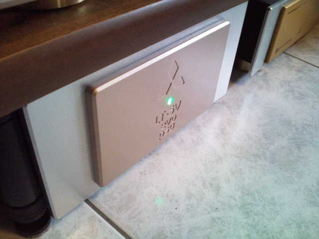

Construction details:Two years planning,prototyping,gathering donor tables and figuring out solutions for my "special needs".
Almost two years actually building this thing, from the moment of ordering the first CNC pieces till the Sunday
that it was in my home playing.
Around 50 trips (that's a lot of gas) to the CNC shop for discussing on CAD files,material selection,metal cutting
and finishing.
Around 900 euro for the three donor tables plus LT-1 tonearm plus Sony headshell(one LT-5V kept untouched)
Around 500 euro for prepping/painting material.
Around 100 euro for the inox screws/washers etc used in every phase of the assembling.
Around 100 euro for silicone sheets in various thicknesses.
A cool 3500 euro for CNC work, metals cost,bushing treatment,platter/subplatter balancing.
Around 200 euro for power/signal cables and termination.
Around 150 euro for Plexiglas covers.
Some hair lost /some went gray...
The table was weighted with the plexi in place and was found 67.5 kilos
The rotating mass (with a 180 gr record playing) is 6.2 kilos
Each motor tower (with motor) was weighted at 13.5 kilos
The PS box is 9.5 kilos.
The granite plate is another 24.5 kilos
