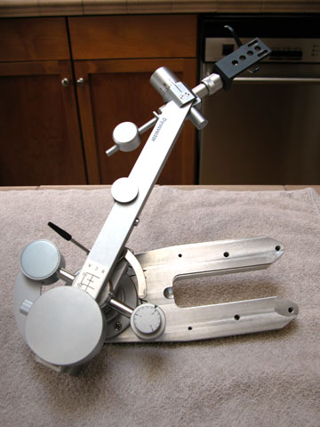

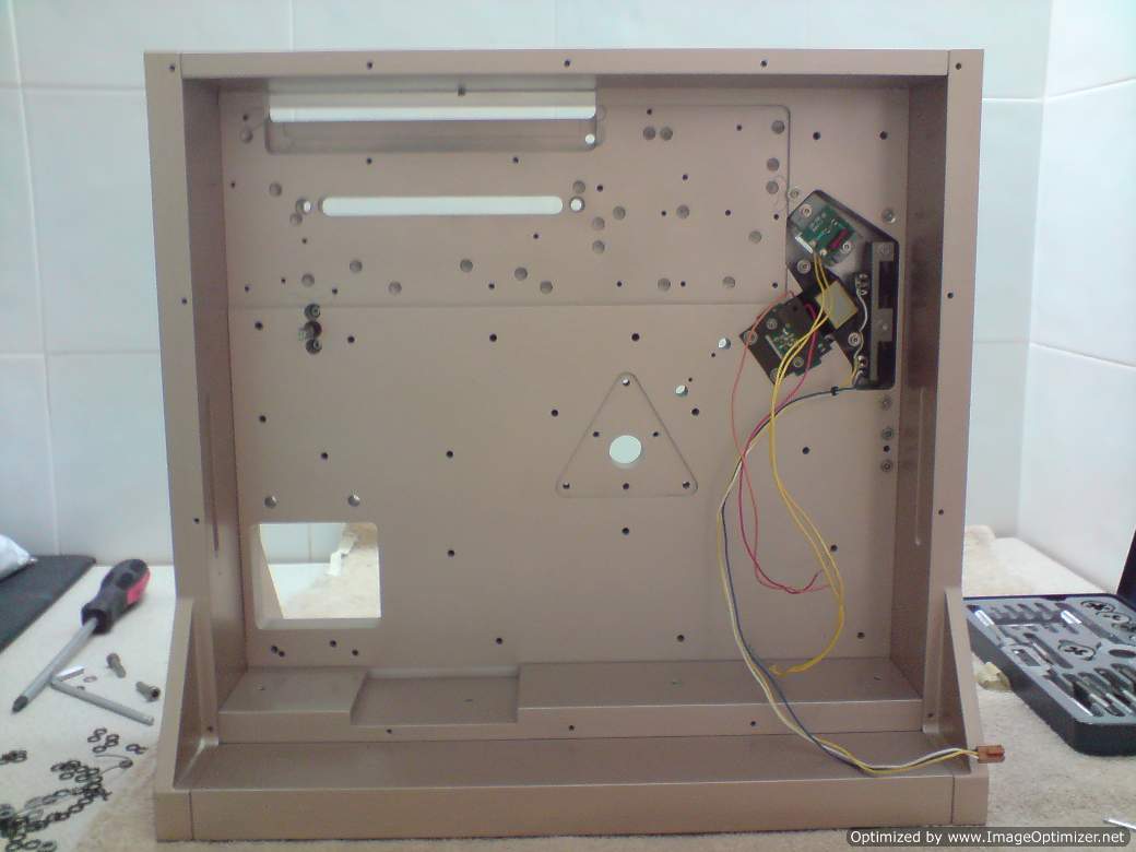

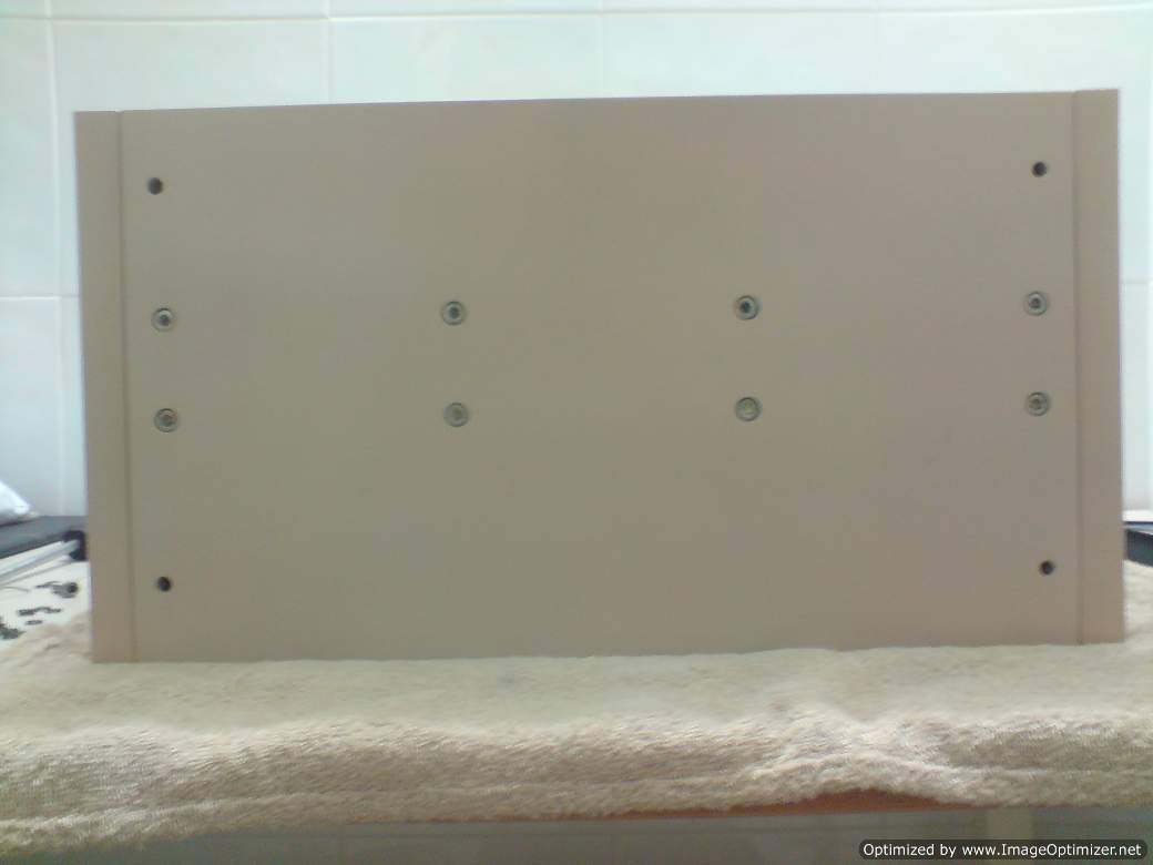

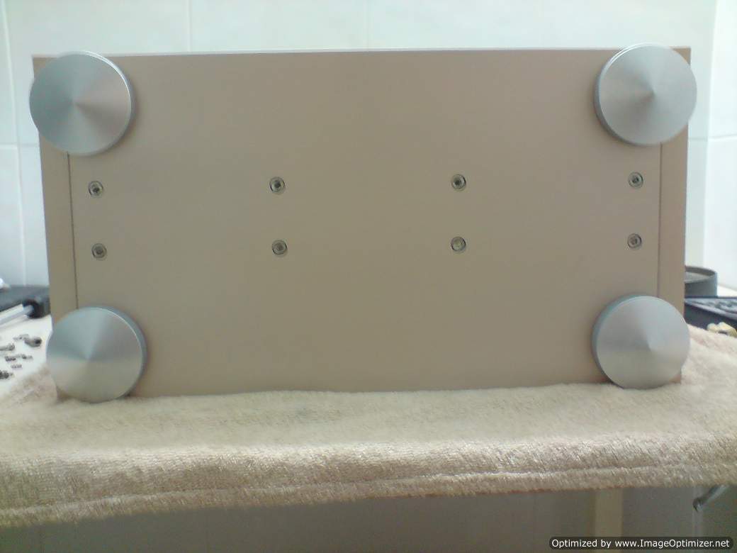

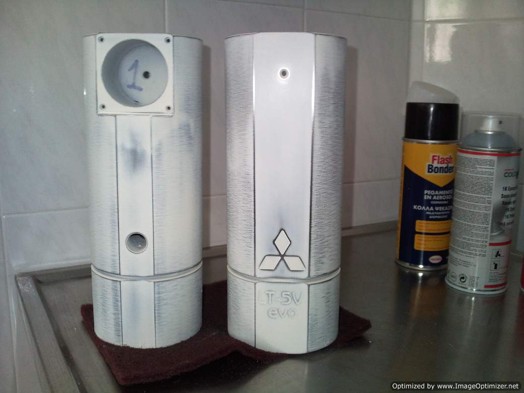

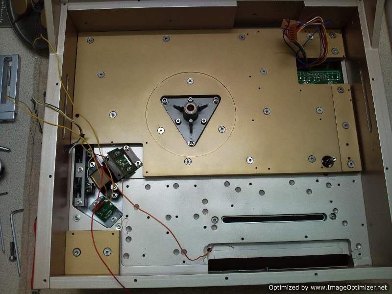

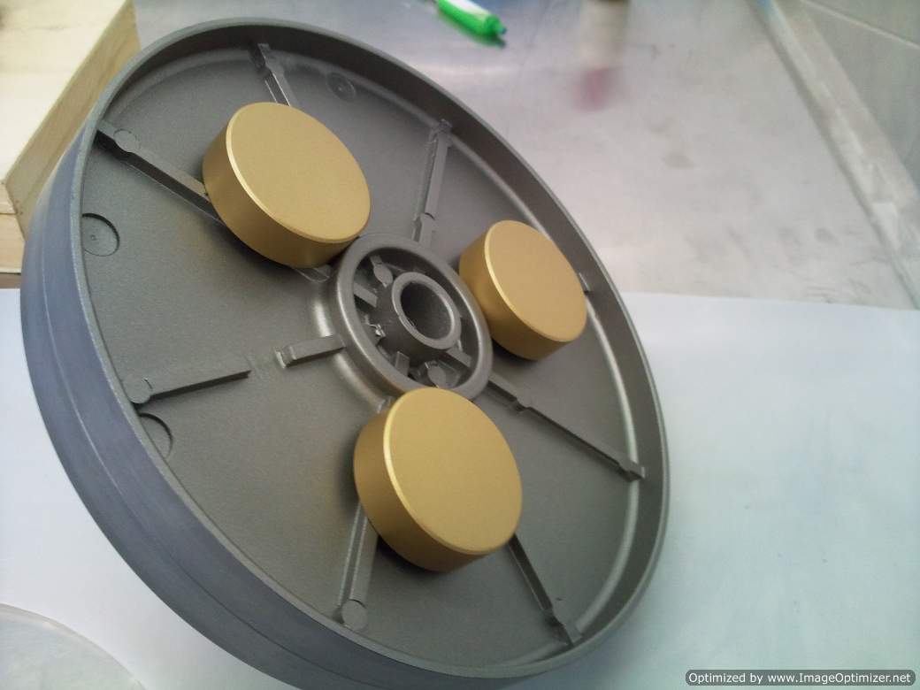

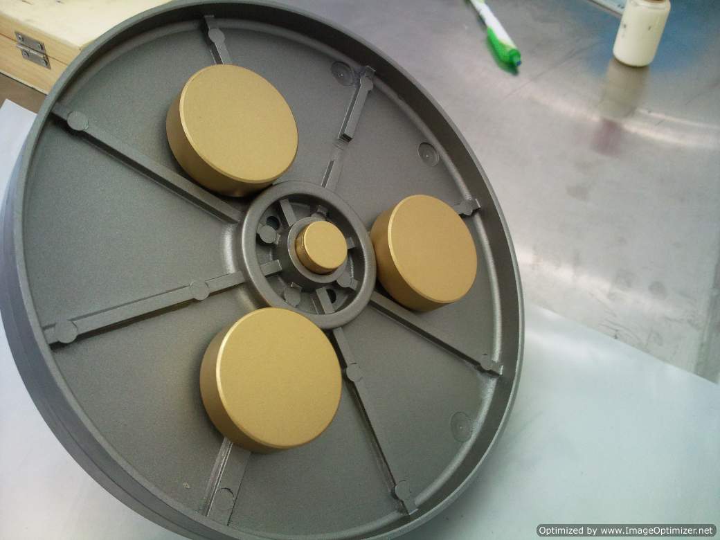

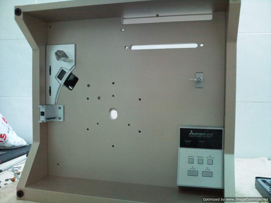

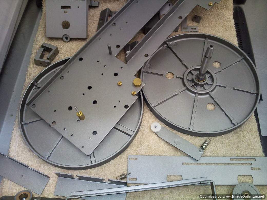

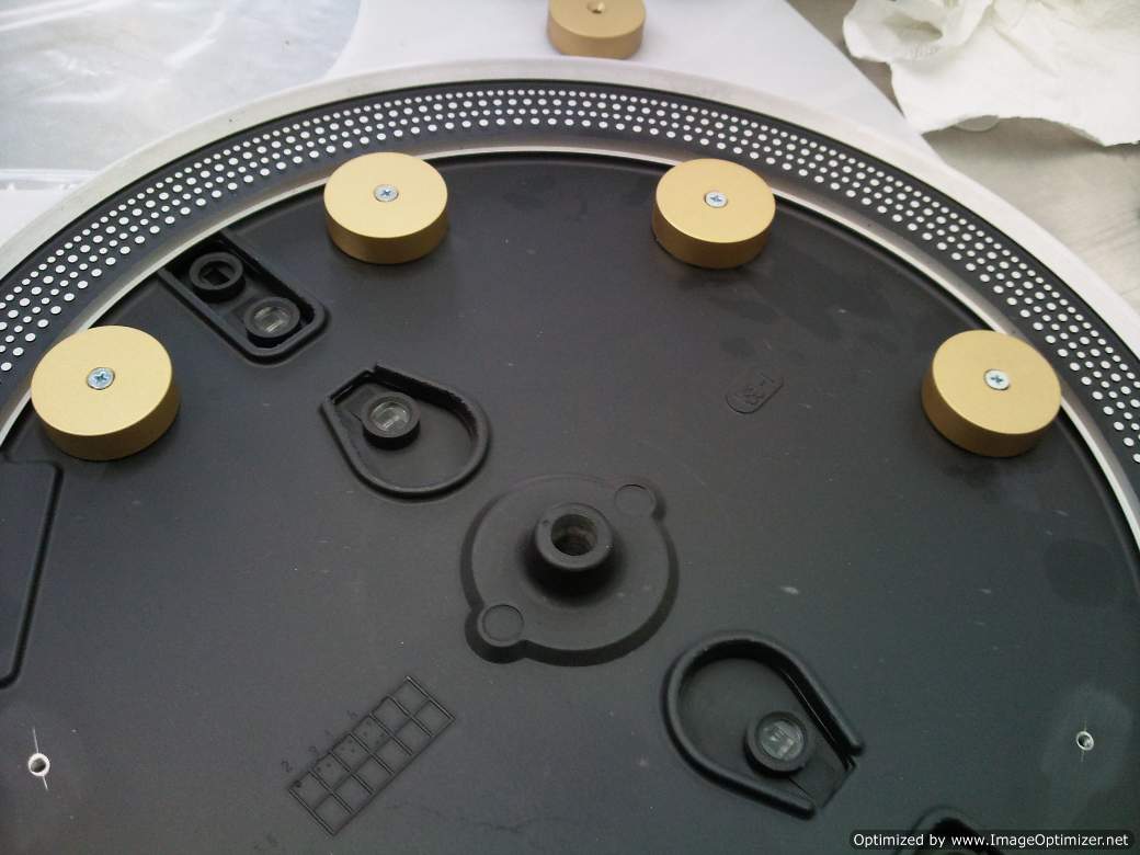

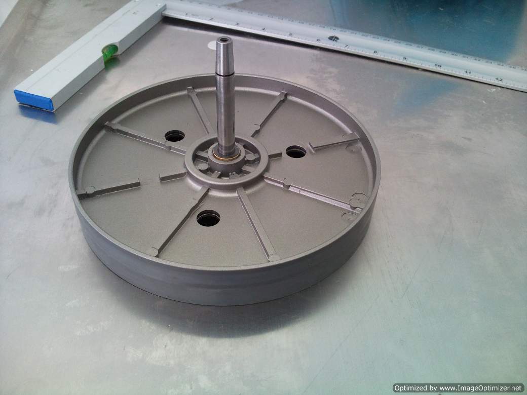

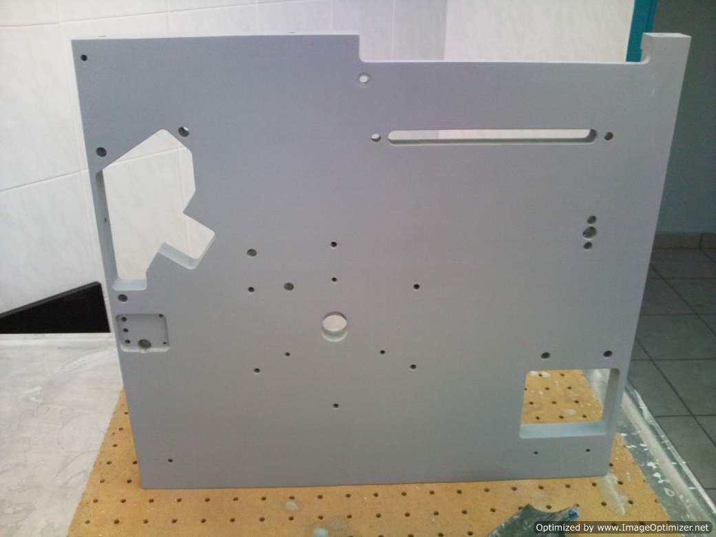

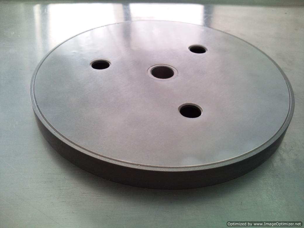

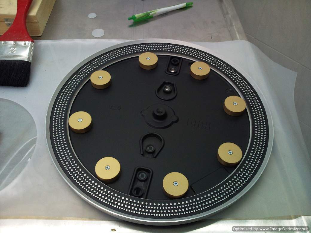

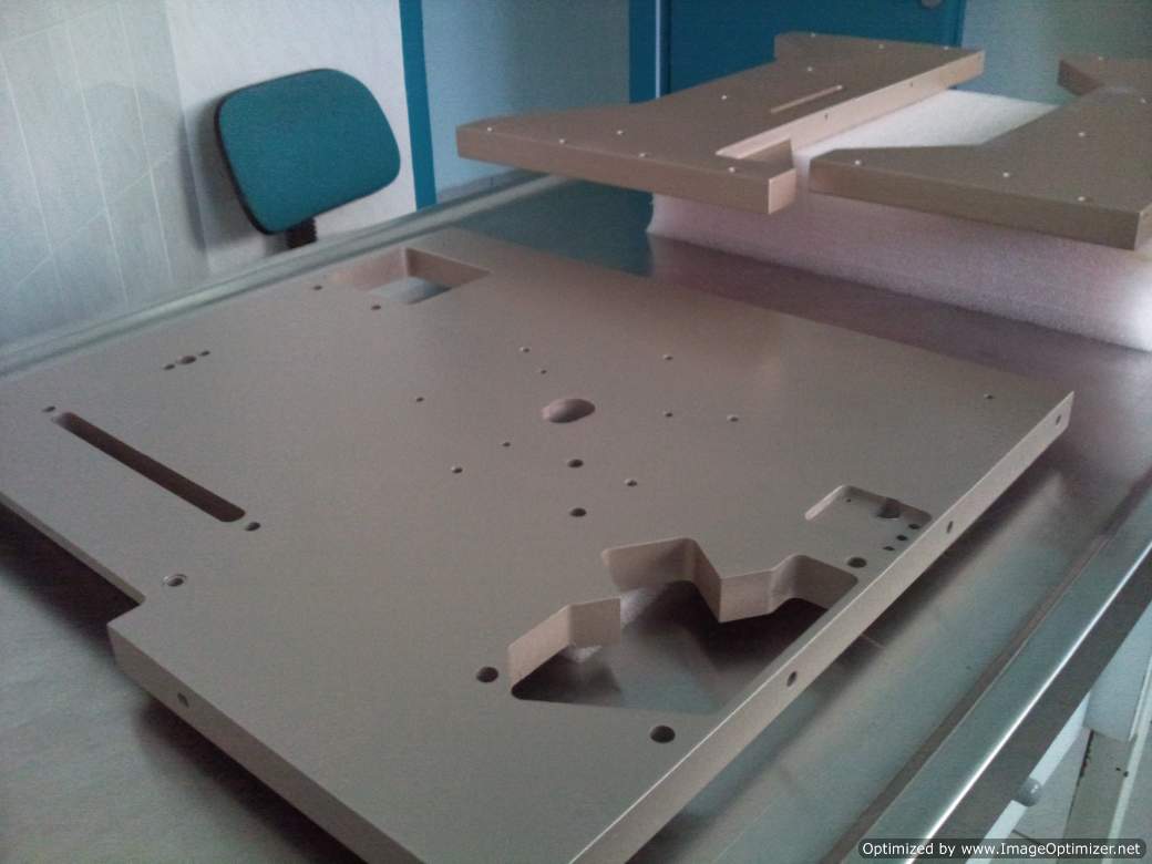

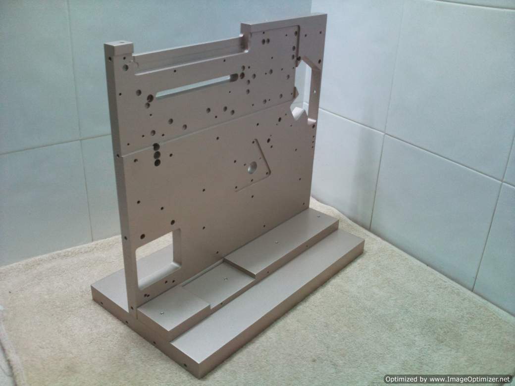

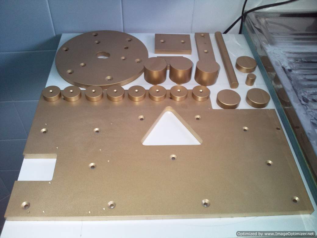

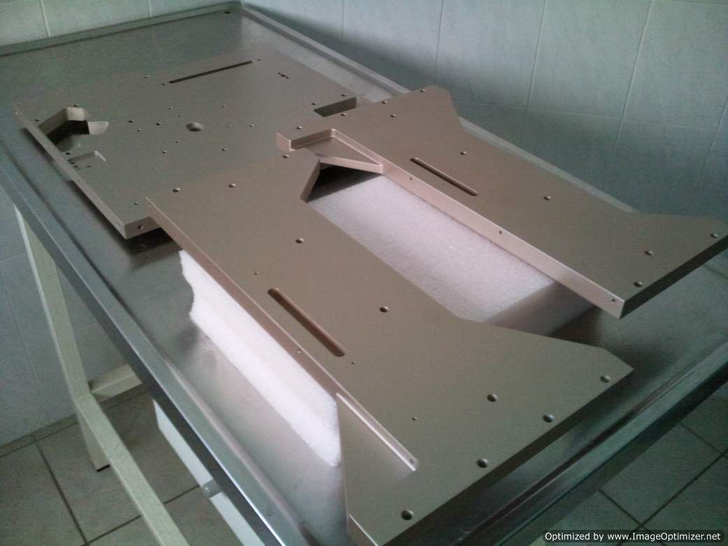

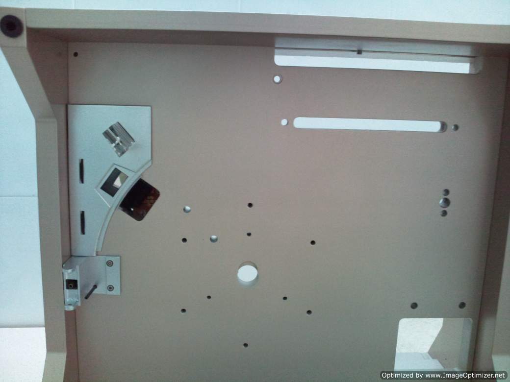

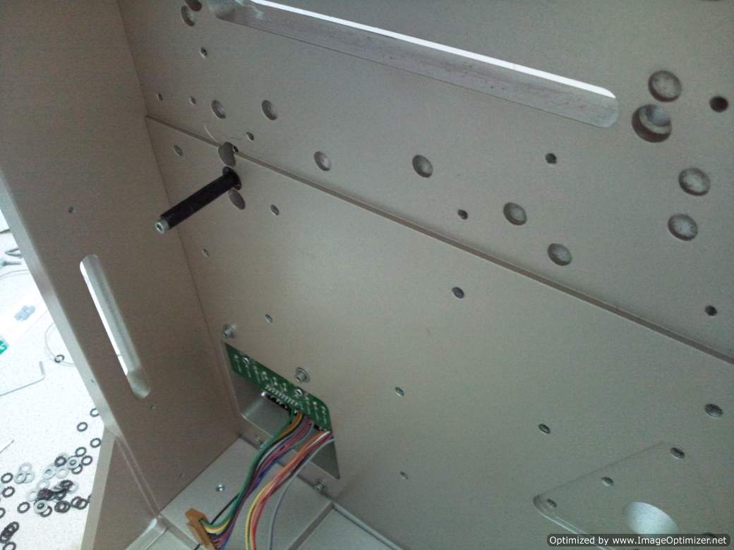

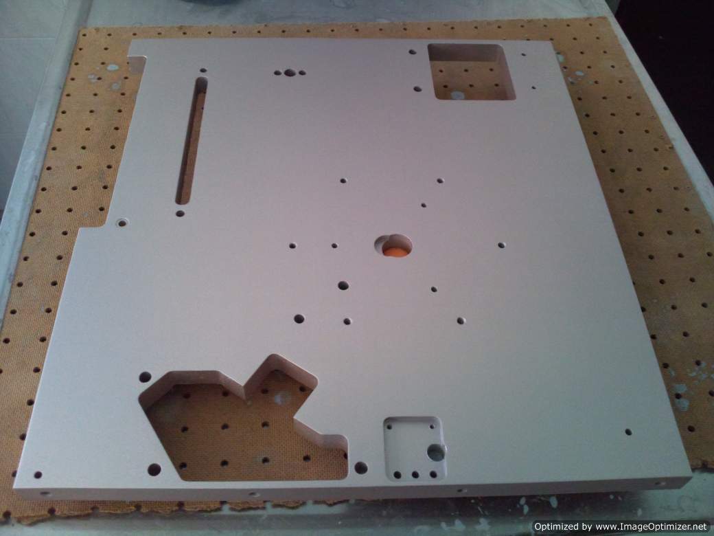

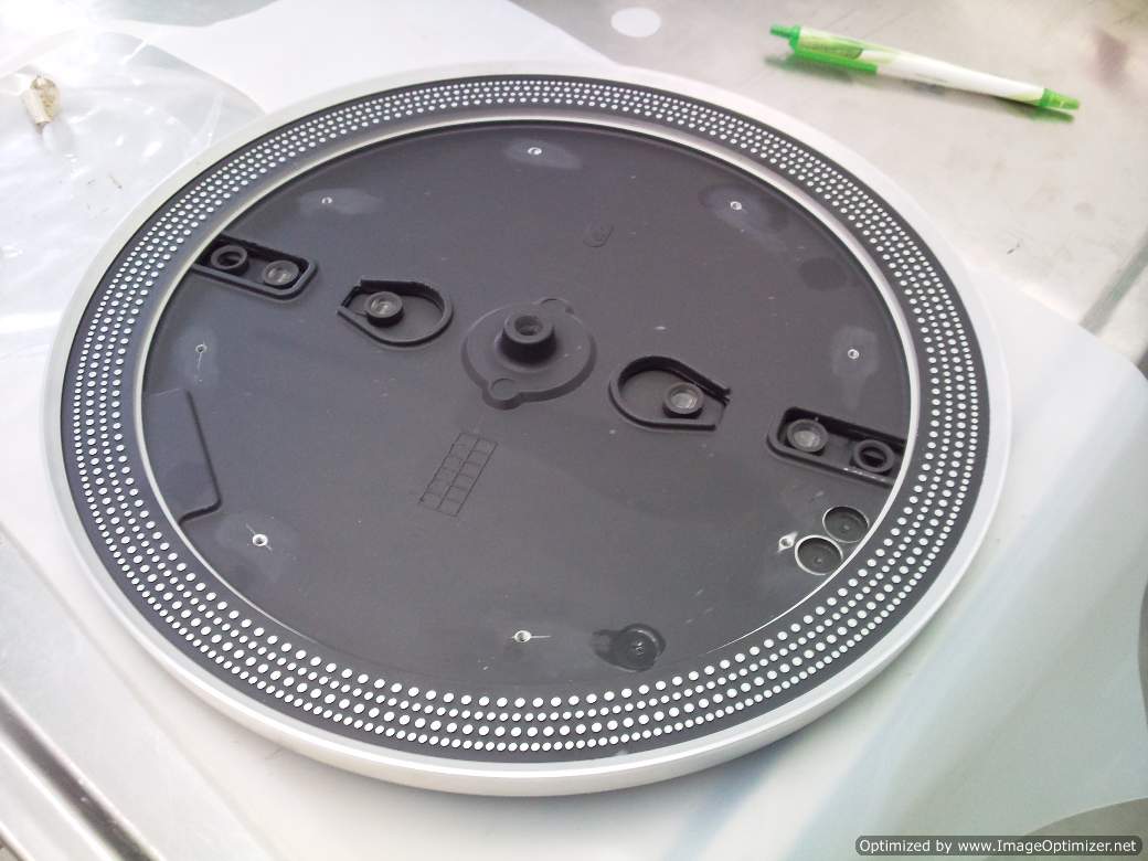

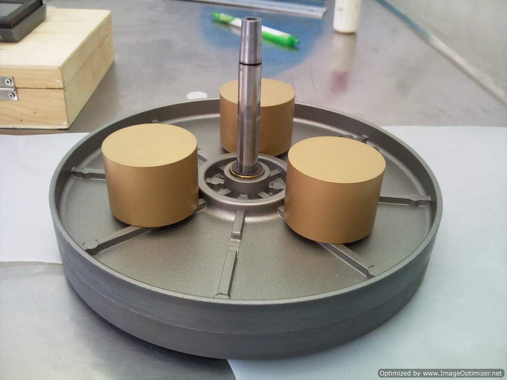

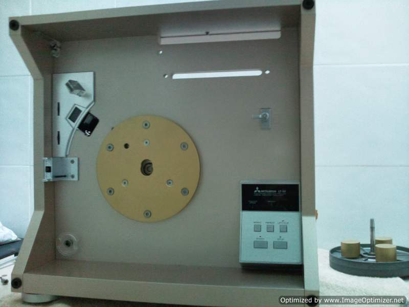

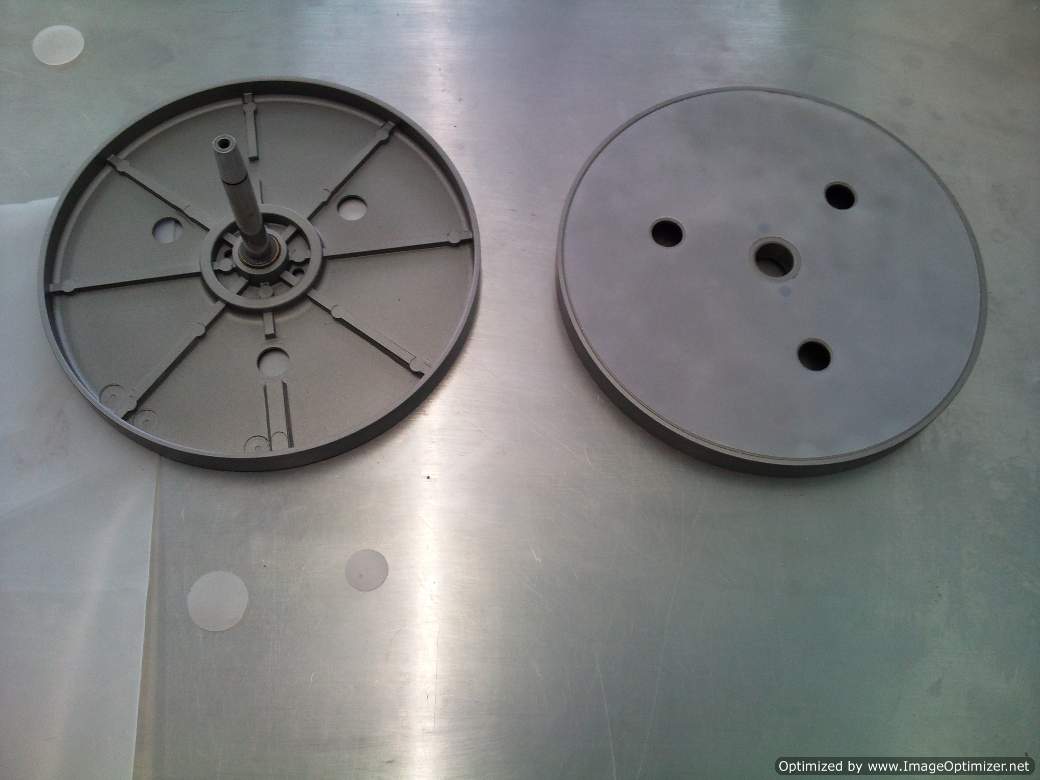

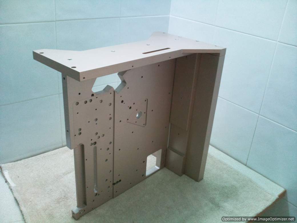

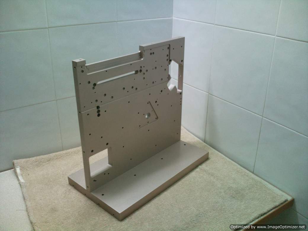

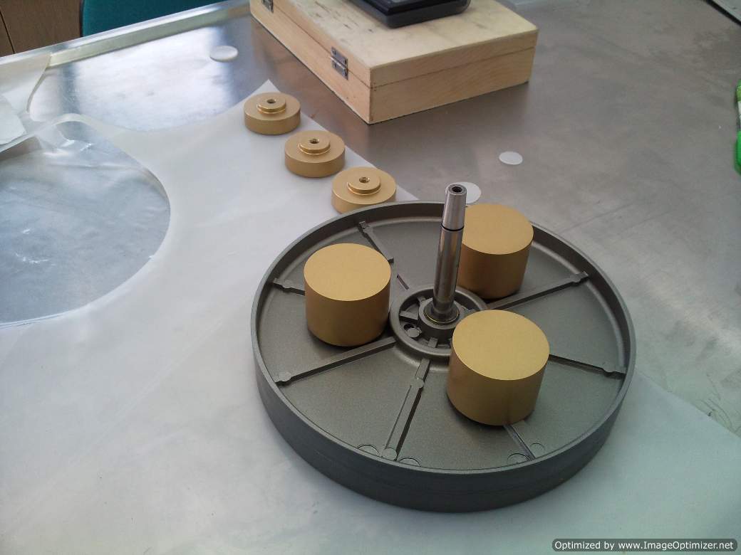

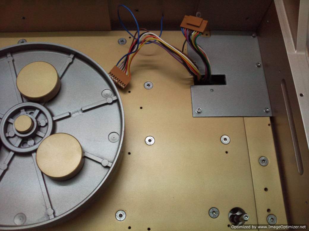

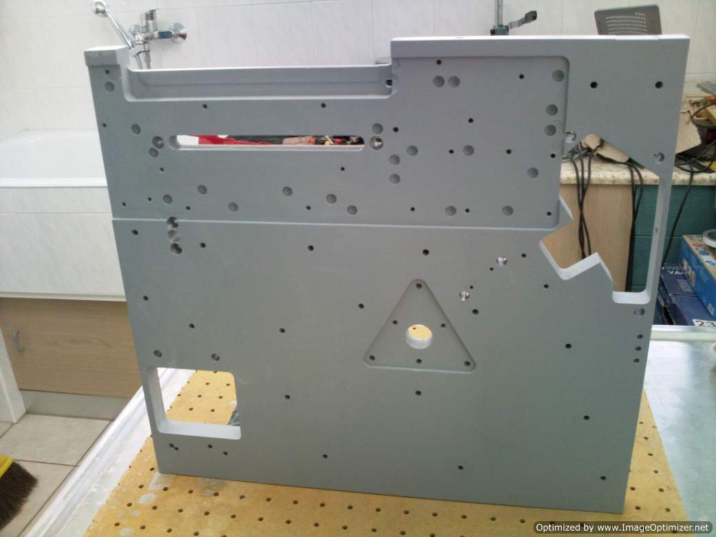

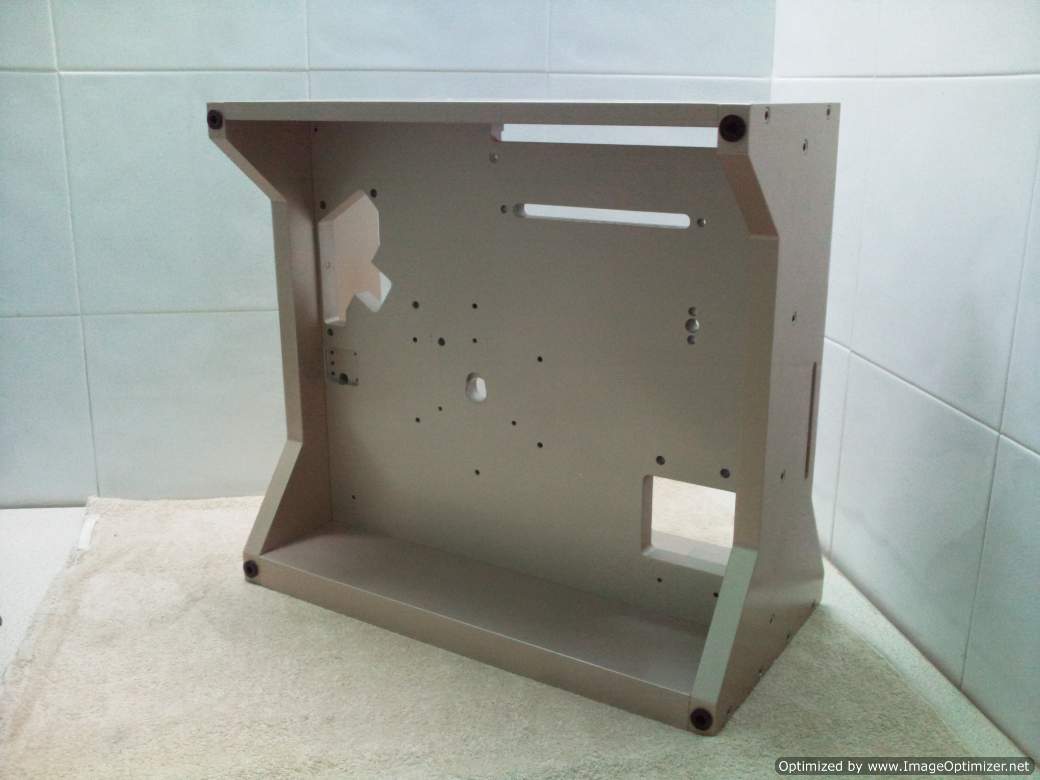

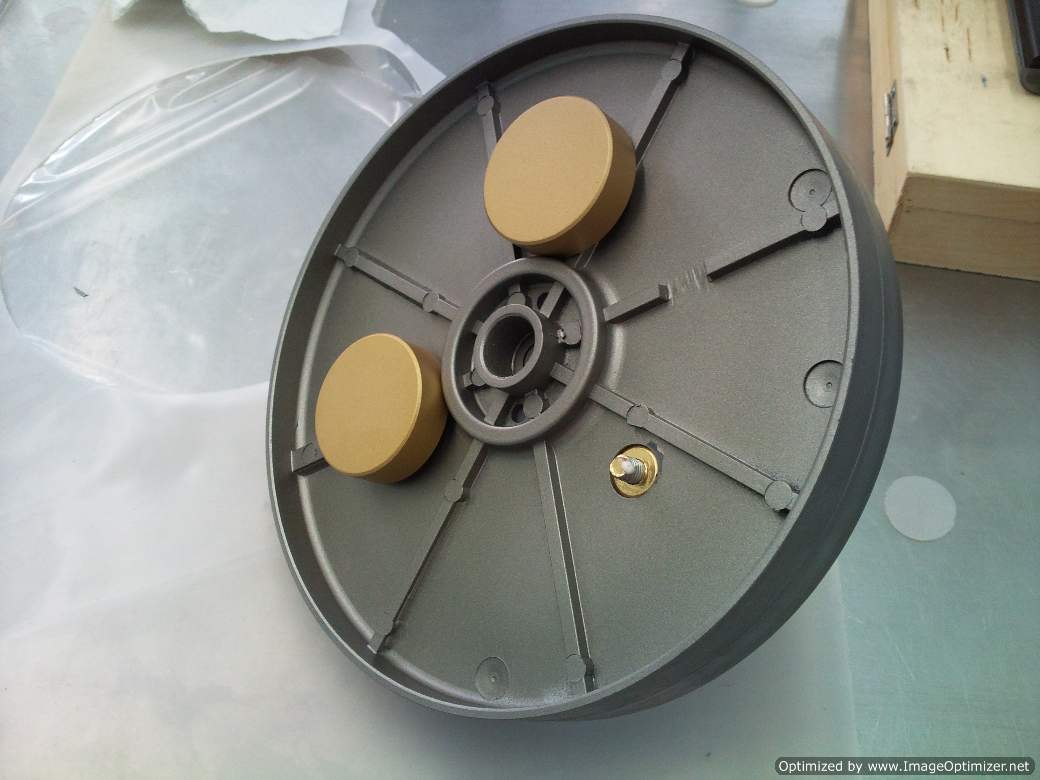

EPISODE-5
Next thing to do was to paint the metal parts...
I had tried in the past a couple body painters but i wasn't satisfied with the outcome.My baby deserved the best!
So i set up a little room (1.25 X 2m) in my practice's basement (that has good ventilation) and i was ready for work...
First a little sanding with a 400 paper to smoothen out rough corners and prepare the surface for the primer.
Then an epoxy primer in three coats.An UV lamp was used to speed the drying process.
I waited for a day before going on with wet/dry sanding with fine grade paper until the surface was satin smooth to the touch.After that, a thorough cleaning of all the surfaces was done for all the dust and particles to go away.This was done to all metal parts (bronze, aluminum , iron).Because all of these had front and back sides that had to be done in progression, and occasionally you have to respray until you get to that "perfect" stage ,i would say that this stage took me a month!
I had learn from previous efforts that paint does not cover anything!
If there is a slightest defect on the surface, the paint will only make it stand out more...
I was ready for color!The original LT-5V was silver,my next lightly modded one was painted black!Well,how about champagne gold with a little silver thrown in for good measure?
With a side panel from my Sony SCD-777ES in hand, i tried to find the closest champagne/gold hue.After three attempts with a different mix, i had a pretty good approximation.
I also bought an off the self silver paint (with a little "glitter" in it to spice things a bit) as i was going for a two-tone approach.
The other metal parts on the back side of the turntable, (mostly original parts) were
going to receive a darker gray color and all the bronze parts a golden one.
Of course, i had to completely dismantle the parallel tracking mechanism,the arm, and separate all the electronics,motors,sensors,cabling-the lot!
I had also to cover and protect from paint all the bushings and axles of revolving parts that were mostly made from self lubricating bronze and inox steel...
The paint was applied in four fine coats and each side was left to dry for two days under the UV lights.Then i would flip and paint the other side in the same manner.
For the two motor "towers" i had decided to paint the lower part and flat
surfaces silver and leave the rest champagne gold.
So at fist i painted them champagne gold,left them to dry,masked the "cheeks" and resprayed the rest in silver.Not an easy task...
When all parts were painted i left them dry out for a week before applying the final
medium gloss coat (four layers)They looked awesome!
And they were left to dry for another week before i tried a little hand rubbing with a
fine polishing paste and soft cloth...

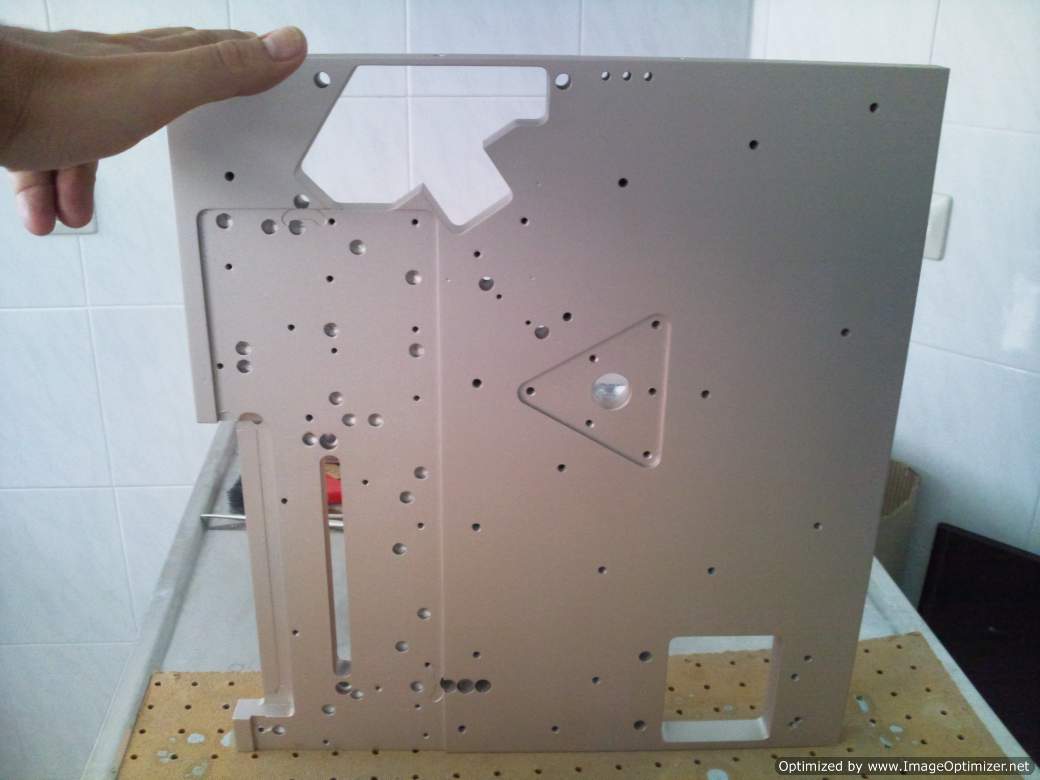

Yes this is the CNC shop.They never thought that high end construction would be a bussiness worthwhile but i think they changed their minds...
I am dealing with them even defore they got the CNC machines...I gave them my pictures and said ok for using them in their site...
In the LT-5V construction they never knew what i was actually buiding (at least on the early stages).
It's ok,they have dogs!

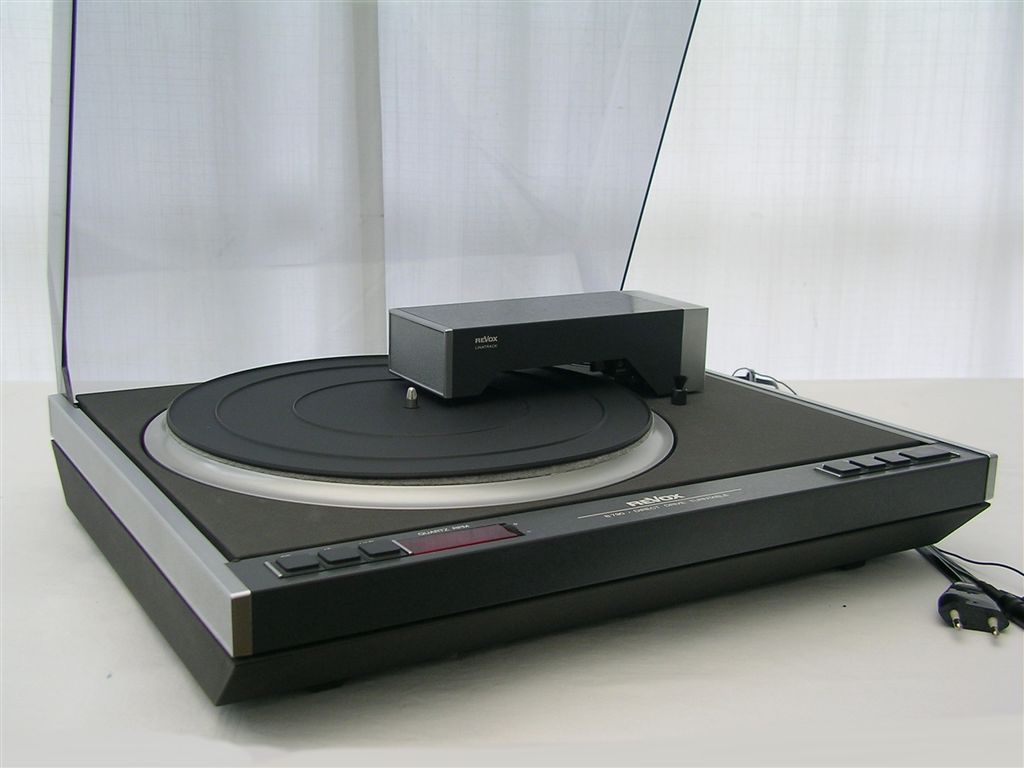

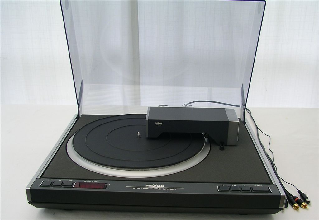

You must be referring to the Revox B795 model.
They can be easily found on ebay.
I have only seen one playing once some 20 years back.
Nobody has asked to do anything on it so i wouldn't know.
Usually REVOX users think that messing with their stuff is sacrilege!
It has a certain reputation for it's electronics and maintenance effort...

EPISODE-6
With all the metal parts painted and ready for assembly, i turned my attention
to other issues.
I dismantled all small boards/leds/electronics from the plastic fascia parts.
After a little sanding with a fine grade paper they were sprayed with a plastics primer
and were ready for painting.
As i was going to use a stand alone clamp i designed a different arm for the track metering scale.
The original plastic arm had the metering scale on top while in my design it was in the middle of the arm and could be viewed through an opening.
I also thought of rear facing leds that would illuminate the record surface to make track selection easier.
The new arm was made by cutting parts from two arms ,adding a solid aluminum block in the middle (with the opening already milled in) filling the gaps with a hard epoxy resin
and then drill and tap in the resin the places for the screws that would hold the rear panel with the led array attached.
It's base was also filled with epoxy resin to incorporate longer bolts so it would be stable anough for the new heavier arm.
It took me a week to fabricate this arm, "dremel" all the details and a couple more days to find the way to pass the powering cables through the arm joint
and through the chassis.
The crystall /strobo/33,45 pots cluster was next.
The red strobo leds were replaced with high intesity greens and the plastic protruding
pot "handles" were cut in solid inox steel.
The lamps of the crystal were a bit yellowish and were replaced with new ones.
The buttons cluster was also dismantled and sheet silicone inserts were placed under the buttons to improve the feel of the "clicking" action.
The buttons themselves were filled with resin and taken out for their "faces" to be painted in the same
silver color as the rest of the stuff.
Also the top of the tonearm was dismantled for the parts to ber painted.
I took extra care to protect the sensitive bearings from paint dust penetrating.
All these parts were painted with three coats of silver paint and then another three coats of high gloss lacquer.
All were left to dy for a week before assembling them.
Extra dampening with the form of self adhesive dynamat pieces was added under all the plastic pieces.
And then i started to put the whole thing together...

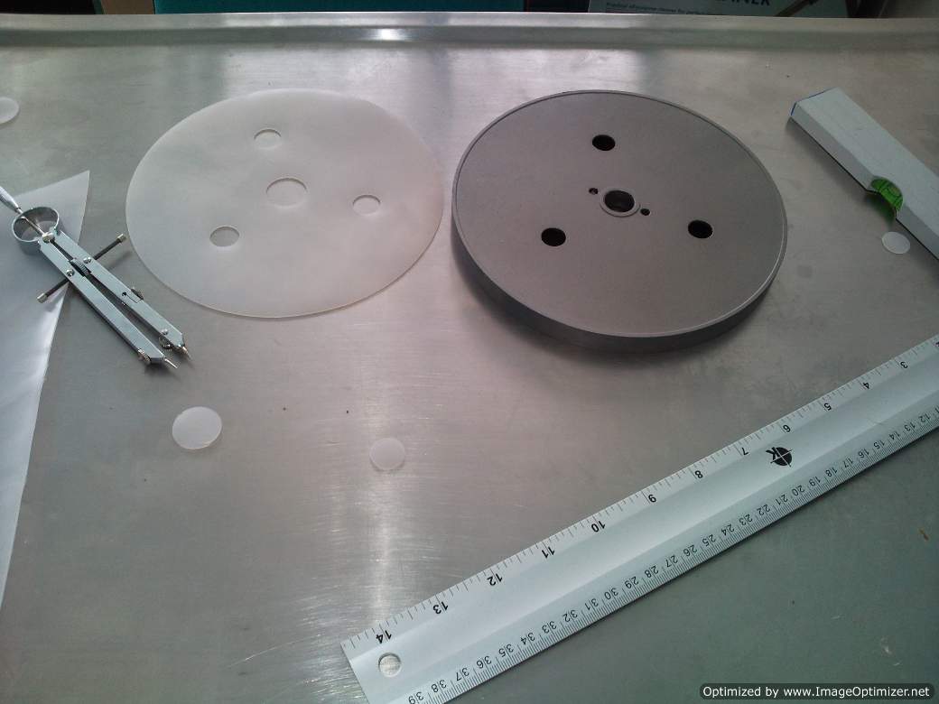

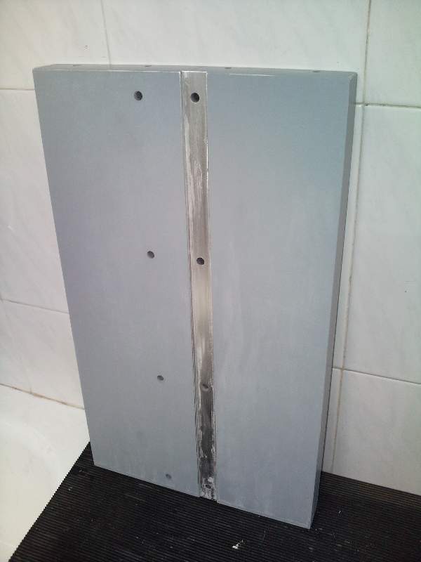

EPISODE-7
I already had in my disposal sheets of different materials whose characteristics i had tried
when the metals were naked (not painted).I was looking for pliable/absorbing materials
that would enhance the connection between different metals,absorb resonant energy,without being thick or messy to work with.
With my stethoscope in hand (in ear?) i tapped away to find what was best.
Sheets of rubber,hard silicone,soft silicone,dynamat and dynamat like materials were tried in succession.Dynamat was best in absorbing the energy from the metal attached to, but a)it didn't "connect" the two metals (you could hear a different pitch if you heard
aluminum or bronze) b)was thick (about 2.5mm throwing my space calculations way off)
c)was messy,as you have to "glue" it to at least one surface and d)from my experience it ages fast (especially in dry warm climates) and looses it's dampening characteristics when it's oily nature dries out.
My next best choice (and the one used) was soft silicone sheet that comes with peel off
protecting plastic sheets at both sides.This is so soft that when you press your finger
on it, you can see your fingerprint for a minute or so!
Those of you who refill their ink cartridges may have encountered this material as protection for the sensitive cartridge heads.
With this material between metals you could see them gel together so nicely that you had a hard time separating them.I remember when once i had to unscrew the rear bronze plate to feed under it the cables powering the illuminating leds,i couldn't separate
the two metals and had to leave them overnight standing with only one loose screw.
It was noon the other day that they came apart!
So the bronze parts were screwed on the aluminum on both sides nice and tight
with this silicone sheet (1,5 mm thick,reduced to 1mm after screwing pressure was applied).The result was an enormously rigid and damped chassis behaving like one solid piece and weighing alone more than 55 kilos.

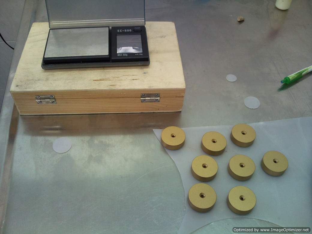

ΕPISODE-8
Some of you watching (?) this will ask :why not go for a bigger front bronze part that would cover as much area under the platter as possible (up to the rim?).
Well, i would have done it this way but i didn't because the space left (31 mm)
was used for attaching weights on the periphery on the underside of the platter.
The reason for this (as seen in many turntables,see Gyrodeck) is to increase rotational inertia which promotes the speed stability.
I have opted for round bronze disks with a diameter of 3 cms and a height of 1 cm.
That left me 1mm free space from the chassis attached bronze disk.
I marked the places on the underside of the platter, drilled and tapped the holes and screwed in place the weights (added a little glue just to be sure).
This produced a total weight of 2550 grams.A nice start.
The original turntable did not match the weight on one side of the spindle to the weight
of the other...I don't know why, but this was all wrong in my book!
So i calculated the weight of my new clamp and choose to say that a typical record
would be around the 180 gr mark.
This produced a total frontal weight of 3100 gr.
To get the same weight on the subplatter side,i used two original subplatters each one facing the other (with a silicone sheet between them) attached with three (two-parted)
weights that would pass their screws through three factory cut openings.
It sounds more complicated than it really is...
With careful CNC trimming of the weights i achieved perfect balance...
So with a record in place i would have a total (give or take - depending on the actual record weight) of 6.2 kilos of rotating mass equally balanced.
The spindle carrier received three more holes for a total of six M5 securing bolts.
The two original bushings were tapped out, given an inspection and proved ok.
To aid lubrication a spiral route was cut on their axle facing surface with a "stop" at the end of the front and back one,without a stop on the new middle one.
The "stop" was there to keep the lubricant from spilling out whereas in the middle
bushing there was no such need.Four tiny holes where drilled though the body of the middle bushing to equalize the lubricant pressure on the two "chambers".
Originally there was no middle bushing but i took one out of a spare spindle carrier,modded it to my wishes,and then gently tapped it back to the center of the spindle assembly that i was going to use.
The reason for all this is that there was now
more support to the axle and zero "bending" in the middle due to the increased weight.
See the pictures...
See the pictures...
How do you know ?
When both (platter and subplatter) were ready i took them to a specialized shop that balances camshafts for engines.
There, were given a spin and balanced within 1 gram at 500 rpm (speed that a turntable only dreams of).
Actually the platter even with my weights attached measured admirably well!
It's the subplatter that around 3 grams had to be shaved off.
You can see where the extra metal is gone on the last picture where a "nerve"
is cut off.
And some more photos...
is cut off.
