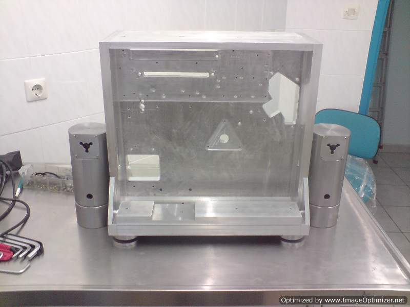

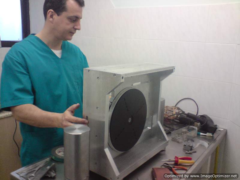

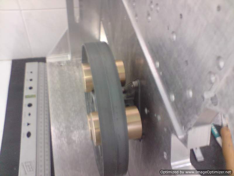

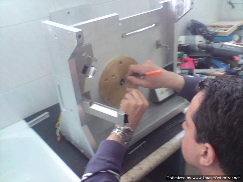

EPISODE-5
So it was back to the CNC guys for a new round of calculations and metal cutting.
I designed two tall cylinders with an opening on top where the belt motor was going to be placed in.The spindle of the motor had to be on the same horizontal plane with the platter spindle so that the "pull" of the right belt would be equalized by the "pull" of the left one.For aesthetic reasons the cylinders were cut on the front to produce a flat "face" (with the engraved logo) and on the back for placing the cable connector and for securing the motor.Additional drilling had to be done from the base all the way up to the motor place to create a route for the cables.
The motors were cut from solid blocks of leaded steel.For each one to make the CNC
machine took 4 hours.They were weighted at 13 kilos each!
From the same metal we had cut the spikes that would support the turntable...
Next to be cut were the bronze parts...
To get an even more "silent" chassis i have asked for two bronze plates to place on each side of the aluminum.The rear one was rectangular and would cover all the back except from the place that the tracking mechanism would attach.
The front was round and would damp the area around the spindle...
Maximum thickness i could use was 1 cm because that was the free space under the hollow platter on the front and the rotating weights of the subplatter at the rear.
From bronze were also cut the extra weights that i was going to use on the platter and subplatter plus a solid rod for extra dampening of the tracking mechanism...
Last job for the CNC was the aluminum parts:the two faceplates of the PS box (1cm thick)
with appropriate engraving,the cups for the four spikes (out of super hard aluminum)
and the openings on the two side plates for the belts to pass through.
After a couple days i had all the parts in my hand and i was ready for test assembly...
See it in pictures...

Salas, yes i am a vet (if you look carefully besides the green surgery outfit you may also see a muzzle and hair grooming stuff).The whole project took place in my practice
where i have a lot of spare space.My working hours are so long i practically live there...
But available time is limited,so my projects take a long time to finish...

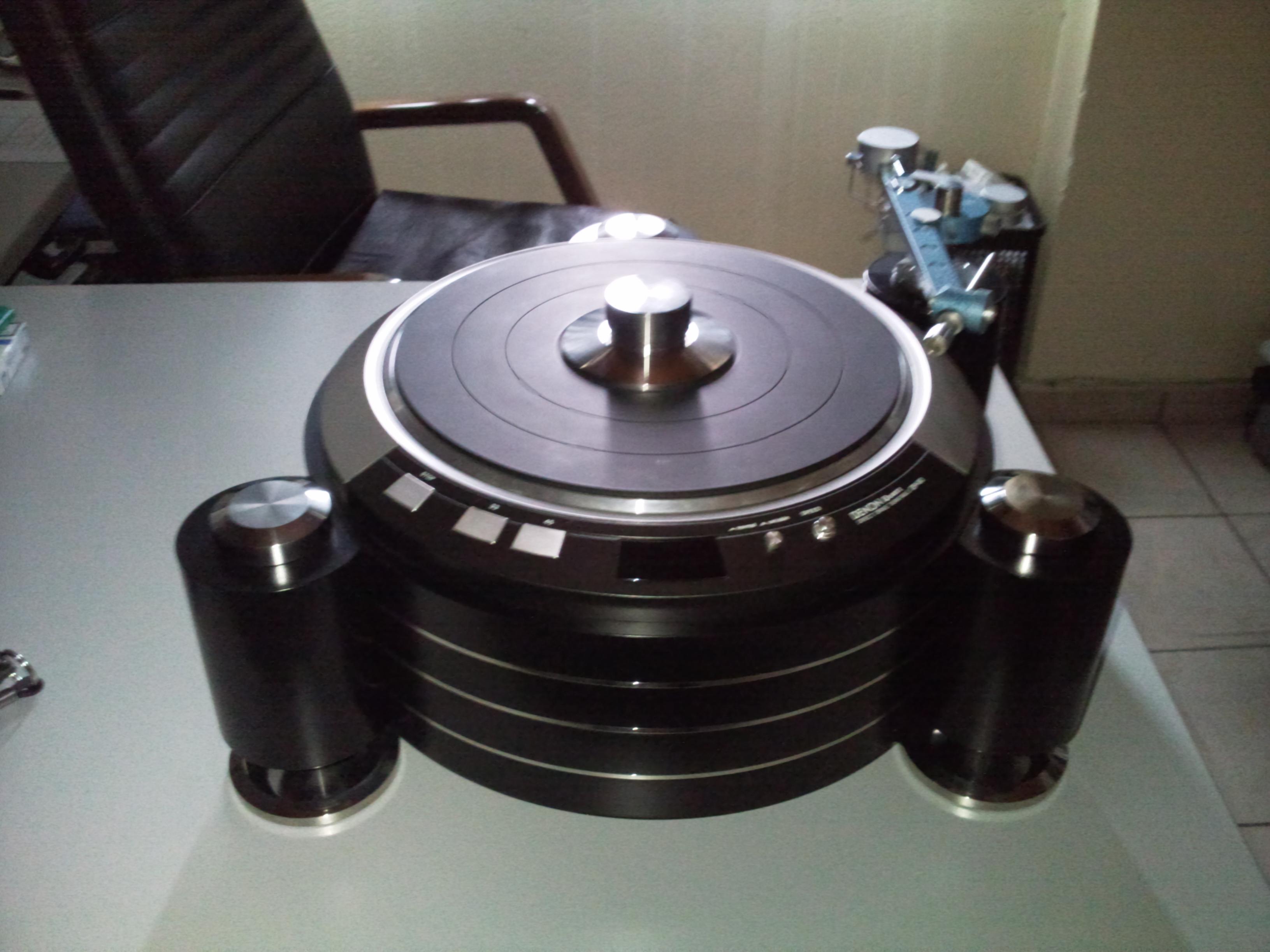

But please don't think that since i am a doctor i am a novice...
Teaser for DD lovers(theophile are you there?):see photo...

Nice diy Denon plinth!!! Is it the DP-6000?
καλό όλοι νύχτα
Nope...DP-80 designed for a friend...with outboard power supply, various tweaks under the hood and Dynavector arm...
If you want DD this is the way to go.
