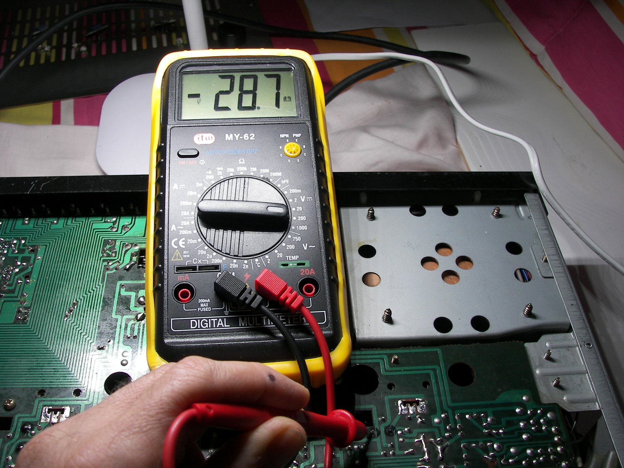

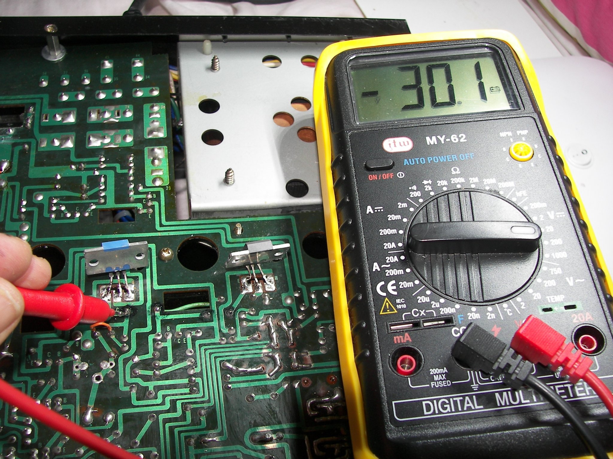

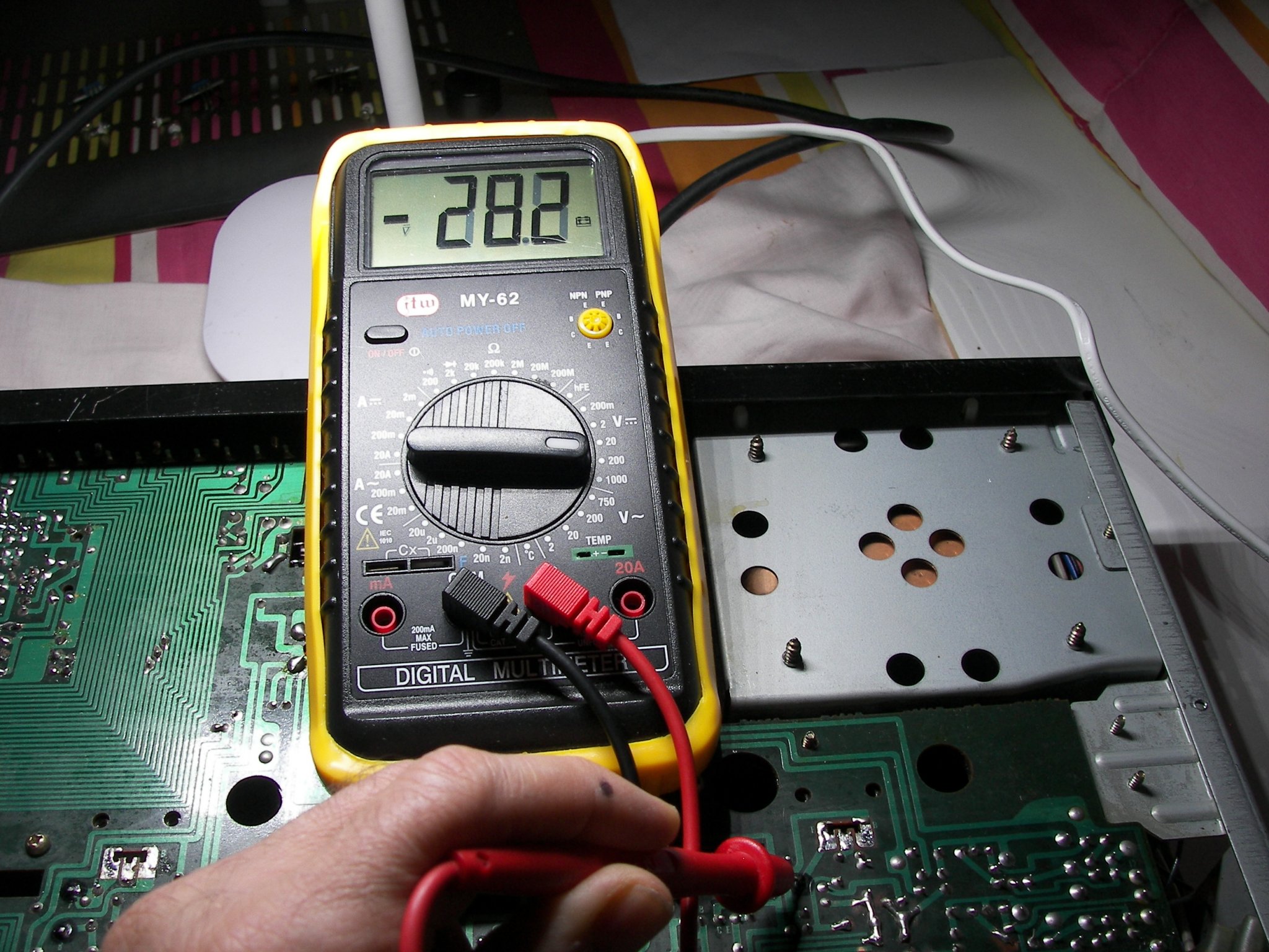

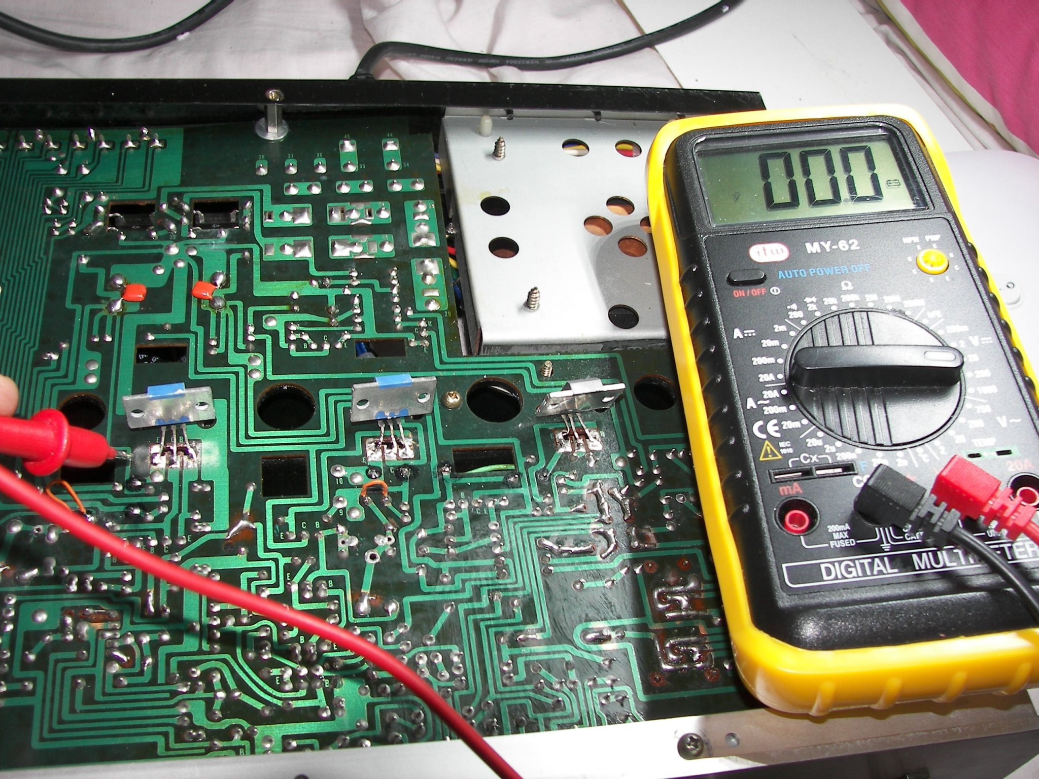

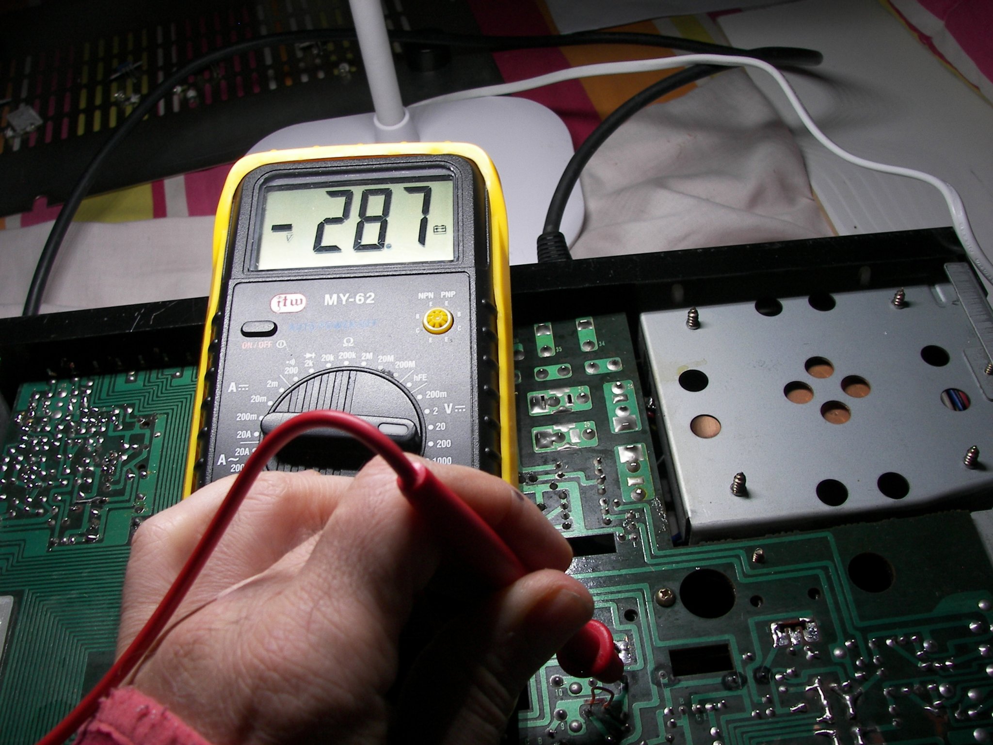

OK. Checking DC on the four 0,33 resistors, with Dm5 and DmM6 shorted, with safety bulb to power up.
One channel ok (close to zero) but the other channel too high: -28,7 V. in each leg of R81 and R83.

So this seems to show the PNP output is possibly defective. We know you had zero volts on the 0.33 ohm with them both removed.
One more thing to check first. Switch off and make sure that Rm79 and Rm77 are OK (both 330 ohm). If they are then remove the PNP output and check it on a meter for leakage.

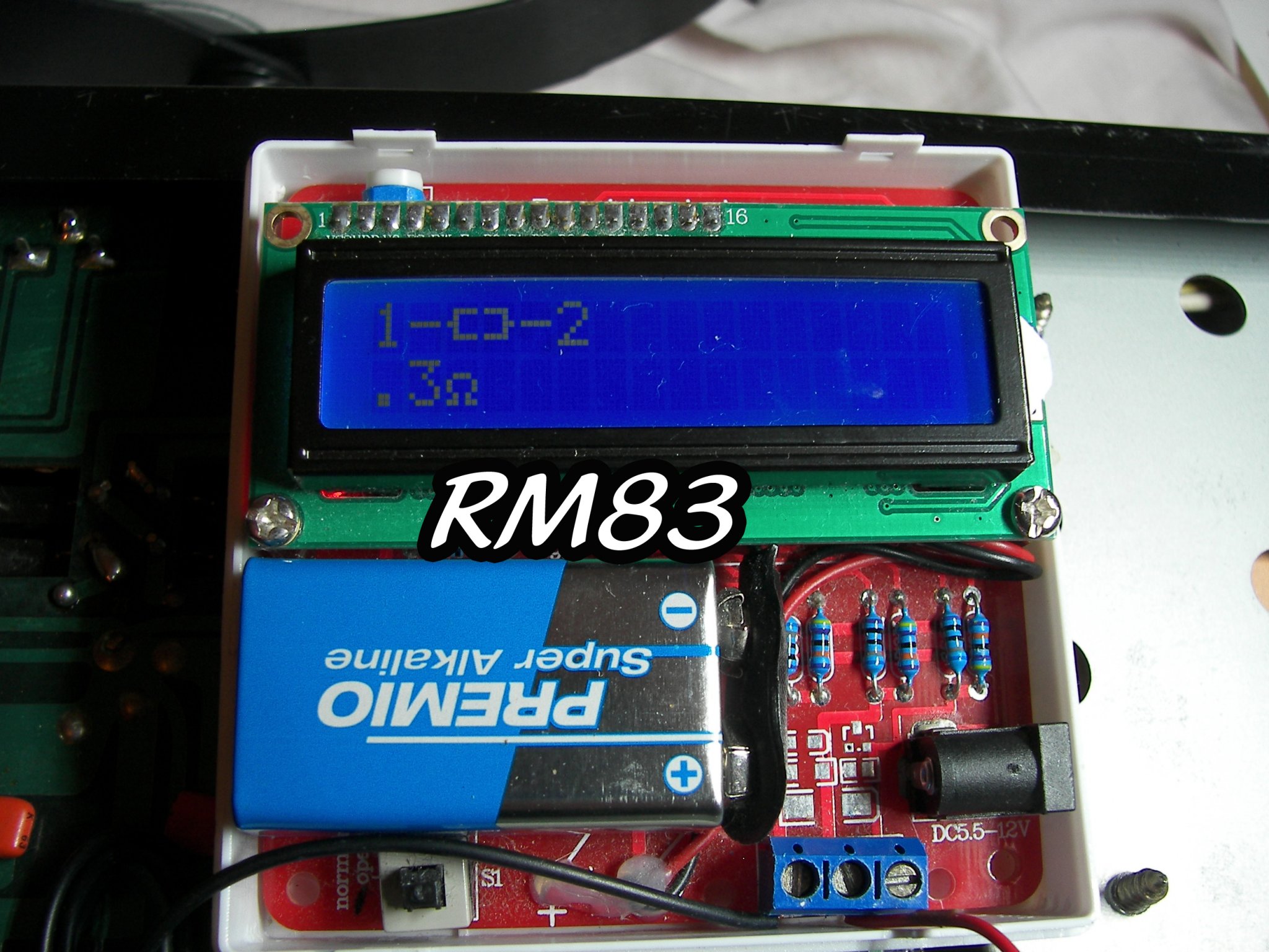

4x0,33ΩK resistors. Main fuses of power supply OK.

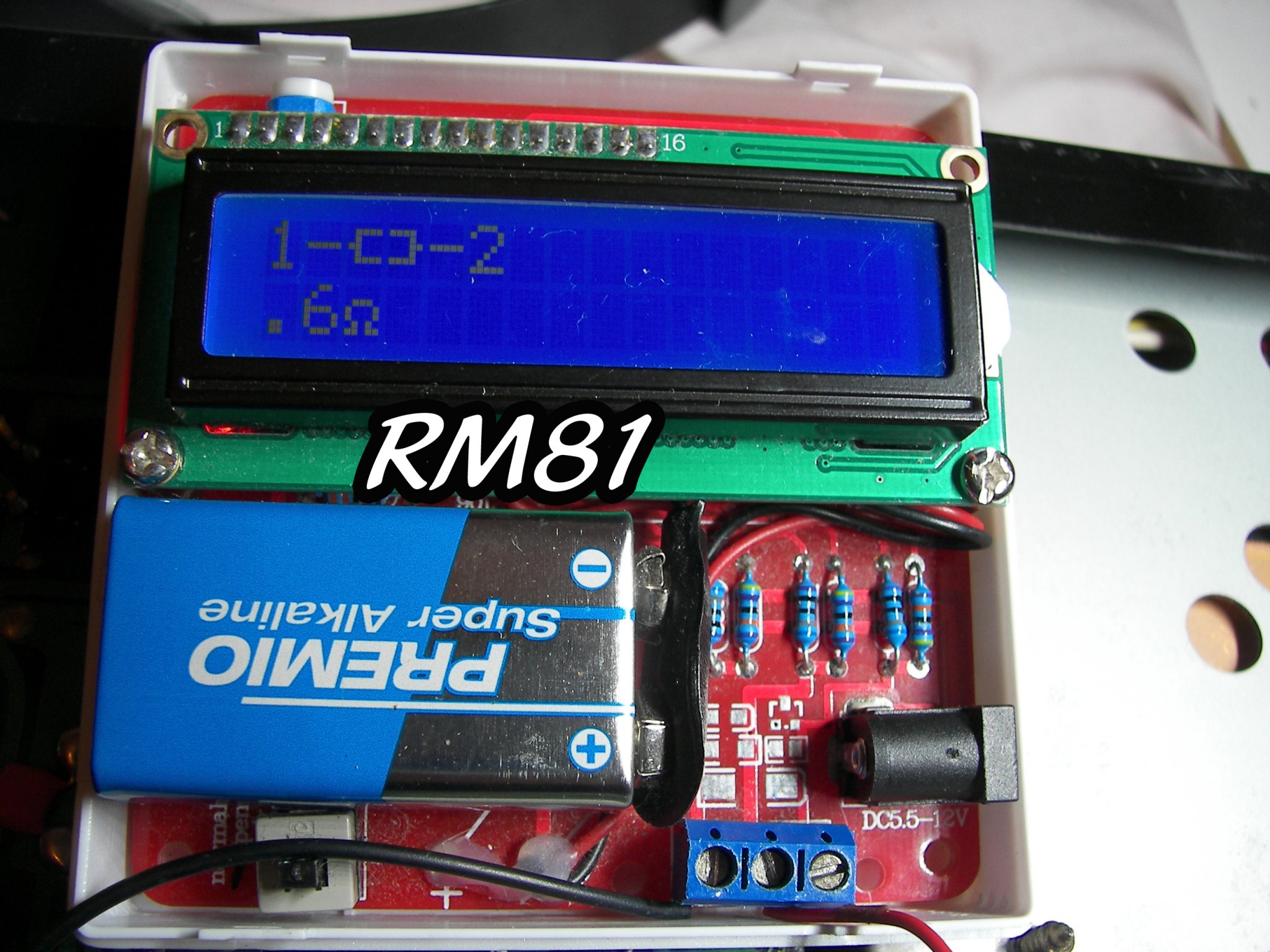

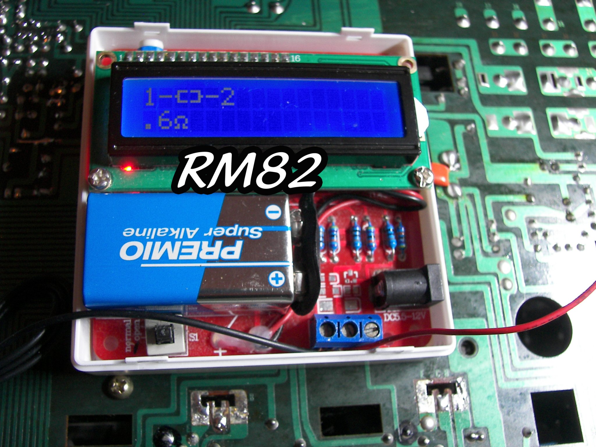

Please short your component tester probes/crocodile clips; what does screen show?
Resistors are nominal 0.33 ohm but screen shows 0.6V so I suspect it is also showing wire/connector residual resistance, I want to know that residual value which must be substracted from displayed/screen value.

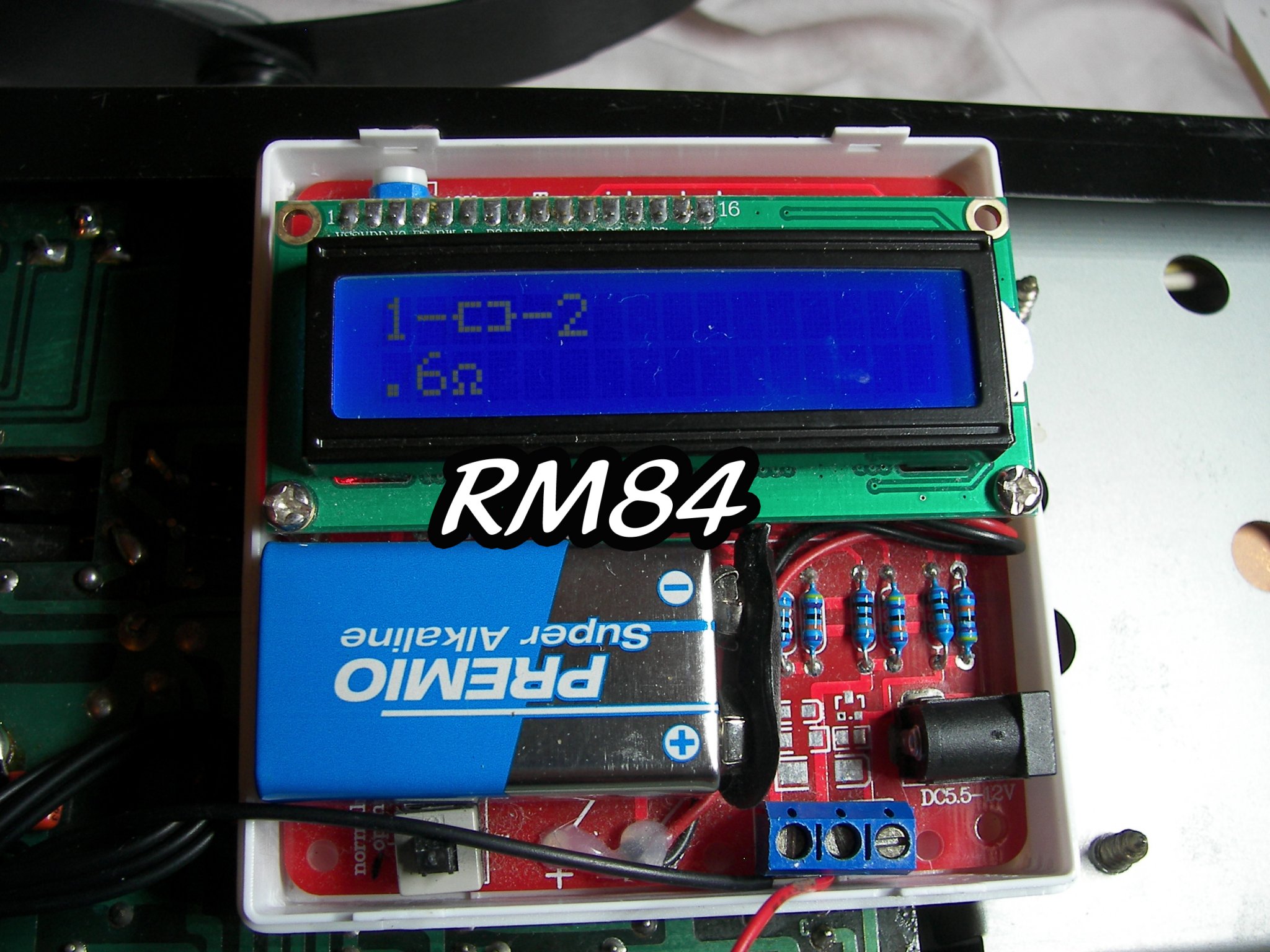

the PrT shows 3 resistors as 0.6 ohm, but one as 0.3 ohm WHY?
Service manual.

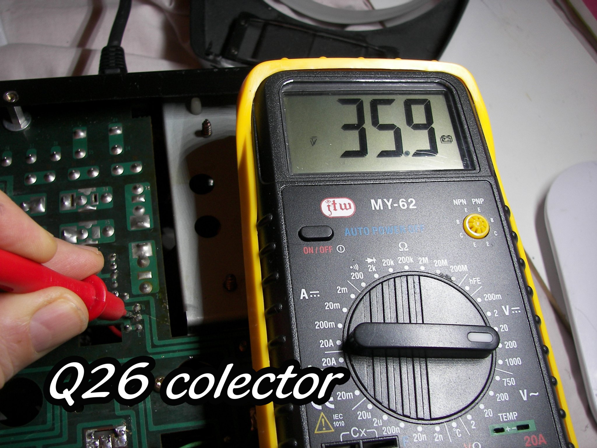

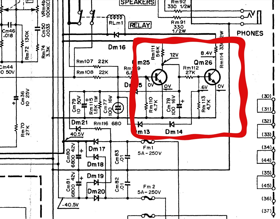

Too much DC voltage on collector Q26 = 35,9V.
1) please call them like in the schematic, Qm and not plain Q , it is confusing.
2) please measure the +V rail, I suspect it´s around +35.9V
So +35.9V at Qm26 is the +V vrail.
No voltage drop across RLm1 coil because Q26 is not passing current. WHY?

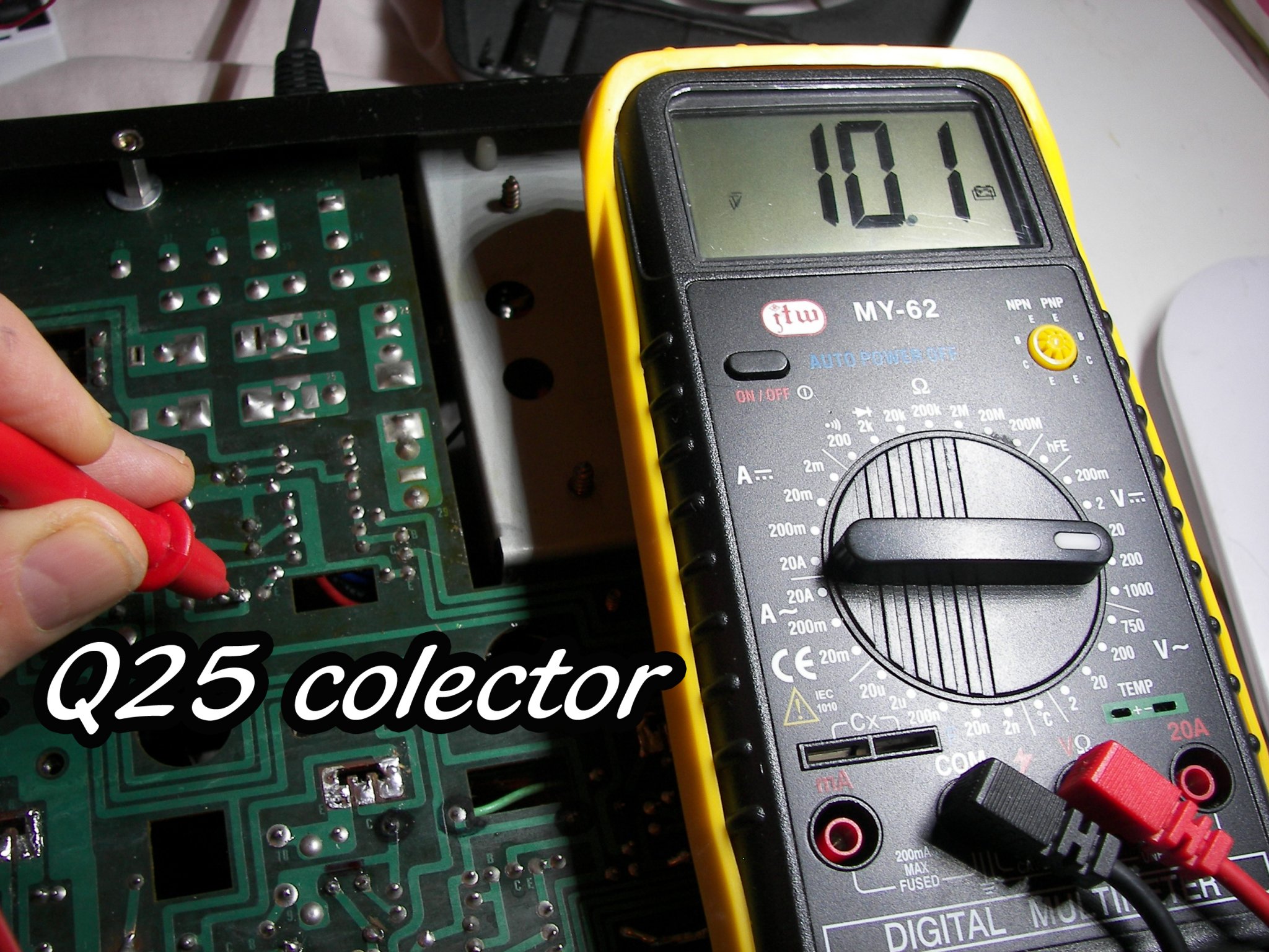

Q25 DC colector = 10,1V.
Don't worry over those. They are incorrect because of the high DC offset.
This measures of DC are with all output NEC removed, with Dm5 and DmM6 shorted.

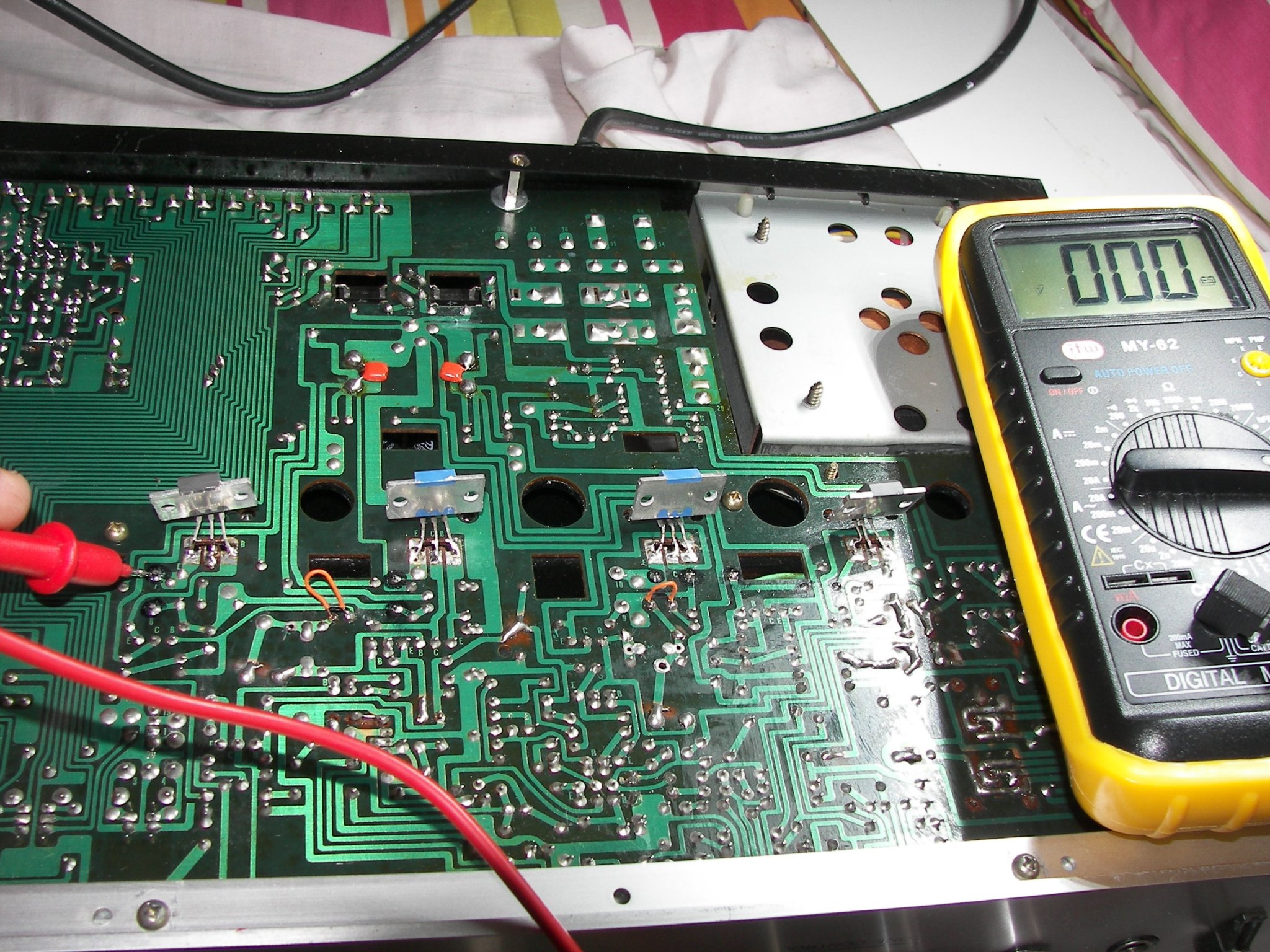

Go back to the first tests we did. The voltage on the 0.33 ohm resistors was zero and the resistors seem OK :checked:
You then fit the output transistors and the offset voltage is a very high negative value on one channel. This suggests the PNP output transistor is conducting and pulling the output negative. That would happen if was leaky or if there was enough voltage across the 330 that goes between base and the main output line. Excess voltage across the 330 ohm is unlikely given that the DC offset is zero with the output pair removed. You should still check it though.
If you are not sure then make a note which is the 'good' channel, then remove the output transistors again and confirm the DC offset really is zero on both channels. Get it back to that state. Keep the output transistors from the 'good' channel separate so you know which they are.
Now check the voltage across the 330 ohm resistors. Should be almost zero. If it is then I think one of the output transistors is faulty (the PNP one).
Now fit the output transistors from the good channel to the bad one. That channel should now work with no offset.

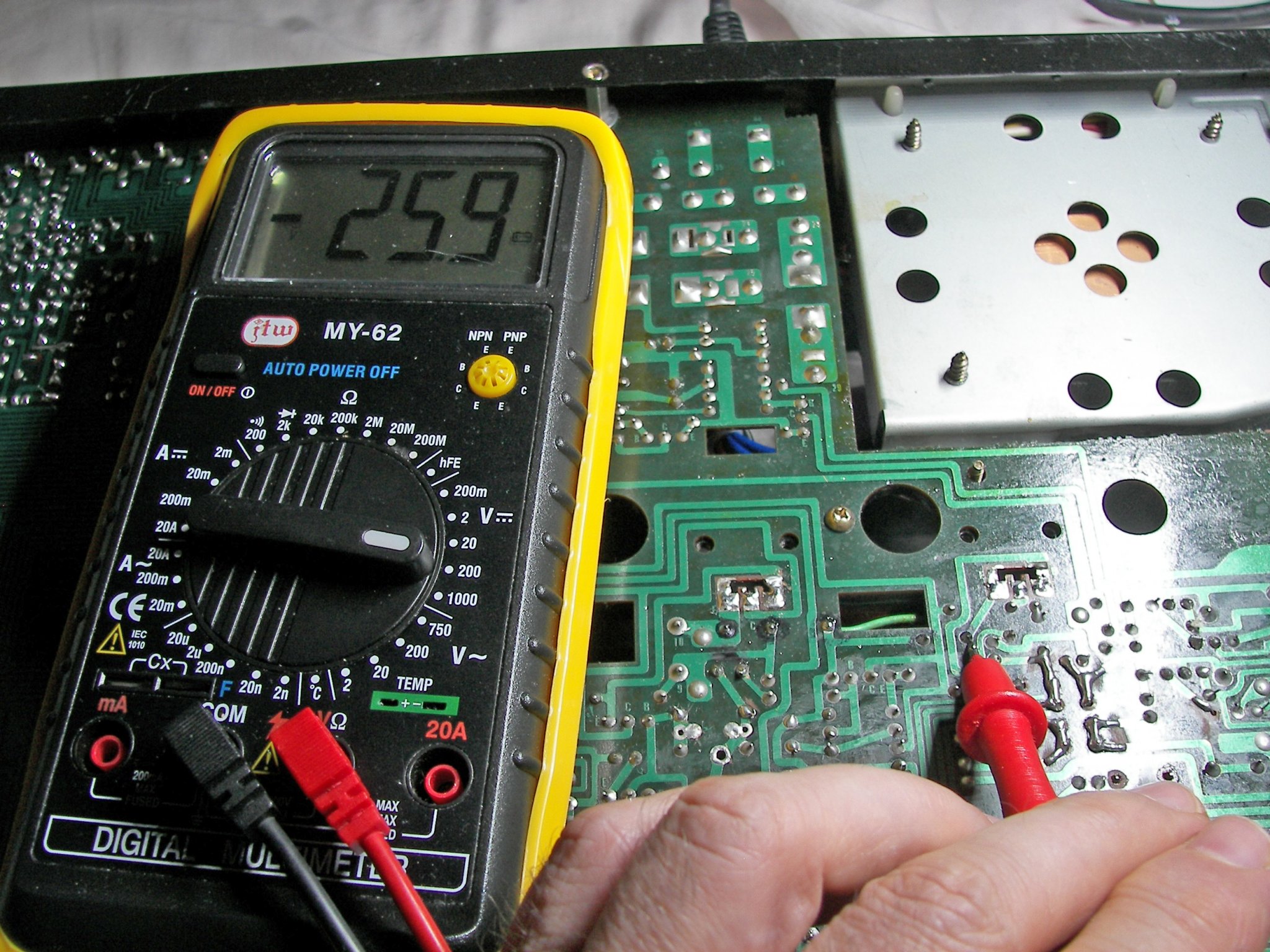

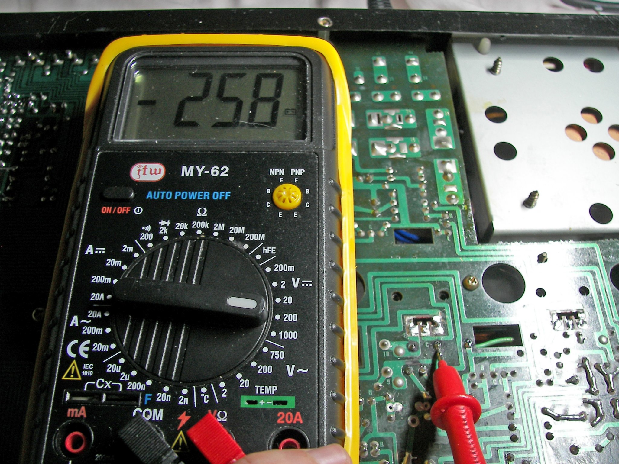

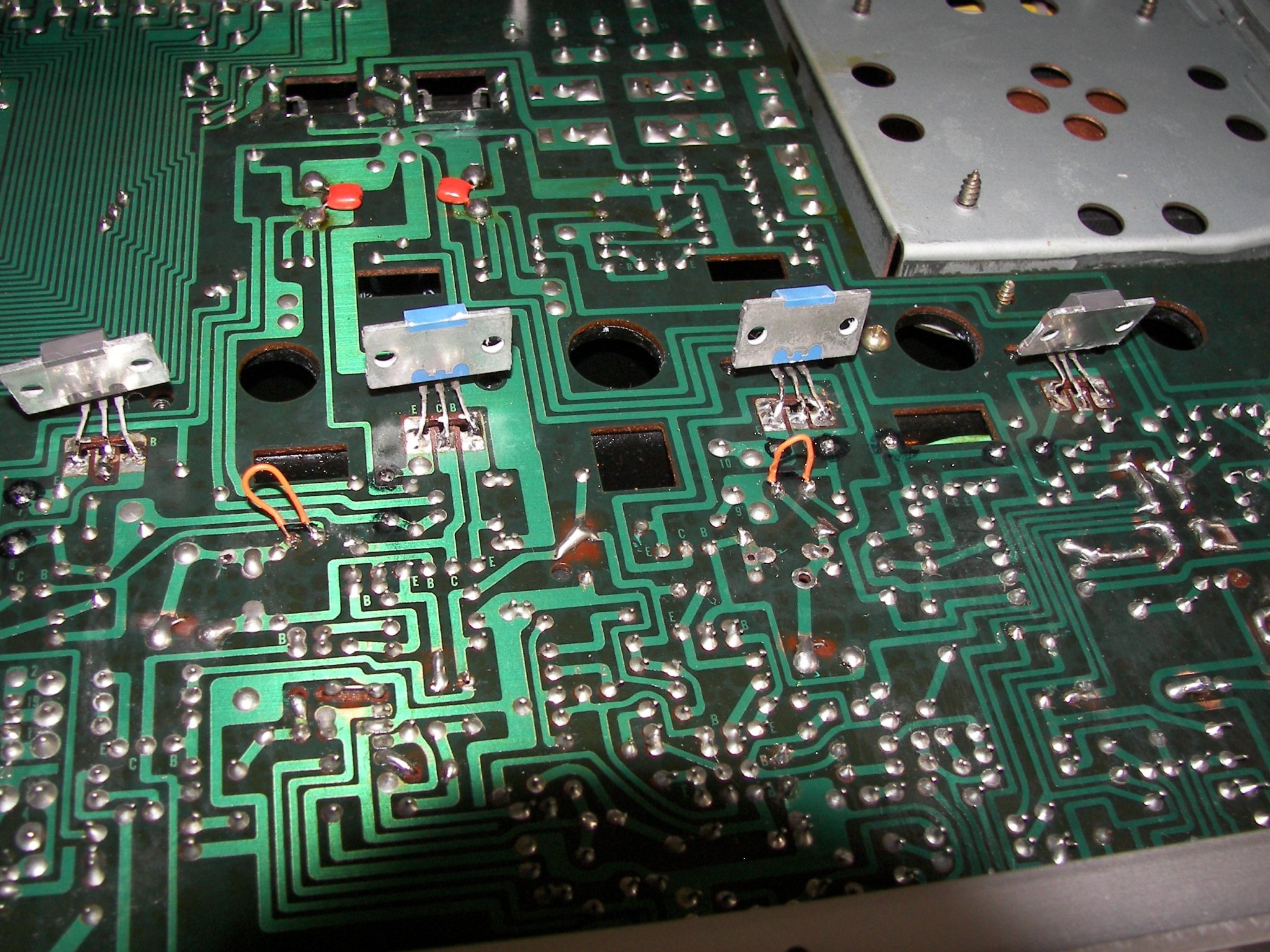

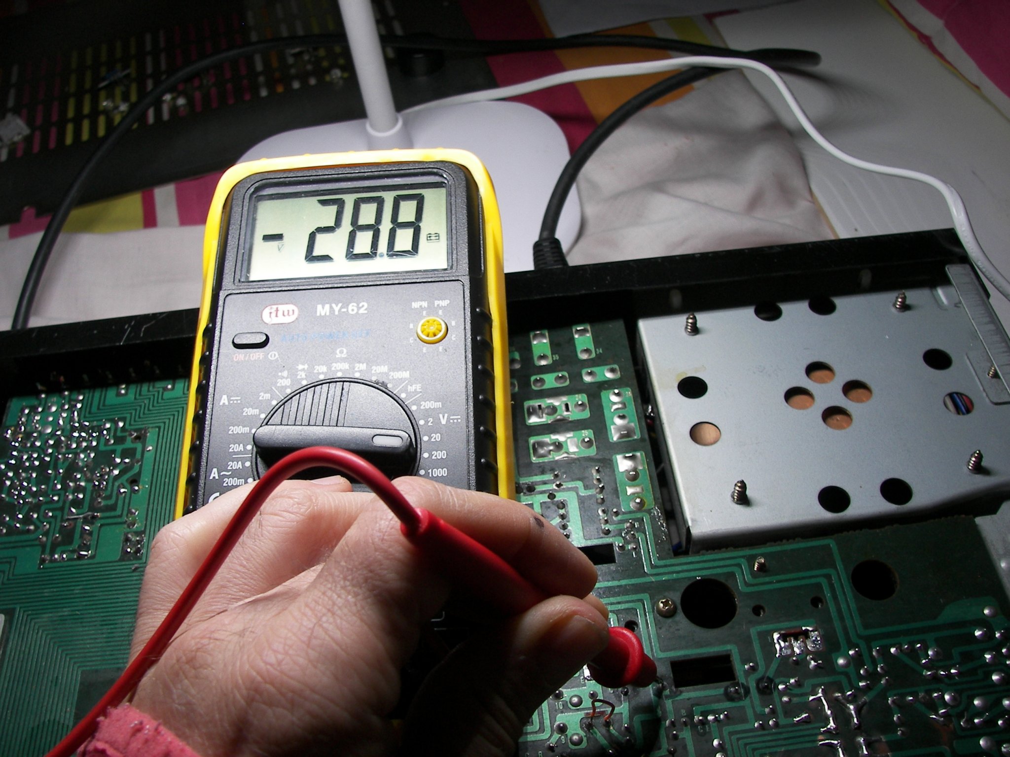

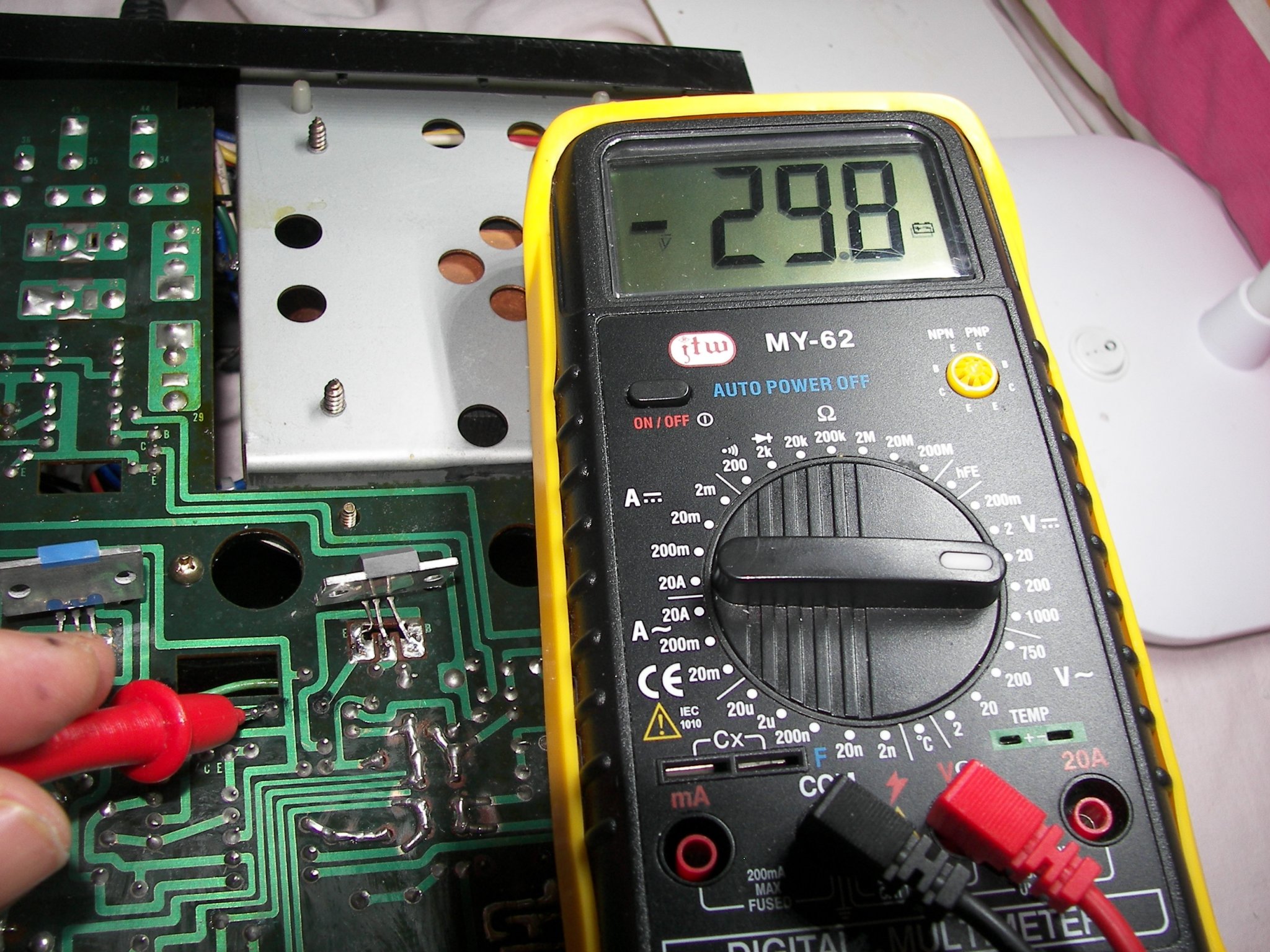

All 4x0,33 resistors are OK. New measure. Dm5 and DmM6 shorted and all outupt transistor mounted. One channel ok (near 0V on collectors) but the other channel with –DC voltaje on both collectors. All transistor are cold, an relais still dead.

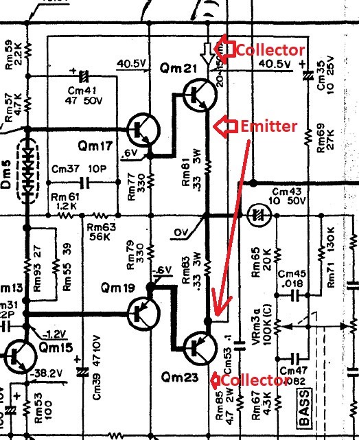

The collectors go to the supply rails and these should always have supply voltage on them. Do you mean the emitters? The emitters are the leads that go to the 0.33 ohm resistors. They should have zero volts on them.
Listen 🙂 you must be logical in this.
We have proved you have no DC offset when the output transistors are removed. Yes? We did that test and you showed zero volts on the 0.33 ohm resistors.
When you refit the transistors it is back to a high negative DC offset. Yes? That is what we tested next.
Conclusion, the most obvious suspect is the PNP output transistor. Forget what that component tester says, prove the theory by substituting that transistor.
The relay protection is working if the relay does not close with a high negative offset present. It is doing what it should.

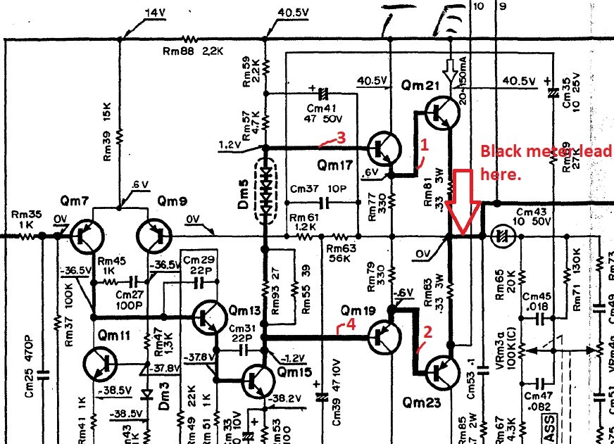

Leaving the transistors out of circuit can you place the black meter lead on the junction of the 0.33 ohm resistors and then measure the voltage at these points I have labelled 1, 2, 3 and 4.
Record the results and post them here.
