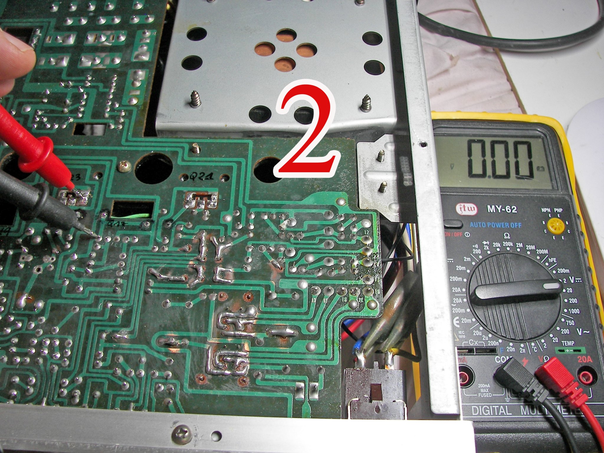

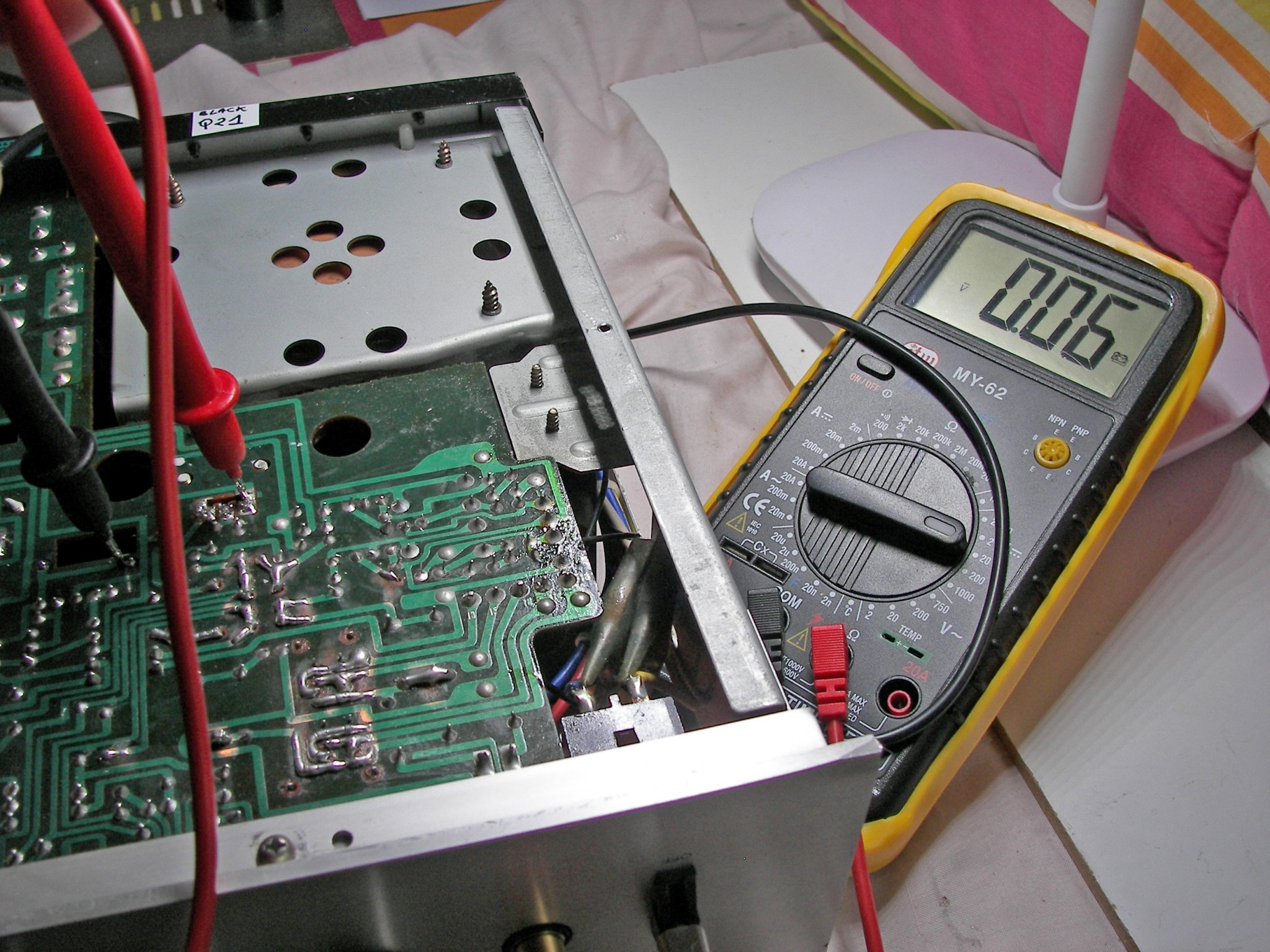

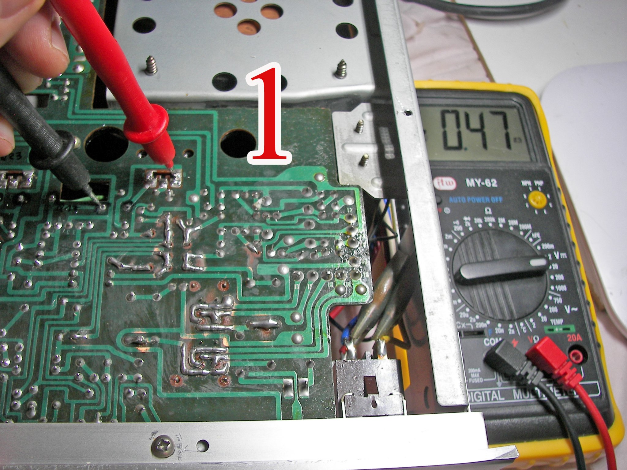

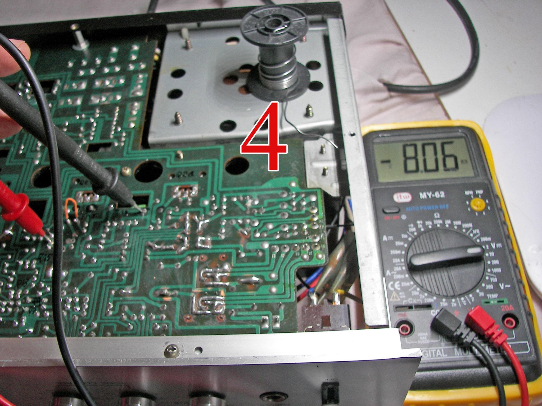

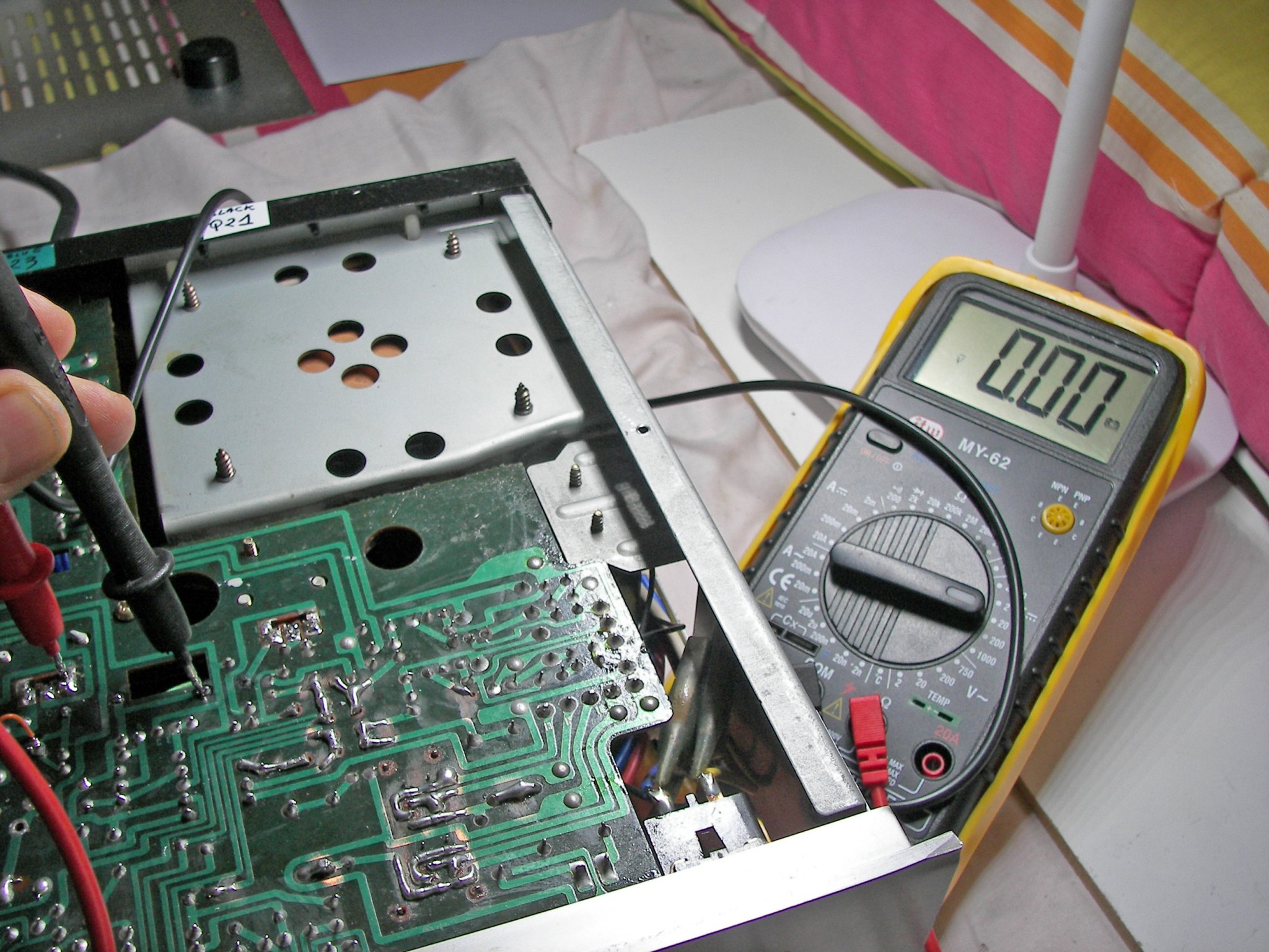

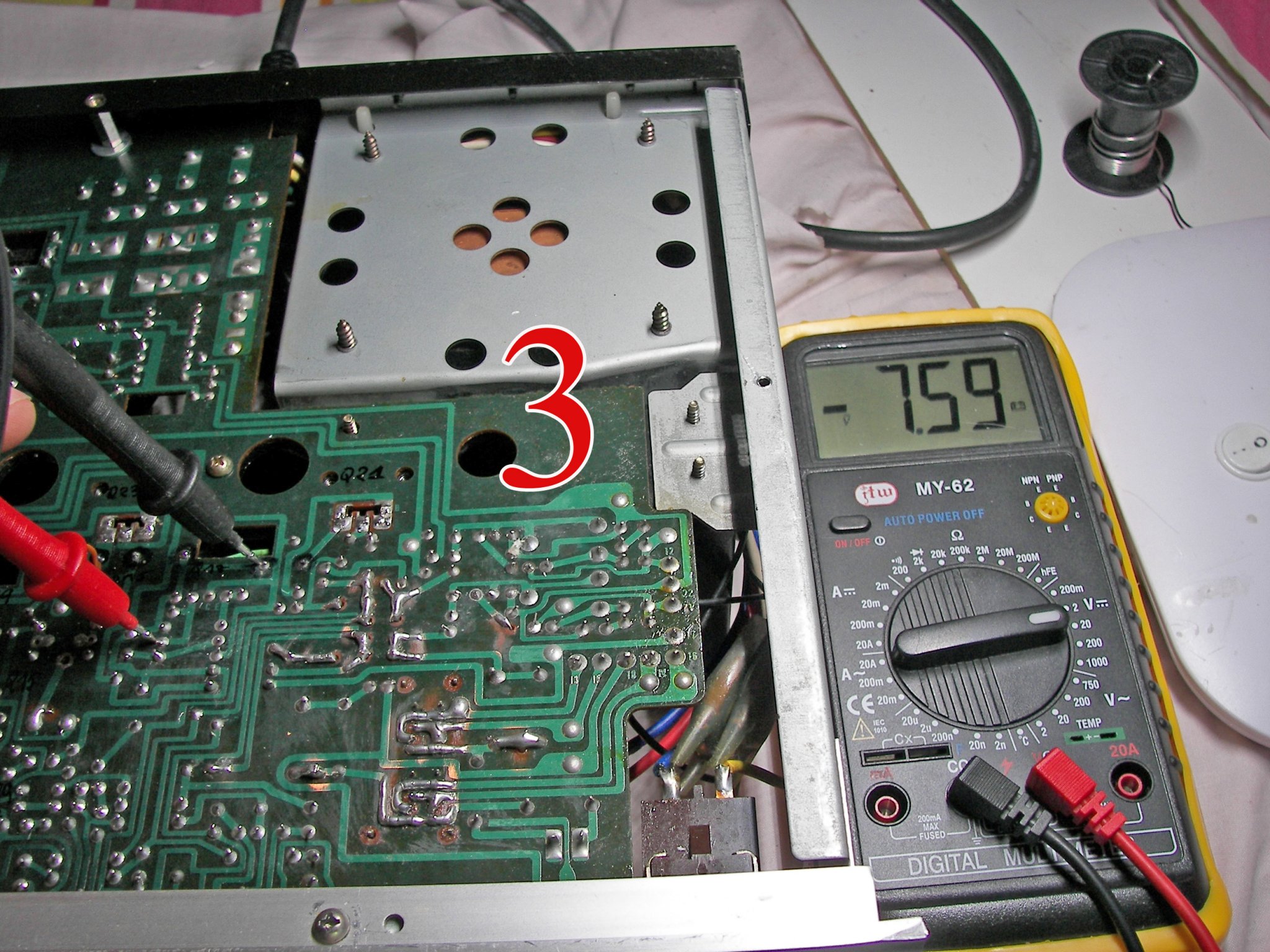

MY KA-5700 has burned out
1,2,3,4.

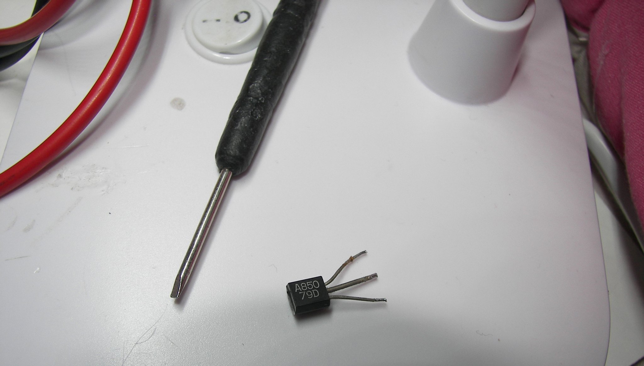

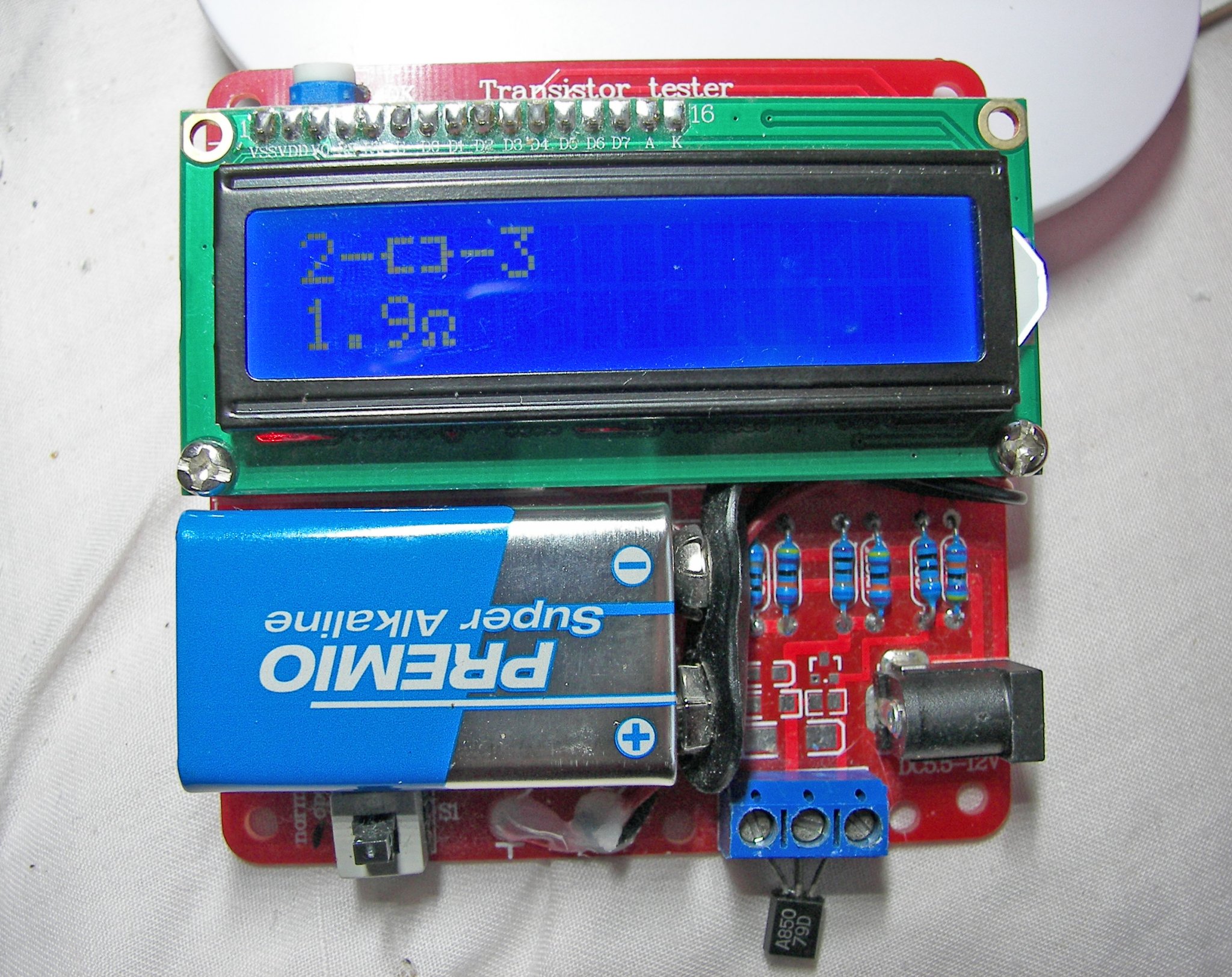

First standout from those is that Qm19 must be open circuit. You have -11v across the B-E junction with the emitter the most positive. That shows the B-E junction is open.

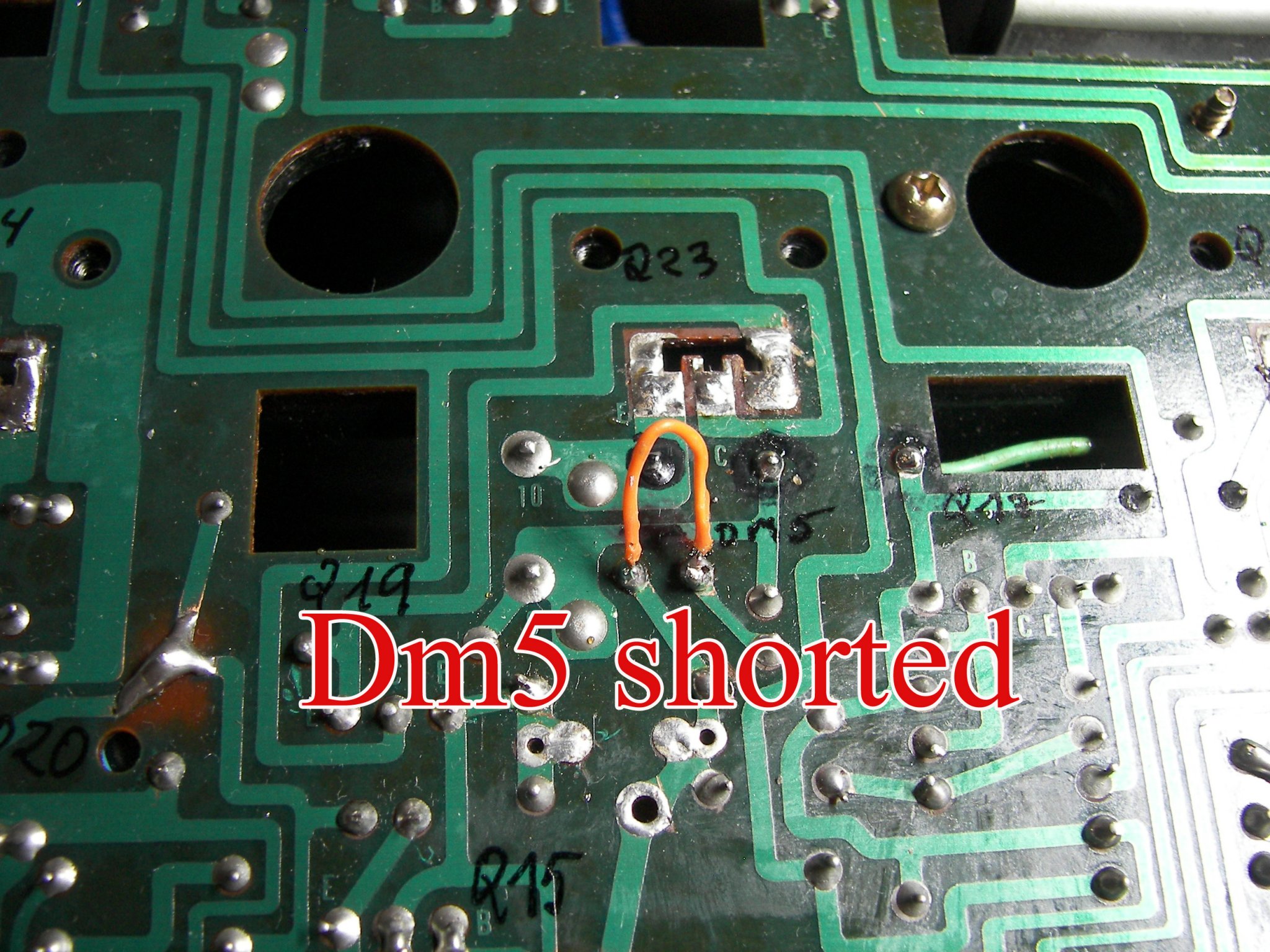

Also 3 and 4 should be very similar (whatever they might be) if Dm5 is linked out. Look at the circuit, You have Rm93 and Rm55 in parallel which is like a single 16 ohm resistor.
So points 3 and 4 should be almost the voltage. Or perhaps you have not got Dm5 linked out 🙂
Qm19 is definitely open circuit with -11v across the B-E junction.

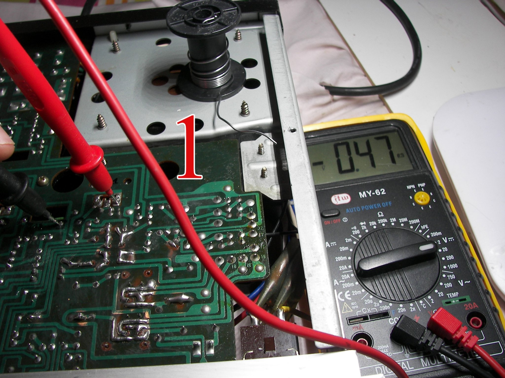

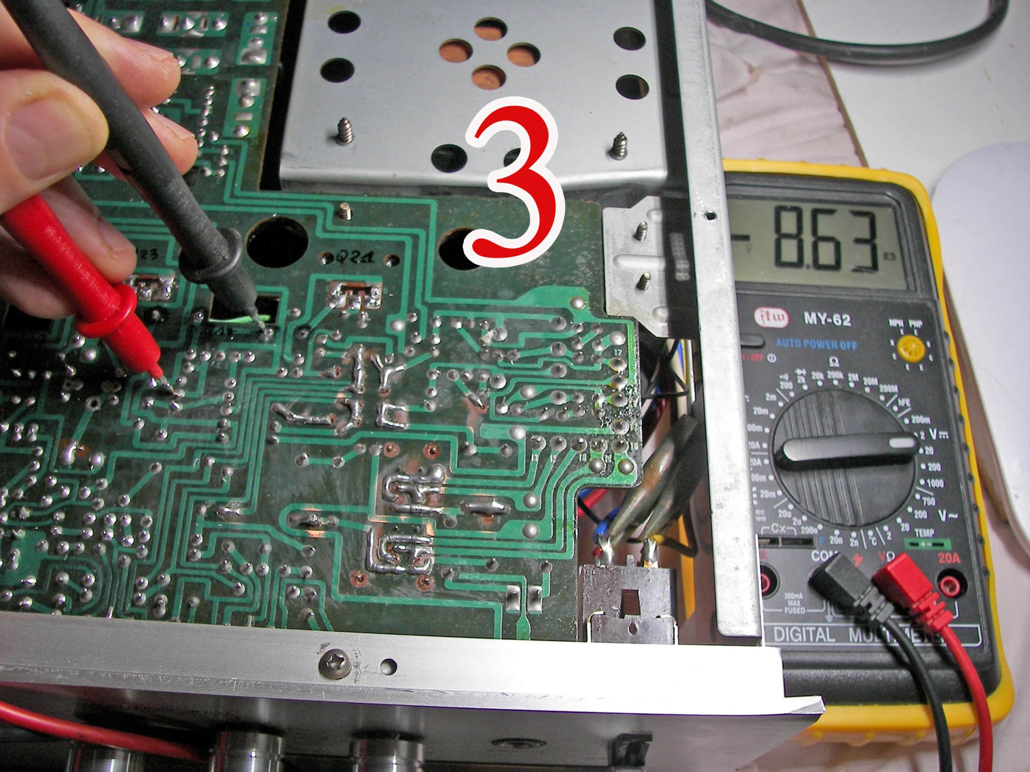

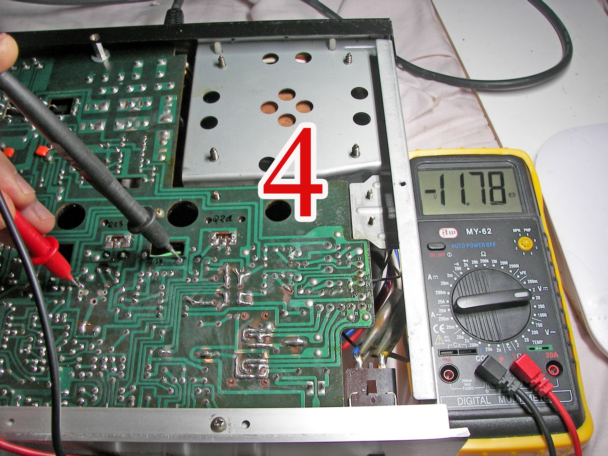

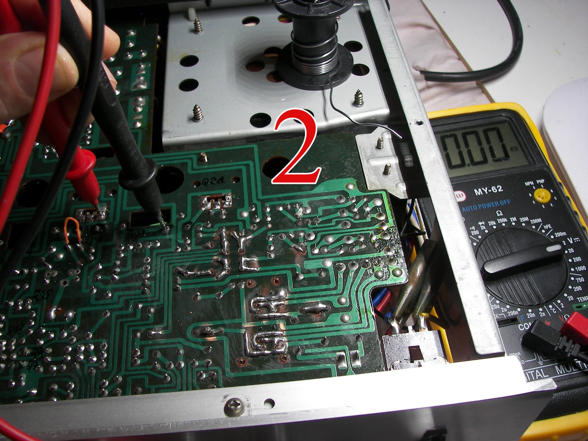

With Dm5 linked out (shorted).

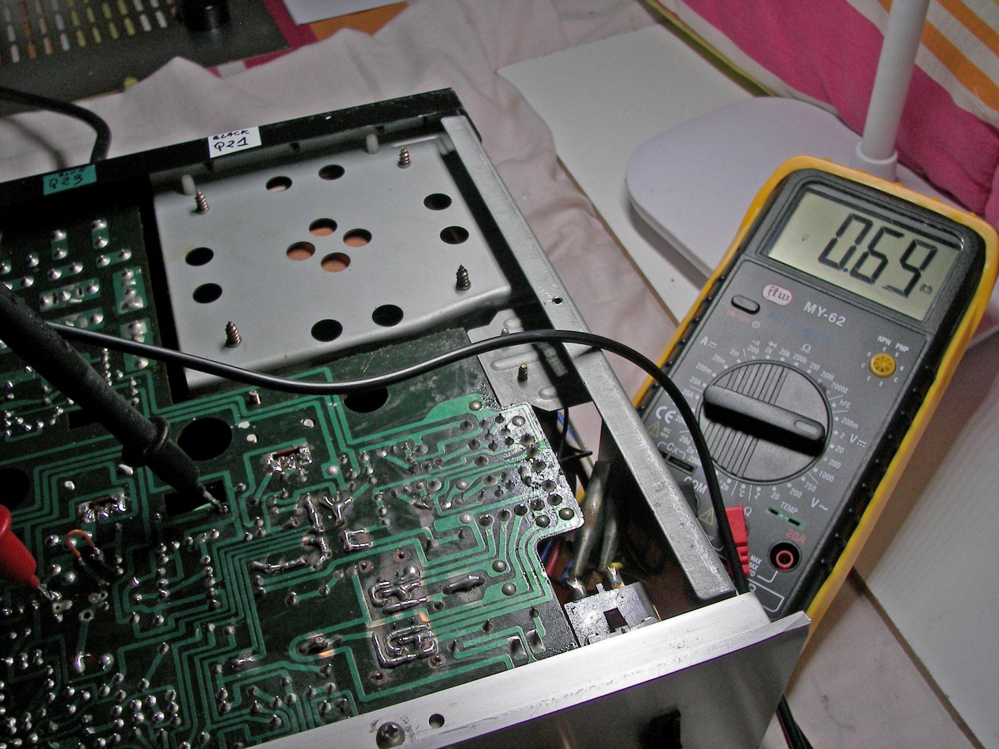

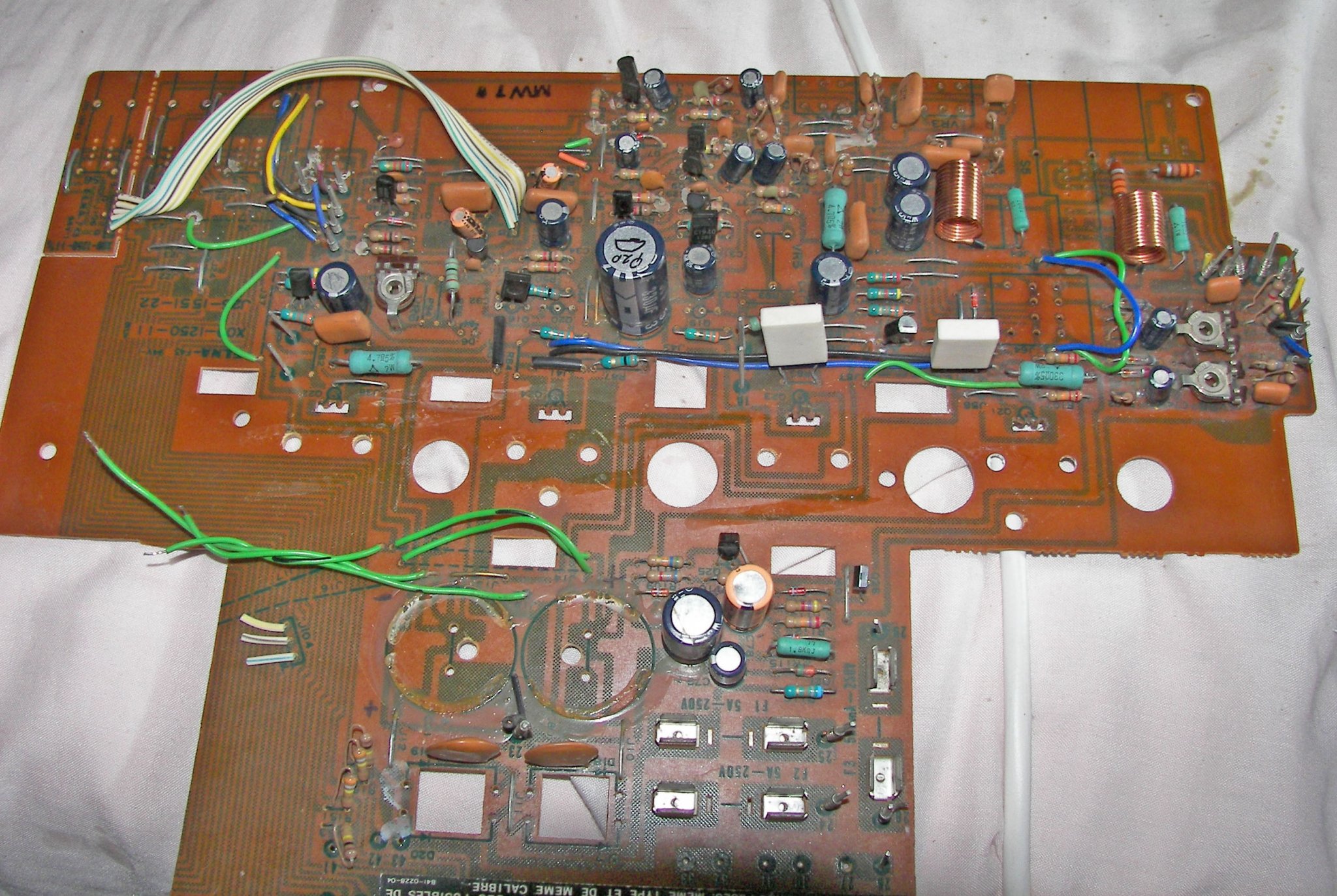

So its looking good so far 🙂

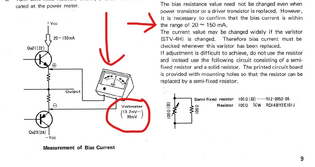

When you refit the output transistors and test it again you must keep the bulb tester in place. Make sure the amp is OK keeping the diode pack shorted.
If all seems OK then remove the short on one channel at a time and test again this time checking that bias current is correct.

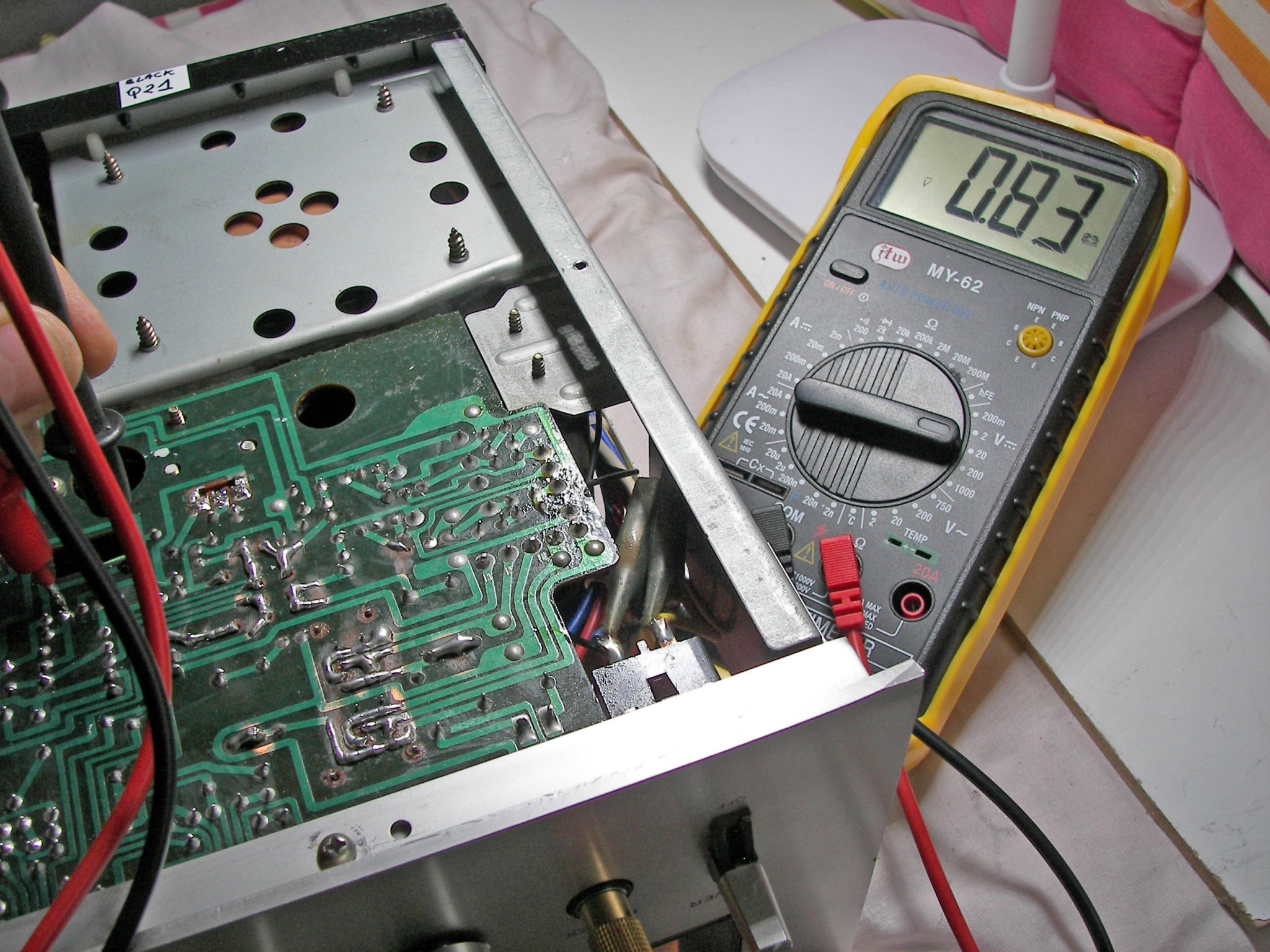

Last measurements with output transistors on board and diode pack shorted:
1): 0,06 V
2): 0,00 V
3): 0,83 V
4): 0,65 V
All seems to be OK. I think bias current are the same, customised/adjusted by Sakis ten years ago.
