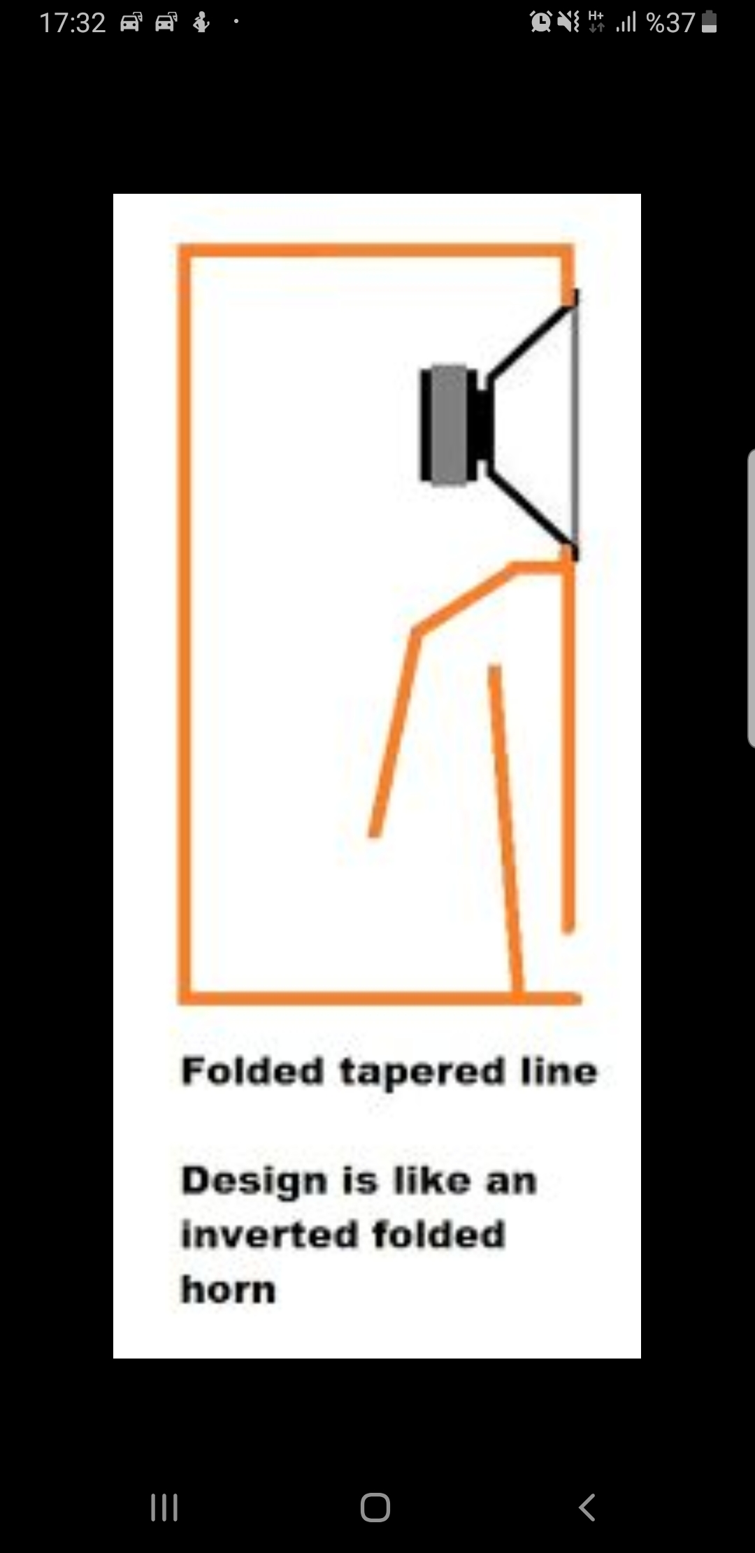

Yes, two works in an inverse tapered TQWT, the opposite layout of the one you posted [vent opening/'terminus' at the narrow end with the driver offset from the closed wide end]. Plenty of this type has been built/documented, but now that I want a picture or drawing of one, Google can't seem to find one. 🙁
GM
Maybe this one ?
Seen alot of tapped Horns around these dimensions for 6inch driver, one with tagband comes to mind. Even google image search will show alot.
it is the same principle near enough.. I am not sure if the bandwidth is shorter with more spl? than a transmission line of the same dimention
it could be the out of band responce for a transmissionline is more user friendly than a tapped horn, however I would be interested in comparability of output v frequancy of the 2 designs

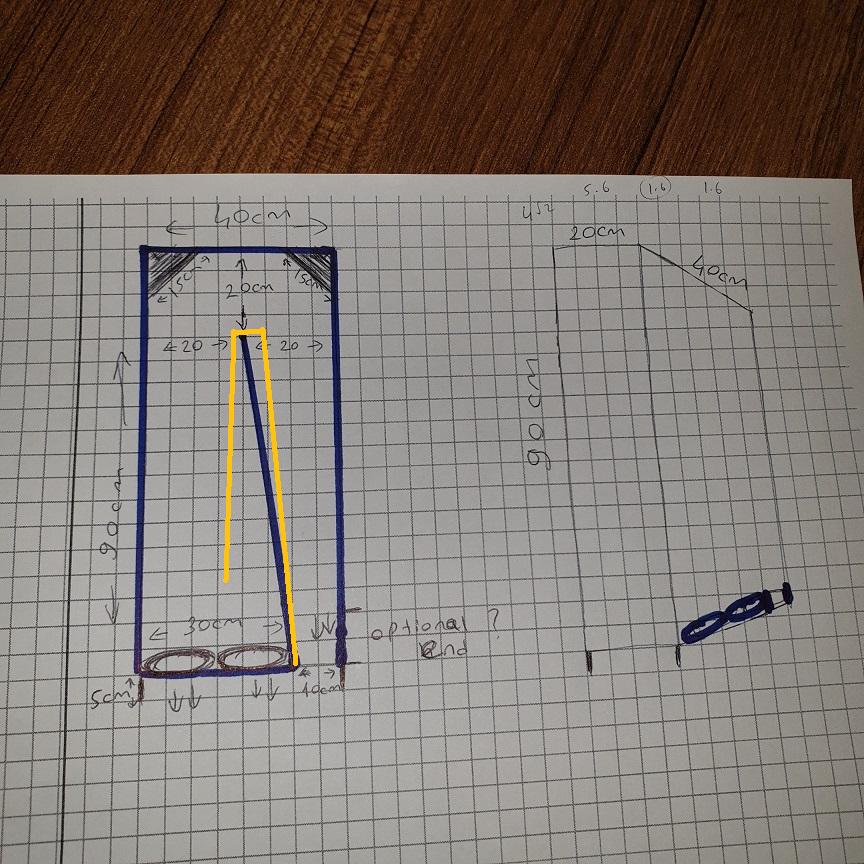

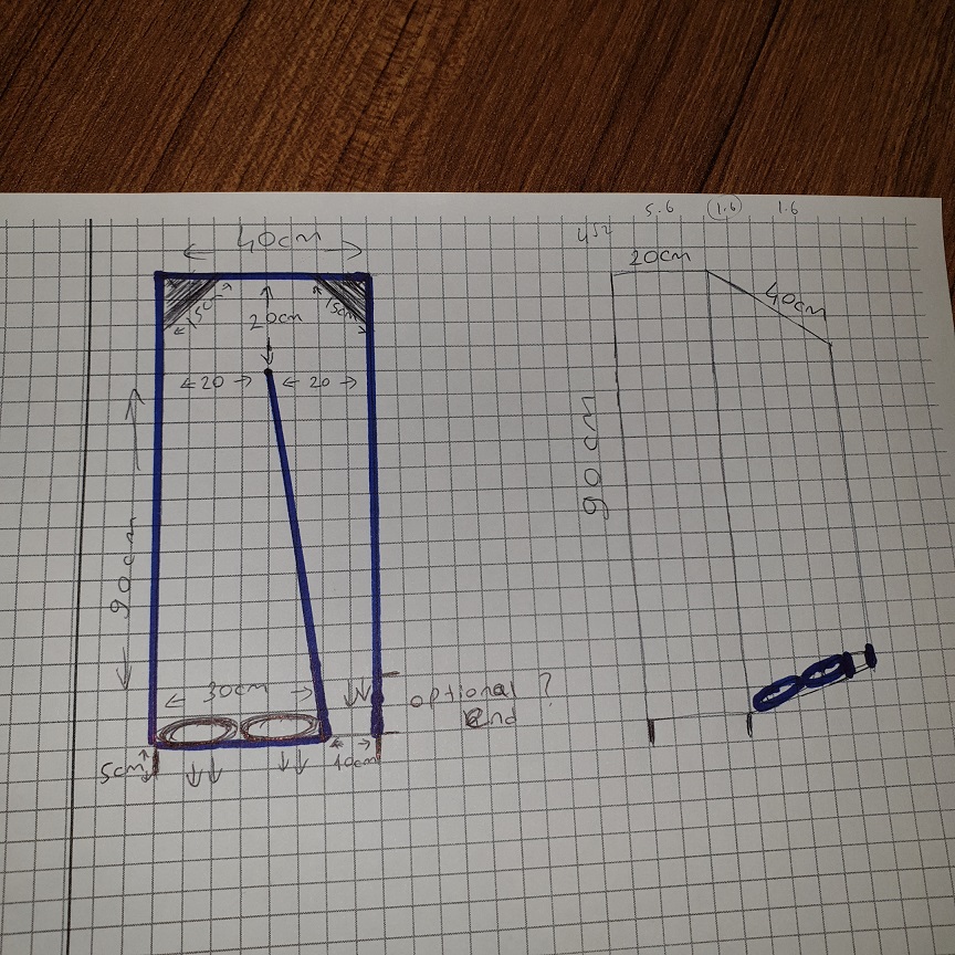

Hi.What about this one?I have just drawn it.
I like it. So long as the box has relevent space to breathe air down there with both those drivers and the vent.
p.s: why is driver offset relevant if it is for a sub? AH I recall, Means offset along the path of the line for better response and less pronounced resoundent peeks and things
means you need to find a design whereby some path length or box volume exists before the mainline of things
:grouphug:
from what I recall, Its basically something like this. or similar.
not what the effect would be having it positioned like that though with the drivers where the fold is. I know it should see it all as one line but looks abit offy. someone else will know better
have you began any simulations?
how about a 10 inch driver instead of 2 6 inch ones?
