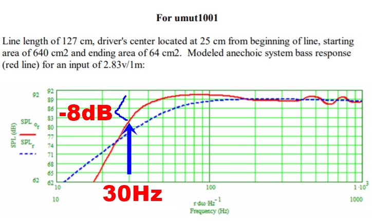

If you're talking about my modeling of your design, my model pretty much validates what you modeled. Are you now suggesting that you increase the taper ratio beyond the ~4:1 ratio in our modeling by using a 45-degree angle? If so, that would increase the taper ratio, which would make the line's effective length larger and lower its 1/4-wavelength resonant frequency, essentially no longer optimally tuned. With a larger taper ratio, then, the line's length would have to be decreased in order to restore its 1/4-wave resonance appropriately. Maybe I don't grasp what you're suggesting now?

Hi.Do you think it is the best ratio for these drivers ?I made some simulations but i could not decide.Wife does not accept doing trial anymore. I should build final speakers it asap.With rapid glue and spray and and 45degree angle cut.It also makes box cheaper.White coloured mdf also does not need painting by this way
Hi.45degree angle is just about construction of the box.Make box stiffer.Not about inside volume or ratio or acoustics.
We did it 520/120 surface ratio.For my TS parameters can you suggest a better box? Maybe deeper bass? What about if i make 640/64 ?
what ratio you make if you have these drivers?
I'm sorry but I still don't understand what you mean by the 45-degree angle. Regarding the line's taper ratio, changing it will not give deeper bass. In conjunction with the driver's T/S values, primarily fs and Qts, there will be one and only one optimum tuning frequency that provides an overall acceptable bass response shape. Once you've determined what that is, the bass reach, f3 for instance, will be determined by how much volume is in the line, more volume, lower f3, but you then have to keep an eye on the driver's excursion. The primary benefit of a larger taper ratio is that is also helps make the overall response smoother, but it also requires the line to be shorter as well as keeping your eye on the air velocity in the terminus. A 640/64 ratio might be fine as long as the (shorter) line's length in conjunction with that ratio creates the optimum tuning frequency.

Thanks, phivates, that makes sense. Now for umut1001, I modeled a line with a taper of 640 cm2/64 cm2 which required the line to be 127 cm long in order to achieve the same tuning frequency as with your original line. The driver's center is located 25 cm from the beginning of the line, and the first 86 cm of the line's length are filled with polyester fiber at a uniform density of 0.75 lb/ft3, requiring a total of 15-16 ounces (~500 grams) of fiber. I've attached the modeled anechoic system bass response.

Oh i did not know the line should be shorter when area is bigger.I thought the longer line the deeper bass.
My tower speaker should be 20cm wide and 80cm tall and max 40cm deep.I think 640cm2 s1 is also not possible when i double check.
Maybe we can make another simulation.Or i will go with 520/120cm2 inside area.

You cannot get Martin King's software anymore but it does allow better modeling of TLs than Hornresp I think(?). The actual line's length and its taper ratio create a longer effective length and its 1/4-wave resonant frequency, while the line's volume creates its bass reach. For the same 1/4-wave resonant frequency a tapered line will always be shorter than a non-tapered line. Your 160-cm long line with the 520/120 taper ratio will be just as good as a shorter 640/64 tapered line having the same volume, with the only real difference being in the smoothness of the response above several-hundred Hz, and since your design is intended to be a "subwoofer", those higher-frequency ripples aren't important.

Ehem, sorry to intrude here, but it was supposed to be a subwoofer. This is the modeleled response from pkitt, with some remarks that I made. Notice the steep roll-off below Fs - impossible to eq up! Most two-way main speakers are also BR-tuned around 40-45Hz, so what is the benefit from this TL woofer?

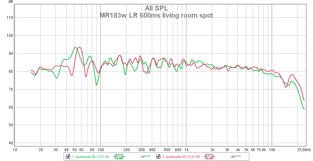

In-room response here
