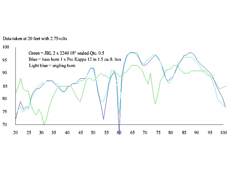

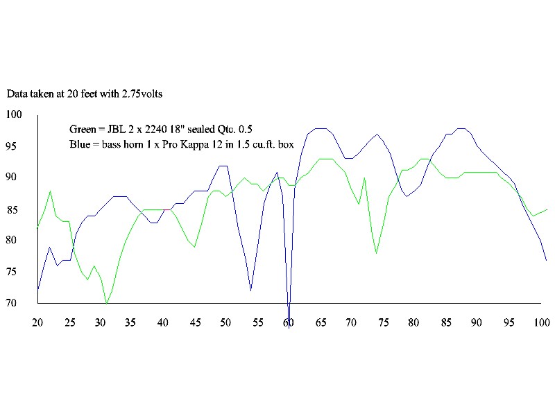

Here's the SPL graph:
No EQ. 🙂
Win ISD shows the Kappa having an 81ohm impedance peak at 66hz. I wonder if this is causing the drastic drop in SPL at the 55-65 hz area? Another thought: the horn is directly facing the rear wall. Might be cancellation. I'll angle the horn into the room a smidge...

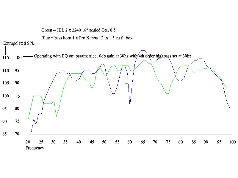

With EQ on
These are my original "blind as a bat" EQ settings. For some reason, the EQ took off like a rocket. For the better I might add. Perhaps the electronics hadn't engaged until now. That horn's performance curve is pretty impressive (except for that dam_ room node).

thoughts...
I think I'm going to redesign the last flair in my horn to reposition the goose-neck, thus allowing it to roll over the front rather than the back of the horn. This will stage the final flair squarely into the corner of the room. At the moment, the horn's mouth rests against one wall. The goose-neck gets in the way and won't allow placement against both walls.
My reason for this is to remove the twin null points. The JBLs in the other corner don't have this problem. The cabinet sets into the corner with its backside touching both walls.

Hi John,
They're pretty nice plots for in room. Have you tried measuring right at the horn mouth ? Should take the room out of the plot enough to see whether its the horn causing the big dips or the room. Maybe try the big jbl back on it too ? It seemed to need less boost at the bottom on the link you posted.
Rob.
great idea Rob,
I'm just getting back into this stuff and hadn't thought about measuring directly at the horn's mouth. It certainly could point out any anomalies in the horn's design.
I'm not crazy about the JBL in this horn because it's throat to cone area ratio is about 4 to 1. This leaves the music sounding a little to tight, unable to breath. I like my bass more relaxed. I must admit, the JBL does drums like there's no tomorrow!! When I build the second channel bass horn (I can't believe I'm even thinking of fabricating another), I'll design a larger throat and back chamber area to let this baby breath.
I don't know what got into my EQ. I took a set of measurements and then did the same with the 2240s in the other corner. Just for kicks, I took a second reading on the horn and noticed a 10db increase in the SPL. Good grief, I had to run the numbers from beginning to end. That's about 79 measurements. It certainly made for a good looking graph, didn't it?
