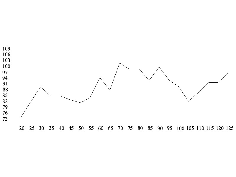

Humm... I added db at the prescribed frequencies.
There's a stronger line at 30hz:
I should have mentioned that the data in the above graph was taken at 18 feet with 1 watt imput into the horn.

Well, I broke down a ordered a microphone for my DEQ2496. Does anyone know how accurate Behringer products are? At any rate, the RTA will be on line soon. It's been years since I've tested the horn. It'll be interesting to see what's going on.
When the microphone arrives, I'll attempt to EQ the horn flat to 30hz. Seems to me the distortion sounded intolerable at 30, but we'll see.

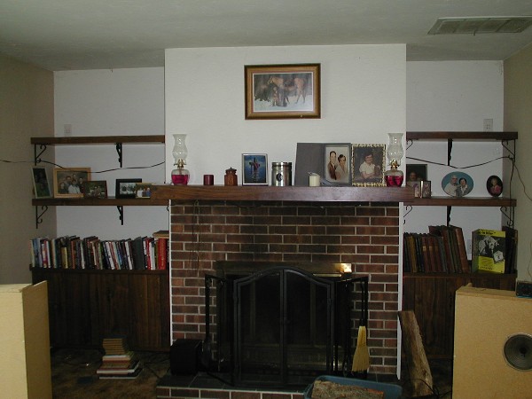

I have attached a picture of the front wall of my listening space. By removing the cabinets and shelves I have room for a 2.75'x8'(x2' deep) horn on each side with a 14" sliver beside the left one (that recess is larger than the one on the right) of 17 ft^3 capacity for the direct radiators. That sliver can hold four 12" titanic subs tuned EBS to 15Hz.
This should give me all the bass output I need even if I decided to get into HT an put an LCD TV on the mantel. The sensible thing to do first I suppose is build the direct radiators since they can cover all the way up to 80Hz by themselves. The horns could be added later and the crossover to the sub-sub woofers adjusted accordingly.

Mashaffer, hi.
Is the picture you posted your home? Are your building a new home? What's behind the walls to the L/R of the mantle?
You've got some brain-work going. I like your enthusiasm.
Keep in mind that horns are more efficient than direct drivers. If you horn load the bass, then the upper frequencies should either be VERY efficient drivers, or else horn loaded. Otherwise, you will be turning down the bass horn's volume control in order to hear the treble. Once you do that, what's the purpose of having a bass horn? Also, if the direct radiators are operating in the same frequency band as the horn, you may have time alignment anomalies. This isn't necessarily horrible sounding, it's just that the reproduction will not be true to the source. You'll get a fatter bass note, which can sound slurred if the rhythm has a rapid tempo.
From a time alignment standpoint, I like the idea of a rear subhorn--as long as the mouth is huge. If you use 1/8 space calcs for the mouth, then the bass wave won't form until it hits the other side of the room. Use 50hz horns in your front mains. These are manageable size-wise.
Keep the dream alive!
John🙂
Yes that is my current listening room. The two stall garage is behind those nooks :devilr: Thus my original idea of a straight horn in the garage. Alas I think we have determined that the mouth area available is not enough.
I am not building a new home... yet. The OBs you see in the picture are the main speakers that I am using now. Recycled 8" drivers from an old Philco SS console with RS dome tweeters connected via 4uF caps. It gets pretty uncomfortable in there at 1 watt so they are pretty efficient.

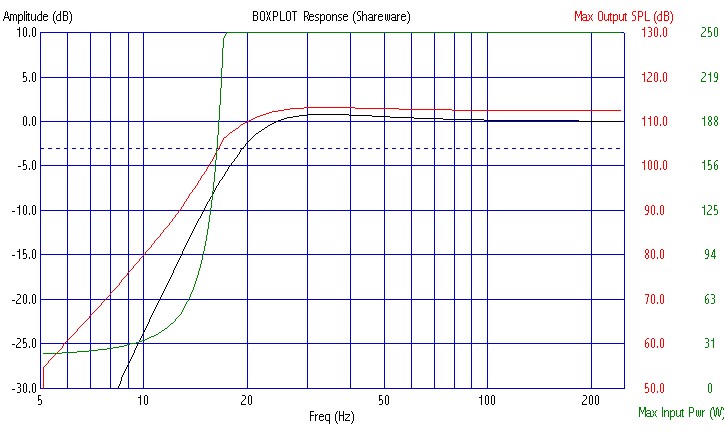

My reason for wanting horn bass is for maximum impact on tympanni and bass drum along with minimum distortion for string bass and similar intruments. I like your suggestion of 50Hz horns as this will pretty well cover those instruments as well as even the best bass voices. Then I can catch the 16-50Hz range with conventional ported sub or bandpass. First step is probably the conventional sub which I could even house in that cabinet on the left side (about 9.5 - 10 ft^3). This new PE sub is very tempting. DCS380-4 15" sub
Even in the slightly smaller than optimum volume of that cabinet on the left (9.7 v.s. ideal of 13 cubic feet) they model very nicely (see attached). Of course if I do Isobarik I could go subsonic in the same enclosure. 😉

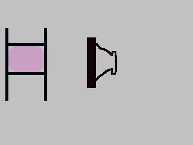

BTW when firing a 15" through the wall (16" centers) is there any reason why I couldn't put horizontal sections of 2x4 between adjacent joists to make a box and mount the speaker to the back of a piece of MDF fixed over the back of that frame like this (pink is the cone viewed from the front). So there would be a box about 3.5" thick between the cone and the grill. It would seem that almost none of the radiating area would be covered by the 2x4s. However would there be any loading or resonance issues with that space? If so could it be flared to prevent problems?
mike

mashaffer,
You can construct a pair of excellent sounding straight horns in those recesses on the L/R of the mantle. With boundary effects, you can certainly get down to 40hz.
The mouth on my horn is only 28" x 56"; you can see on the graph, in my prior post, that it has decent performance down to 55hz. The mouth on your horn would be considerably larger than mine. You may only be parking one car in your garage though! If you can talk the misses into accepting your adventure, then construct at least one horn and give it a listen. If you love the sound, build a mate on the other side. I place my subs behind my listening area. That way they don't work as hard. If you balance out the volume, they blend with the front horns beautifully.

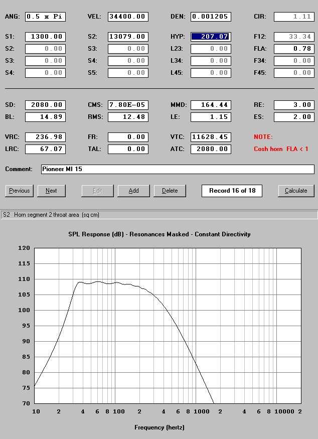

Maybe something like this firing into the corner behind and to the side of my chair. A seven foot long horn and my mains about 5-6 feet in front should be pretty decent WRT delay right? Drivers used was a pair of pioneer 15" MI speakers as being representative of type.
How about vertical horn firing down into the floor? Would that ruin the transient repsonse?
Mouth is about 13-14 sq feet if I did the artithmatic right.
mike
Firing to the floor would mean no corner loading, hence now quarter space loading. It would have twice the mouth size for the same result, and be much bigger to get any improvement. I would say always aim for corner loading, unless the mouth is the size of one of the walls, in which case you are effectively sitting in the horn's mouth and then you have better than eigth pi space since the expansion is more constrained.
