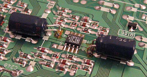

1st mod: new opamp - I replaced the crappy one with an Analog Devices AD8620... very worthwhile! I also added 1uF Panasonic HF supply decoupling caps (no HFQs on hand...).
... so I ordered the service manual for the NS500V from Sony, and it arrived on the weekend. Superb! Full schematics, block diagrams, PCB layout guides, and assembly/disassembly procedures... index of part numbers and replacement stock numbers etc... everything you need to know 🙂
I've now rigged up the audio section so that the mute transistors can be removed entirely and there will be no clicks and pops during power-up/down...
The trick was to supply the audio section from the EVER-11V signal, which means that the audio opamps and DACs will always be powered, even during soft power-down. Thus, you can turn the unit on and off with the remote control, and when it goes into standby, there will be no voltage spikes on the outputs. Of course, this doesn't totally eliminate the problem, as there will still be transients during hard power switching with the mains plug or main power switch.
Also, I completed the other modifications, including mute transistor removal and opamp decoupling. Here's the details:

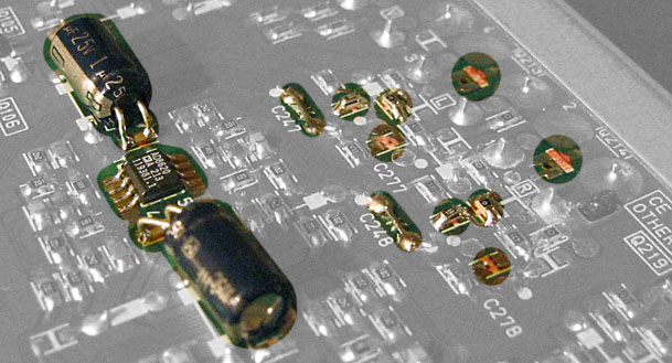

other mods to the analog output stage were:
- short out C247 and C248 (47uF electrolytics) output coupling caps with a small piece of trimmed component lead
- bypass R288 and R289 (470ohm each) series output resistors by stacking a 10ohm resistor on top.
- remove muting transistors Q213 and Q214
- remove C280 and C281 (220pF) caps to ground
- bypass R323 and R325 (470ohm) series output resistors with 0ohm resistor stacked on top
The stereo outputs now have nothing but just under 10ohms between the opamp output and the panel jack. In combination with the AD8620 and the power supply decoupling, the difference is astounding! There is a tremendous amount more detail and transparency, and the weak bass has been totally revived to a strong, punchy, clean and tight sound. I'm very very happy with the sound of these mods. The Rotel is now officially relegated to backup duty!
I also considered removing R324 and R326 to disconnect the 2nd set of stereo output jacks, but though it unnecessary in the end. If I encounter stability problems with the low output impedance of 10ohms, I can switch to the second set of jacks and have 480ohms series resistance in there... However, with the analog stages configured this way, I don't think it's wise to hook up more than one output at a time, so it may be better to disable the second set to prevent this hookup by someone else.
Here's a pic with all the changed elements highlighted:

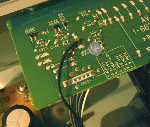

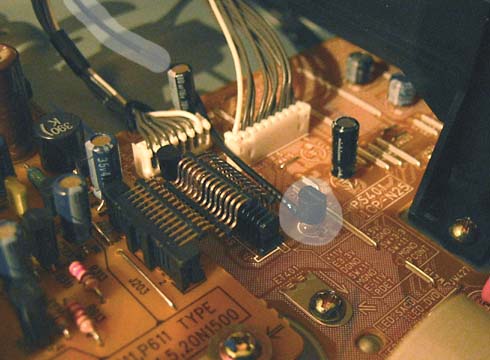

OK, now here's how I got around the lack of output mute:
To accomplish this, I wanted the opamps powered at all times so that there aren't any power up/down transients. Q201 controls the switching of the power to the audio stages (DAC power included), and it is enabled when SW-11V power supply line coming in from the IF-84 board is turned on. This activates Q206, which turns on the +11V supply to the audio section. As long as the negative supply is present, the positive side will turn on too. So, I removed Q201, and fed -11V in directly from the power supply, before it gets switched at the control board. It's the same line, just tapped before the control board switch.
The attached photo shows the AV board with Q201 removed, and the wire added to bring in EVER-11V from the IF-84 board.
Finally, I poured over any related schematics to make sure I wouldn't mess up any other part of the circuit, or interfere with the operation of the player in any way, and I'm confident that it wont, especially after testing it out with all sorts of discs containing different audio formats... dts, SACD, CDDA, DVD video with Dolby Digital sound, etc... it all works just fine. The only parts of the player affected by the power supply mod are the opamps and the DAC chips, which are all now continuously powered as long as the main power switch is on.
I was worried initially that the DACs wouldn't get properly initialized without a power cycle, but there is a separate reset line for the DACs, and the DACs need to be reset after power-up anyway, so the player must reset the DACs anyway every time it thinks they're being powered up again.
Mission accomplished! No pops or clicks when the unit is switched to or from standby mode. 🙂

Yeah, 10 ohms is a bit low, I'd normally go with something like 30 or 47 for something like this, but I'm driving very short cables to the preamp so capacitance is minimal...
I did verify it on the scope, and the output was quite clean - no spurious oscillations and whatnot. I also tried a couple of small caps across the outputs to test stability, and it seemed just fine. In retrospect, I should really do a more thorough test with some square wave signals to check for ringing. I think I have a test disc around here somewhere...
I have to say that the biggest improvement with the decoupling caps and removal of series output resistance has been the bass. That soft and weak bass is totally gone, replaced with a clean, solid, fast bass that has no hint of bloating. It's much more rhythmic, and much fuller now. Before, I never felt the same involvement with the music that I got with my Rotel, but now that thin persona is mostly gone, and the music sounds much more alive again!
