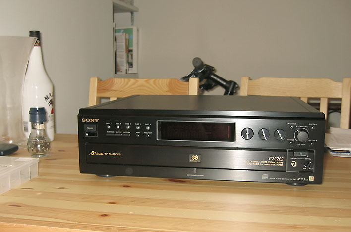

well chad...
you were right, i was wrong. 😱
the output muting transistors were indeed only to prevent spikes on power on/off... so i was able to remove them all. as to be expected there is a turn-on transient now, but it is REALLY nasty - whether turning the unit on "hard" (with power switch) or "soft" (with remote control) you will get an absolutely huge spike at the outputs. soooo... you have to be very, VERY careful to completely mute your preamp before switching this thing on and off now.
the DC offset of the output stage was pretty much near zero even w/o the coupling caps. i'm not sure why i thought it was higher, but a few tenths of a millivolt seemed to be residual from the output muting circuit, which is now gone. i've bypassed the caps with shorting wires and there is zero DC offset.
on a side note, the output impedance of the player is probably around 500 ohms due to the 470 ohm output series resistor, placed after the coupling cap and before the muting circuit. in theory one could easily replace this resistor (a small SMT device) with a better metal film of lower value, say 200 ohms or so.
i took a closer look at the power supply on the output board, and it is some nasty stuff. the analog rails from the main switching supply seem to pass through some sort of pass transistor or regulator, but the device is tiny (3-terminal SMT). the dropout of this device is very small (around .6V) so i'm guessing it's a pass transistor and not a regulator IC. strangely, the negative rail also passes through a diode after the pass transistor, but the positive rail does not so the rails are assymmetric - i measured around +11.1V and -10.6V or something like that. then of course there is hardly any decoupling to speak of, and very very long traces to the multiple opamps. yuck. like i said, i'm not sure it's worthwhile just swapping opamp chips on this thing, it really needs a whole new analog section and power supply altogether. it wouldn't be hard at all to build except you'd need to break out into a bigger chassis. hmm...
in any case, your hunches about the output cap and muting circuit were totally right. i should do better homework before opening my mouth next time. 😛
by the way, the player sounds GREAT with those two components out of the signal path - much more transparent, very clean and pure. at first i thought the sound was a tad thinner and bass-shy, but then i realized it was just rid of the bass bloat it had before probably due to the poor coupling caps. it sounds lovely, makes me wonder how great it could be with a full rebuild. hmmmm...

actually...
the 6-channel DAC is an AKM AK4357. 😛 sony just relabels it with their part number. i think there is also a separate AK4383 2-channel DAC chip for the stereo output but i am not sure.
you can see the (albeit skimpy) datasheets here:
http://www.asahi-kasei.co.jp/akm/usa/product/audio.html
everyone always talks about the Burr-Brown and AD chips, but this AKM part does some very special things. even though its design is very mass-market targetted (digital volume control taps, etc.) it does seem to reveal a remarkable amount of musical detail, despite the overal leanness of the player's sound as you mention. if it were practical, i think using 6 of the chips, each one with all 6 channels paralleled to form a single channel, could sound pretty killer.
let me know if the output stage does not oscillate with no series decoupling resistor. i suspect at the very least you will need 10 ohms but maybe not. you are right, the high value of the stock part was necessary due to the output muting switches.

Hmm... very interesting little tidbit of info. Where did you find this out? I reviewed the photos last night, and sure enough, the CXD9675R and D9674TN located on the underside in section A1-A2 look to be pretty much identical to the aforementioned AKM parts. I did some comparison, and I think the two-channel outputs sound a little better than the 6-channel outputs. This pretty well conforms to the differences in the DAC specs. Too bad the AK4357 isn't pin compatible with the CS4362... that would be an interesting comparison / upgrade option. In any case, I'm very happy with these DACs so far.
I did the first of the mods last night... (a) foam seal around the loader door, which has been a bit disappointing in noise reduction. (b) shorted the output caps on the two-channel outputs.
I've decided to start modifying only the 2 channel outputs right now, since their sound is more promising to start with, and i don't have a multi-channel rig yet anyway. I'm going one step at a time to see the differences as I make each mod. After shorting the output caps, the transparency has opened up a bit, and the bass has become tighter and more extended. I could hear some near-subsonic rumbles which were absent before, but I don't think that the bass sounds any thinner, though. If anything it is a little more solid, and a little cleaner. Unfortunately, I have been doing all my listening on headphones, so I can't comment on the soundstage, but I imagine it is very good.
This weekend, I'll do muting transistors and series output resistors. I am a bit hesitant to take out the mute transistors, after you mentioned the large pop during soft power up/down. My concern is that the player could enter a soft power-down by itself after a period of inactivity while you're not monitoring it. Perhaps I'll devise some sort of reed relay replacement mechanism, or or other muting device which will be sonically benign. I'm starting to think about the power supply, too... in my eyes, it's starting to look ripe for a big change. Some of the connectors look like a bit of a pain though...

circuit analysis...
i've finished a very rudimentary analysis of the NS500V's circuits, primarly the analog circuit board.
the output stage uses the opamps in a differential amp topology. there are two RC filters in series going to the inputs of the opamp. both filters use 1k resistors, but the 2nd capacitor appears to be larger than the first (dunno the values). a 2.4k resistor is used for non-inverting input shunt and inverting input feedback. both opamp inputs also have a 680ohm series decoupling resistor. a feedback capacitor is employed to decrease gain to unity at high frequencies. the differential gain of the circuit is about 1.2. interestingly, Sony engineers actually did some optimization of the ".1" (subwoofer) output channel, where they use only a single RC filter, ostensibly with a much lower crossover frequency. a nice touch, i would have thought they would use 6 identical circuits for all outputs. the output decoupling resistor is 470 ohms, the high value necessitated by the output shunt muting circuit which i have removed. it's also followed by the 10uF coupling cap which i've shorted.
as i mentioned previously the opamps are powered by approx. +/- 11V. there is hardly any local decoupling to speak of except for the usual SMT ceramic caps by each opamp (probably .1uF). the +11V analog supply also feeds a 78M05 regulator near the analog stages, i believe this +5V output is used to power the analog section of the DAC chips. there is a 1000uF coupling cap after the regulator but the +5V must travel through the ribbon wire which connects the analog board to the main board. oh well.
there are a number of ancillary small transistors nearby the analog section. these are all for the muting circuit - there is a logical OR performed between the soft-mute signal from the digital section and the power supply mute signal (to prevent the thumping i'm getting now). i think the soft-mute signal is used to mute the extra channels when playing 2-channel material through the 5.1 outputs. these are all irrelevant now with the muting circuit gone anyway.
the video circuitry is very direct - the assorted video signals (component, composite, Y/C) are sent to a multi-channel buffer chip, followed by the usual impedance-matching resistor (68 ohms) and a small filter cap here and there. there is a little bit of additional circuitry, ostensibly for video muting. there is also a 79M05 regulator to provide the -5V to the buffer chip.

look what the FedEx man brought today...
i managed to pick up the now discontinued Sony C222ES SACD changer, last one in stock at Oade Brothers. only paid $325 too.
alas it does not use the same AKM DACs as the NS500V, but the Burr-Brown chip used is theoretically superior. we shall see.
don't worry... i will continue my work on the NS500V. but this new puppy will probably get priority pretty soon. oh well, the NS500V is destined for my brother in law school anyway. 😛

modding options...
ok, well i've already removed the muting transistors and bypassed the coupling caps, and that made a very worthwhile improvement. where do we go from here?
i could go all-out and do a rebuild of the unit, but then i realized i just bought a new player to replace this one (see above) and this unit will be going to my brother in law school. he needs an all-purpose unit (CD/DVD/SACD) that will be easy to use and reliable, so hacked-out tweaks are not an option - i need to stick as close to the original form as possible. my primary concern at the moment is with the big spikes when turning the unit on and off.
the weaknesses of this player, in approximate order of importance, are: 1.) the power supply (noisy and weak), 2.) the analog stage (mediocre all-around), 3.) everything else - steel chassis, mechanics, digital clock circuitry, etc. let's concentrate on points 1 and 2 for now.
replacing the power supply is really the only way to move this player up a notch - the stock circuit is just too crappy to be useful. this will require bigger and better transformers, so we will need an external chassis. no problem, i think my brother can deal with a small extra box for the power supply. internally, i can use the area where the current supply is for regulation and filtering banks, etc. a new power supply will also take care of the output turn-on thump problem since i will leave the output stages powered up at all times.
so my new power supply will use a small external chassis for 2 transformers (analog + digital), rectifiers, and smoothing caps. i'll probably use a multi-pin DIN connector to connect to the DVD.
now, what to do with the analog stages... hmm. my first impulse was to build an all-new PCB which could fit in place of the old one. i would retain the output jacks and propietary connectors to the DAC board but everything else would be all new. even the video circuit would be new - i would use high-bandwidth Analog Devices video buffers for all the video outputs. the analog stage would be based on the current one but with better opamps and none of the muting circuits. even better woudl be a Borbely discrete topology or the like but there is not enough room here and i want a quick and dirty solution.
after some further thought though, i figure it is too much work to go all new PCB, so i will have to deal with the old one - i am going to try some OPA2604 opamps tonight, maybe do some resistor substitutions (tantalum anyone?), get better supply decoupling caps. in combination with a new, better (linear not switching) power supply, i suspect this will smooth the sound out considerably.
