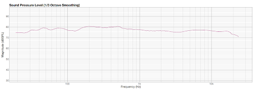

It seems some more graphics would be useful so here are some more plots.

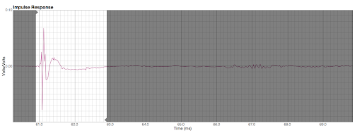

First, here is the impulse response. You will see that within 2ms most of the impulse is done. You can also see a reflection at about 6ms after the start of the impulse. I was measuring on my front steps and the refection comes from the house approximately 3 feet or 1m away (2m or 6 ft round trip)
5msec window NO SMOOTHING.

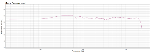

10ms window (NO SMOOTHING) includes reflection. I believe a good portion of the dips and humps in the response 100hz and up can be attributed the the summation of the rear response reflected off the house.
SANE9%20-%20Outdoor%201m%20-%2010ms%20NO%20SMOOTHING%20reflection%20at%206ms%20w%20GEQ.png

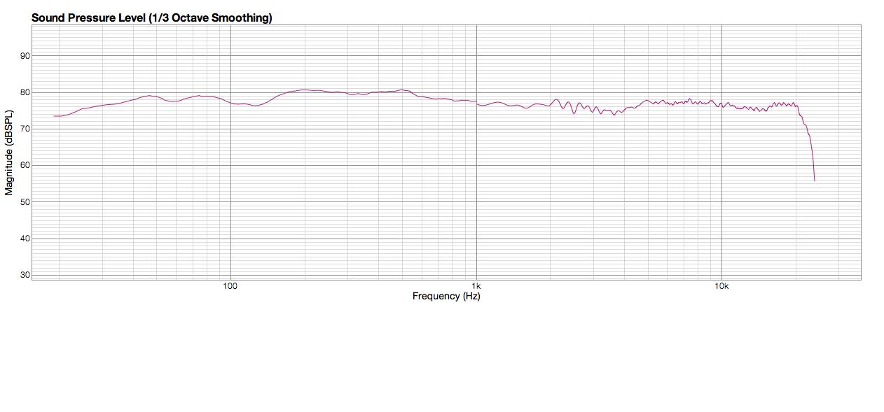

The remainder of these include 1/3 octave smoothing. IMO, with all the reflections included in the data it becomes less useful for fine tuning the response.
20ms.
50ms
100ms. Of course at this larger window in time, the resolution gets more detailed at the lower frequencies. You can still see the effects of reflections.
In order to get more accurate data by using a longer window in time, I would need to move more equipment outside and perform the measurements at a greater distance from surrounding obstacles.... or get my self a proper anechoic chamber. 🙂
Indeed it does... based on the impulse
Agreed. And I did use larger time windows to get more accurate data to tune the bottom end.
What software are you using? That is a cool feature... or are you manually pasting the two results using a graphic editor?
I use HBX V6 (hobbybox) it is only in German available. And yes the mls software can do that
I paste your 5msec no smoothing and 50 msec 1/3 smoothing at 1khz with ms-paint.

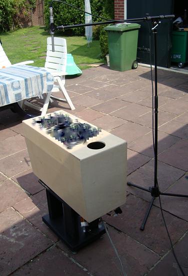

The advantage of MLS is you do not need a special room.
This is what I did. I placed the loudspeaker on its back speakers facing upwards.
From the heaven I do not espect reflections. And the time that the reflection comes back of the ground is easy to calculate.
(344m/sec)distance from floor mtr = sec
And not al reflections are in the direction of the mic. So with 20-50msec windows this works perfect.

I don't think that method would lend itself to measuring a dipole system. 🙂
It is also good for a dipole. place it 2mtr above the floor mic 1mtr higher the reflection has to come from 6mtr (17msec) and in the open field the reflection will not bundle like in a room.
it is 6mtr/(344m/sec)=17msec the formula above is faulty

Still a nice result I only not understand why you not drop the low end a bit or raise the response above 1kHz to become a more flat spl. That shout be easy with active approach.
Yes, you are absolutely correct. It is easy for me to make very flat response and I have tried configuring with much flatter response but I definitely prefer this slope as it is better perceived as flat to my ears. This curve tends, at least in my opinion, to provide a much more realistic experience, especially when listening at higher levels and/or female vocalists.
Linkwitz has written extensively about optimum loudspeaker response and a tendency for increased sensitivity at higher frequencies. The basic idea is that our ears are more sensitive to the higher frequencies especially at the angles normally presented by a typical stereo speaker orientation.

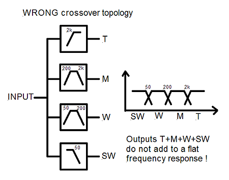

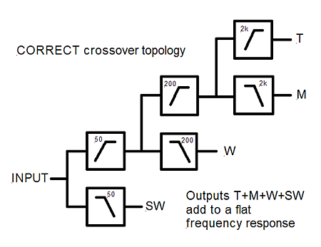

Linkwitz transform can be realised using notch filter and shelving lowpass. It is not required for low-Q woofer equalisation as normally two shelving lowpass will do.
Cascaded filter:
Crossover topology mistakes
gainephile, could you explain further how the parallet Topology fails because of the phase shift that happens?
From Linkwitz,
In the 4-way example, the 50 Hz transition from SW to W will be flat as designed. The 50 Hz highpass, though causes enough phase shift at 200 Hz for W so that W and M do not add properly. The M-channel 200 Hz highpass has the same phase shift as the 200 Hz lowpass in the W-channel, but the M-channel does not duplicate the phase shift of the 50 Hz highpass in the W-channel.
Outputs M and T might add up properly for the 2 kHz crossover, if the 200 Hz highpass in the M-channel adds little phase shift at 2 kHz.

Starting at the bottom end, I've added the 15" woofer in the hopes that it might help out the low end. I also added 3 PEQs in the bottom end at reduce room modes.
-5 at 31.5
-8 @ 63Hz
-9 @ 89
I think the response may be smoother but I don't have clear testing data because I was listening alot so I can't "prove" that the response is much smoother but I can definitely say it "feels" better. 😀
I also started working on figuring out the impact of room reflections on frequency response between 100 - 1kHz. Testing data confirmed BIG dips in the response due to rear output reflections. I fooled around with the GEQ but that was a relatively useless exercise. The application of some relatively simple wall treatment was a great success however. This little change made a much more significant effect than I had anticipated by reducing the negative effects of wall reflections by at least 2db.
I also added 3 PEQs at 355, 450 and 630 to further reduce some of these negative effects of wall bounce reduce baffle hump. I've also bumped up the GEQ about 1db between in the same range as the PEQs. I called this SANE10 so I can go back to the outdoor settings easily. I believe it would test a little closer to the LCW now.
But I've been writing alot on this website instead of listening... so I've got to get back to some listening and I'll report back with some findings. I will probably not have many comments on how it sounds until after I've had a chance to live with it for a while. I may end up reversing the Midrange PEQs. I also want to take it back outside and confirm the outdoor response measurements.
Tomorrow I'm going fishing so don't hold your breath waiting for first impressions of these changes. 😎
