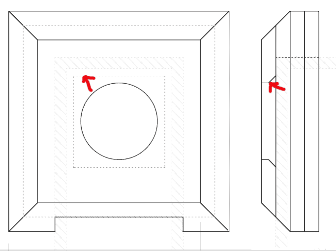

Not quite... you have a quite a tunnel to set the driver into... you need to open that up quite a bit -- we add a 45 degree champher to the inside of the driver cut-out.
dave
I was not aware of this.....nor had I read anything about this. Wow, how on earth do I do something like that now that it's all put together?
italynstylion said:Wow, how on earth do I do something like that now that it's all put together?
This is where that handy little rasp comes in...
the documentation could be a bit more explicit...
dave

Your baffle is very thick but a rasp or file will work. I just did that with
an inch thick baffle. The chamfer is done in sections around the screw holes so a daisy pattern with four petals results. There are pictures of this but I do not have one.
Dave can maybe draw that.

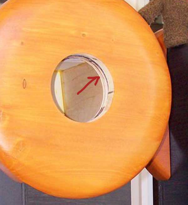

What I did was drew a box connecting the four screw points on the back side where my t-nuts were driven in.
The 45 degree angle to file is bordered by those points. You are making four flares in the back and making sure not to go through to the front.
Using a file gives more control than a chamfer bit in a router. I tried that on a previous build and was glad I got a file (half round) to do it on the new build for the 167e.

loninappleton said:Maybe you can see this:
\http://www.diyaudio.com/forums/attachment.php?s=&postid=1716704&stamp=1232302558
That is a very good illustration of the concept. You don't necessarily have to take it to the extreme lon has.
dave

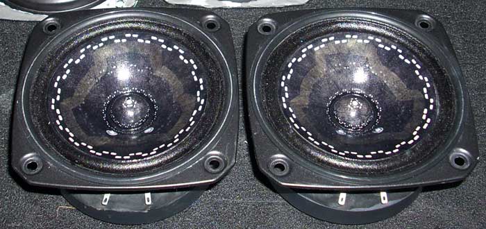

Does anyone know the diameter of the mounting holes for the Fostex 126's? I ask because I have to decide now what I'll be using to mount them so I'm trying to find some appropriate mounting hardware.
