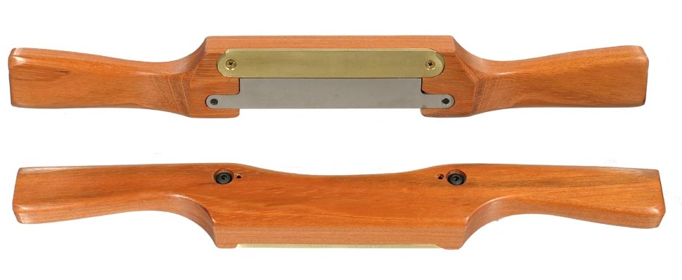

hybridfiat said:a spokeshave.
For those not versed:
I might just throw a rough girt on my RO sander and tough it out for like an hour or so. That should get me what i want.
italynstylion said:I might just throw a rough girt on my RO sander and tough it out for like an hour or so. That should get me what i want.
If it is pine as it looks, 3 steps from 80G > 100G > 150G should give you pretty good results.
