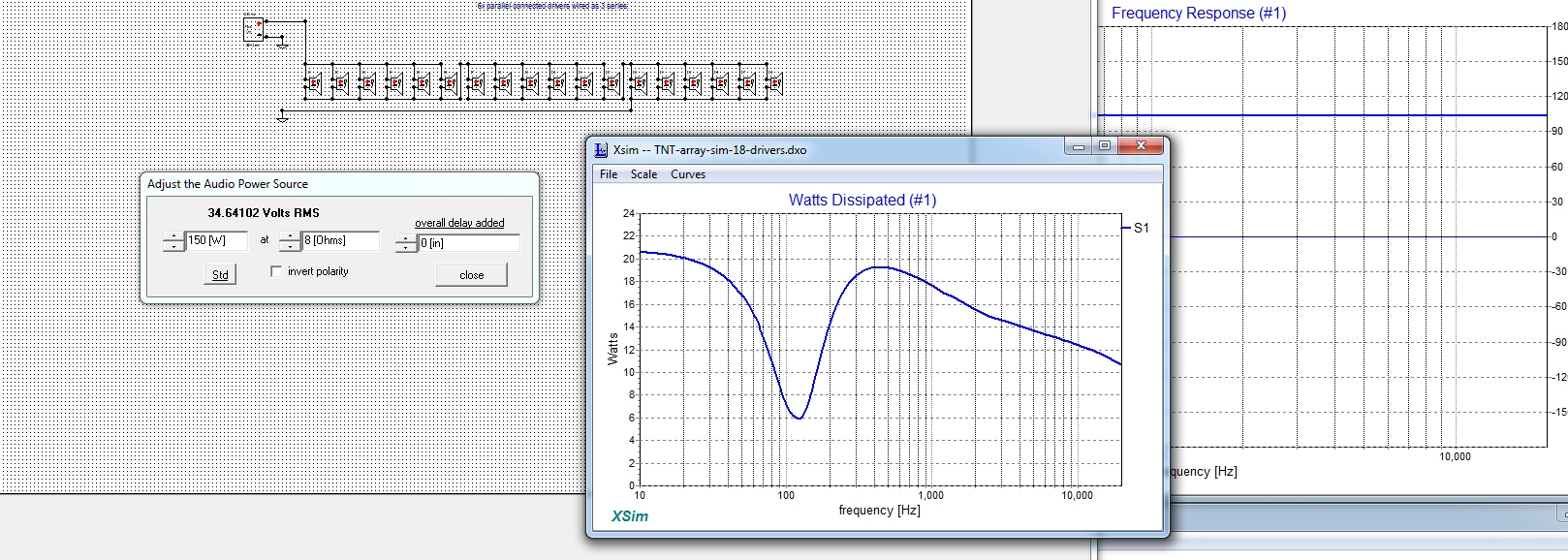

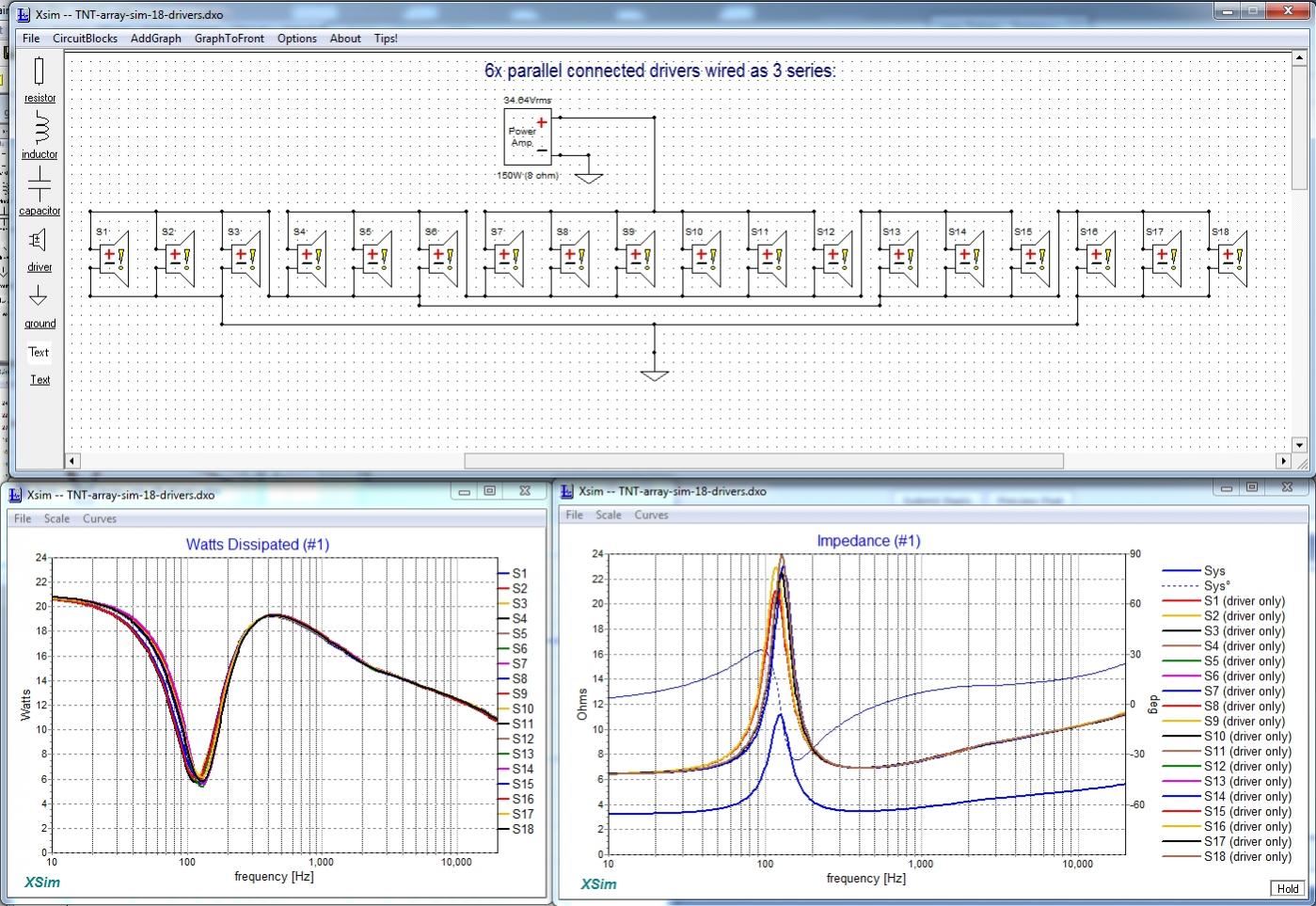

Keep the groups of drivers in parallel, put those groups in series.
Mix and match to get your desired impedance.
Sim it in XSim with actual driver impedances and it will become clear.
The sim I uploaded has actual (though not yours) driver curves.
Look at all graphs to see what each driver gets.

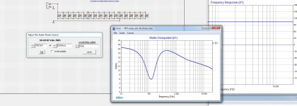

I learned something new today, see: https://www.diyaudio.com/forums/full-range/242171-towers-25-driver-range-line-array-492.html#post5789576
I remembered the above post by me, and the schematics I put up for you. Here's the sim for 150 watt into 3 series of 8 parallel drivers:
attachment.php
I know you use less and the drivers you used are a bit different from the TC9. But I only became aware of this today and thought I should confess/share. 😱
If you did what I advised you (sim in Xsim) I'm probably not telling you anything new (I hope).

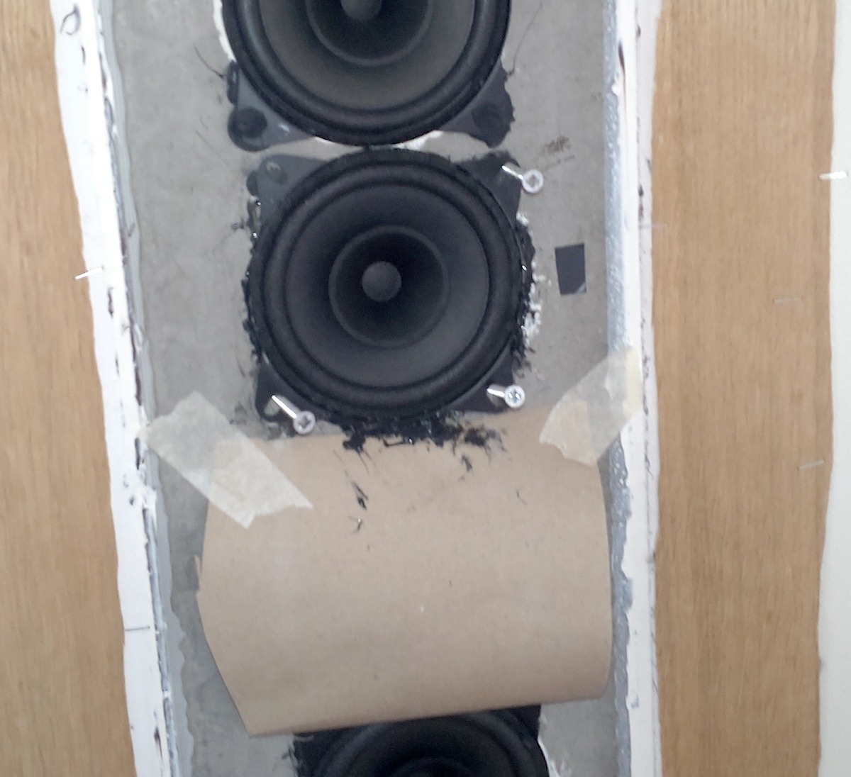

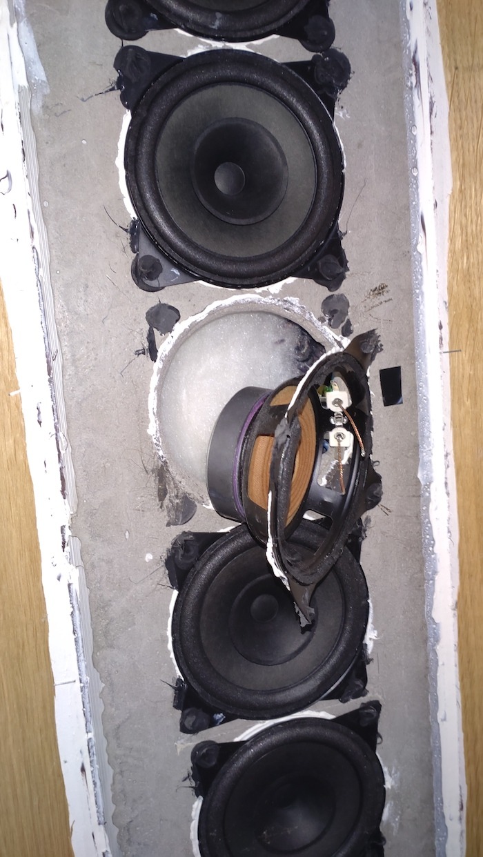

My lines has served me well during the years but for some time now I have heard som worrying noise from left channel. After some investigation I managed to identity the troubled driver - exercising it showed it had a rubbing coil. Now, I did glue all drivers deliberately and knew servicing it would perhaps not be easy - now the day have come when its necessary. By a chisel and a hammer I managed to kind of pry the driver out and the glue let go.
I now have a driver soldered back - the wiring was tight so I had to extend the plus lead to the driver in order to make soldering possible. It's now there and playing so thats good.
Now how to glue it back - I dont want to take down the cabinet so I have tp find a way to fixate the driver while standing up. Need to do some temporary jig to secure the position...
Great job done, TNT!
Congratulations.
