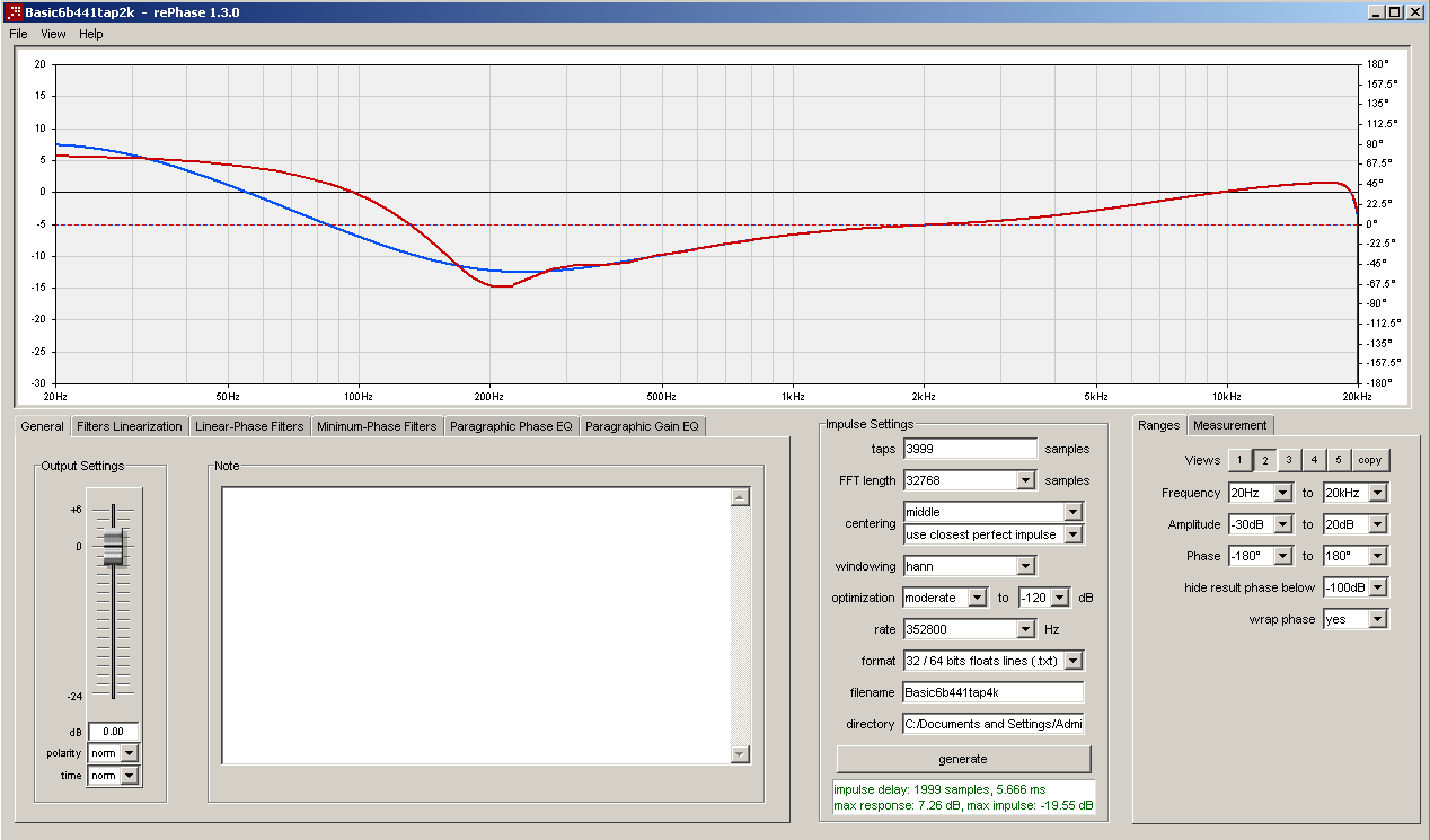

I succeeded to implement a compensation filter for the line arrays along with a DA brickwall filter, placed in the first FIR stage on a DAM DAC using rePhase to generate the filter. Hurray :) And it sound really promising I think but still a few pitfalls there I'm sure. Due to lack of taps the desired EQ can not be acomplished but it seems one can fiddle with to approach what is desired.

4000 available taps in the Soekris-dac, hmmmmm. I am tempted!
Are you happy with it (dac)? Pops on startup/shutdown? Low noise?

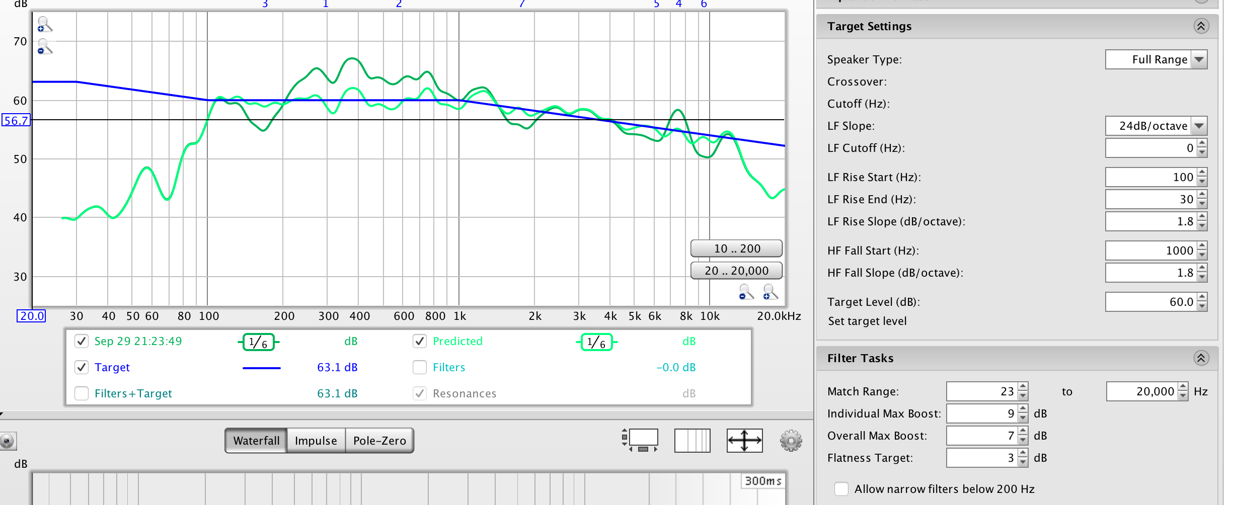

Member pos wrote:
"4000 taps at 352.8k rate is equivalent to 500 taps at 44.1k. That is more than enough for an antialiasing filter, but probably not enough for real world EQ. In comparison an openDRC does 6144 at 48kHz."
I think I have to compare letting the DAM do 4 IIR filters instead.
2 things that hold it back, first: there is a maximum number for boost settings (yours is 9 dB, the gap is bigger) and second: in general it usually does not boost after roll of at low frequencies. Not all users of REW will have multiple drivers that can take the abuse in the low end.
I'd advise to bring the target a bit lower (half way between the max amount of boost and cut needed) and use a few manual PEQ's to bring up the bottom end. Don't go completely wild on the boost part. It's quite easy to do better with manual EQ once you get the hang of it. You can use the split window to see the impulse or waterfall in the lower window to see what you're doing isn't creating new problems.

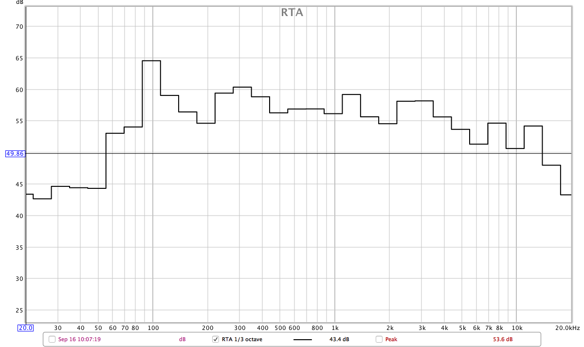

Very much so - thanks for asking! :)
Even more after replacing that bass peak above and introduced an LT instead. That made the bass come home. I was also gentle with that so need som more tweaking. Also it seems that tighter span for REW EQ pays off so I will see what I can fit into 13 BQs. Reinstated one the absortion-worms on the side walls. This widens the soundscape in what seems a natural way but also seem to eliminate some kind of "fluttering" sound - is this loobing?
I have now also been able to move the speakers all the way into the corners. Well, almost, something is obstructing the last say 5mm. Probably this old house is not square enough so this will be it. I reused som of the cuts from the cabinets to fill that little gap on the front side wall - I will paint them eventually :)
I also now use my B&O ASP1000 - wohooo ;-) the solidity, the power. OMG :-D and still some tuning on EQ to be done.
Project beyond expectations. I will do new measurements and present them and I hope you all have yet the will to share more of your valuable advice and tips.
