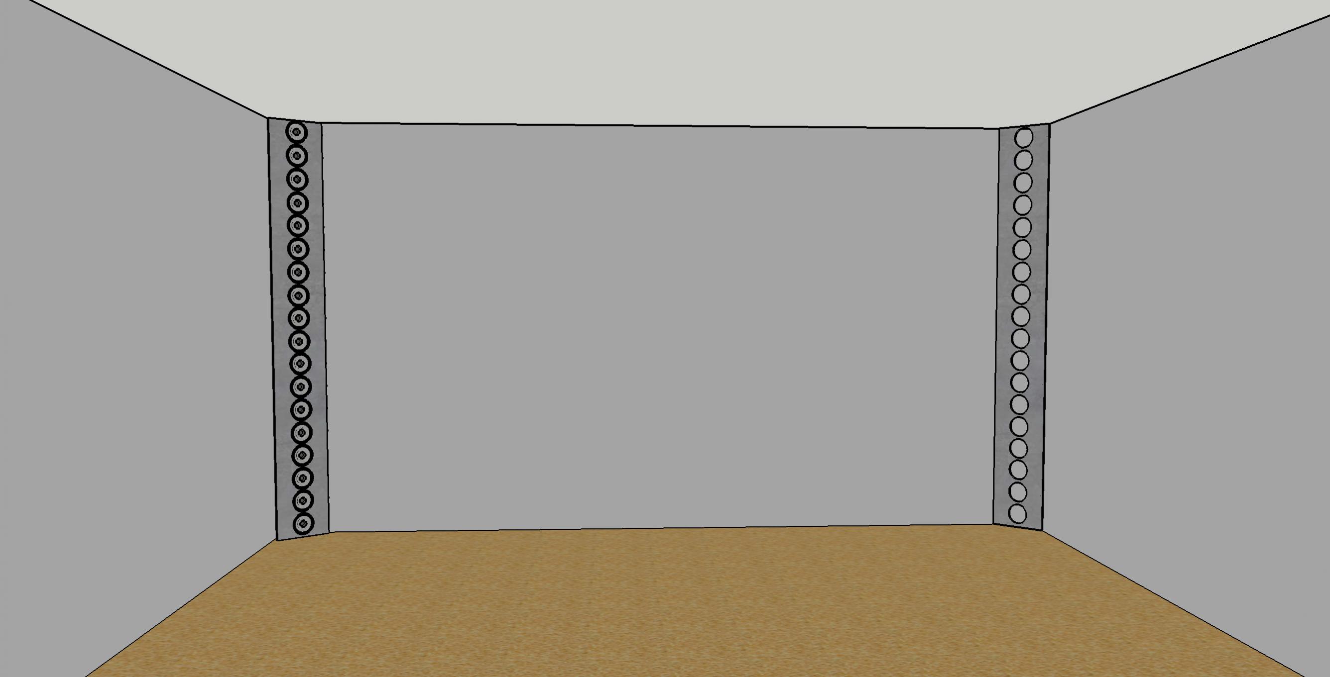

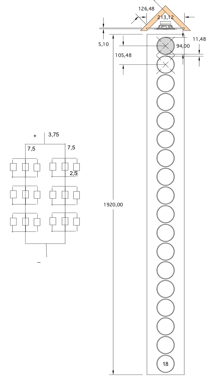

Intrigued by some corner array projects here, I decided to build myself a pair for the summer house. After some investment analysis I went for the cheap path and got 50 pcs of:
FR 10 HM - 8 Ohm | Visaton
Cost was 310€ taxed and shipped via Mouser.
Corners are 190+ cm high so 18 drivers in per array.

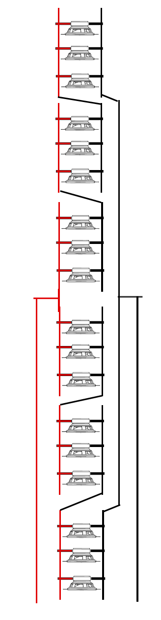

6x3 => 3,75 ohm.... any other way to do it?
I hope for the 20/80 rule to kick in :) and to get some really nice experiences for a less amount of euro. This place is not heated during the cold and damp winter so better not go full in this time. Next version will have to be with 10f/ if this seem to turn out well :)
Pictures and impression as things unfolds...

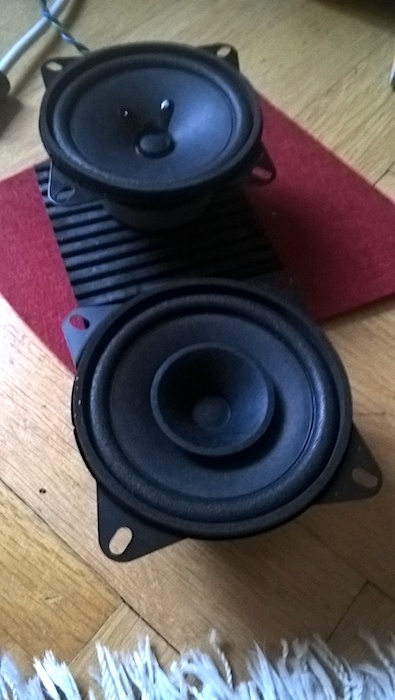

Some initial listening tests indeed seem to verify that the whizzer might be a problem. As I have a lot f them so I "wasted" one. Well, the presented FR is tilting upwards in the top so if that flattens out I have no problem losing it. Depends on what happens to dispersion. Sound is... well not as "refined" as 10f - I do own a pair - but hey ;)
Agree on the whizzer... I have sharpened my scalpels ;)
That's not necessarily a good idea. So far, all reports of "whizzerectomy" I have seen said "not better" or "worse". The whizzer is integrated into the system. Remove it and something will/might be unbalanced.
Also, the array will change response as well. Build the array first, listen and measure first, EQ next and *then* see if it needs more work/whizzerectomy.

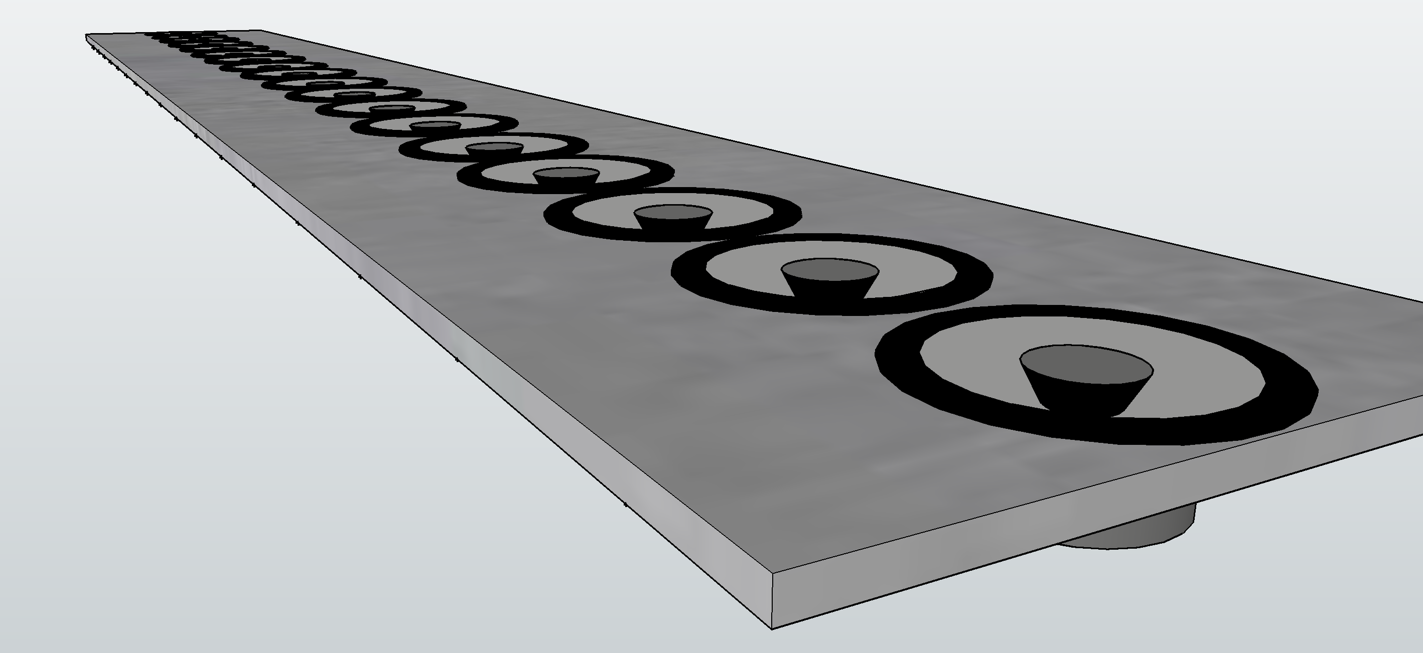

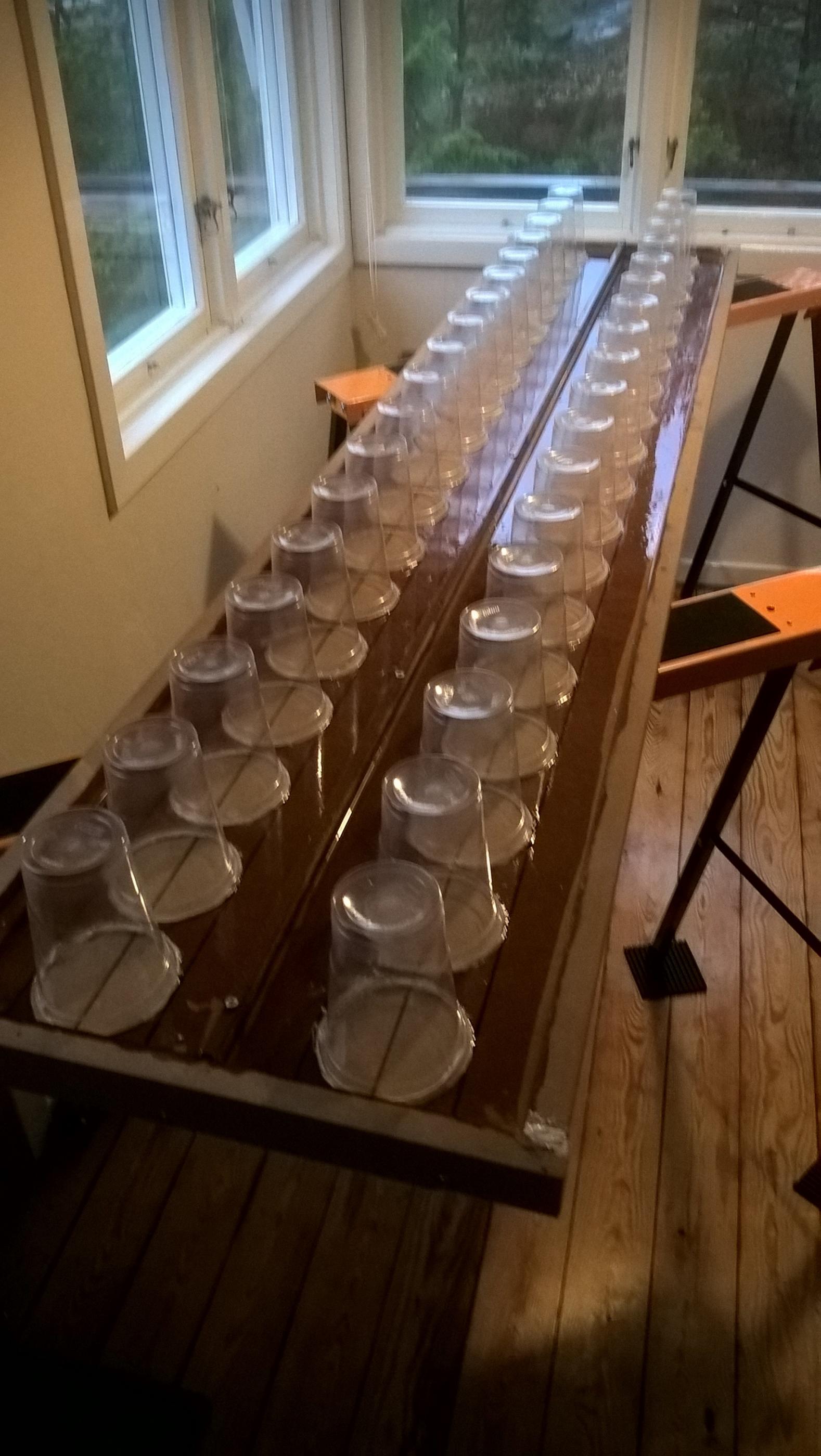

Thinking about how to build and assemble in the absolutely simplest way. Maybe I can mould a baffle say 1 cm thick out of concrete. There is this variant with plastics armour ready as you buy the mix. Add som metal mesh for further strength. I have found plastic glasses that are 94mm in diameter - I'll glue these in the bottom of the form and the just pour 10 mm concrete incl. armour. It will need about 10 litre, 24 kg concrete for each.
Then glue the drivers in place instead of drilling hundreds (144) of holes and twiddle with bolts and nuts.
