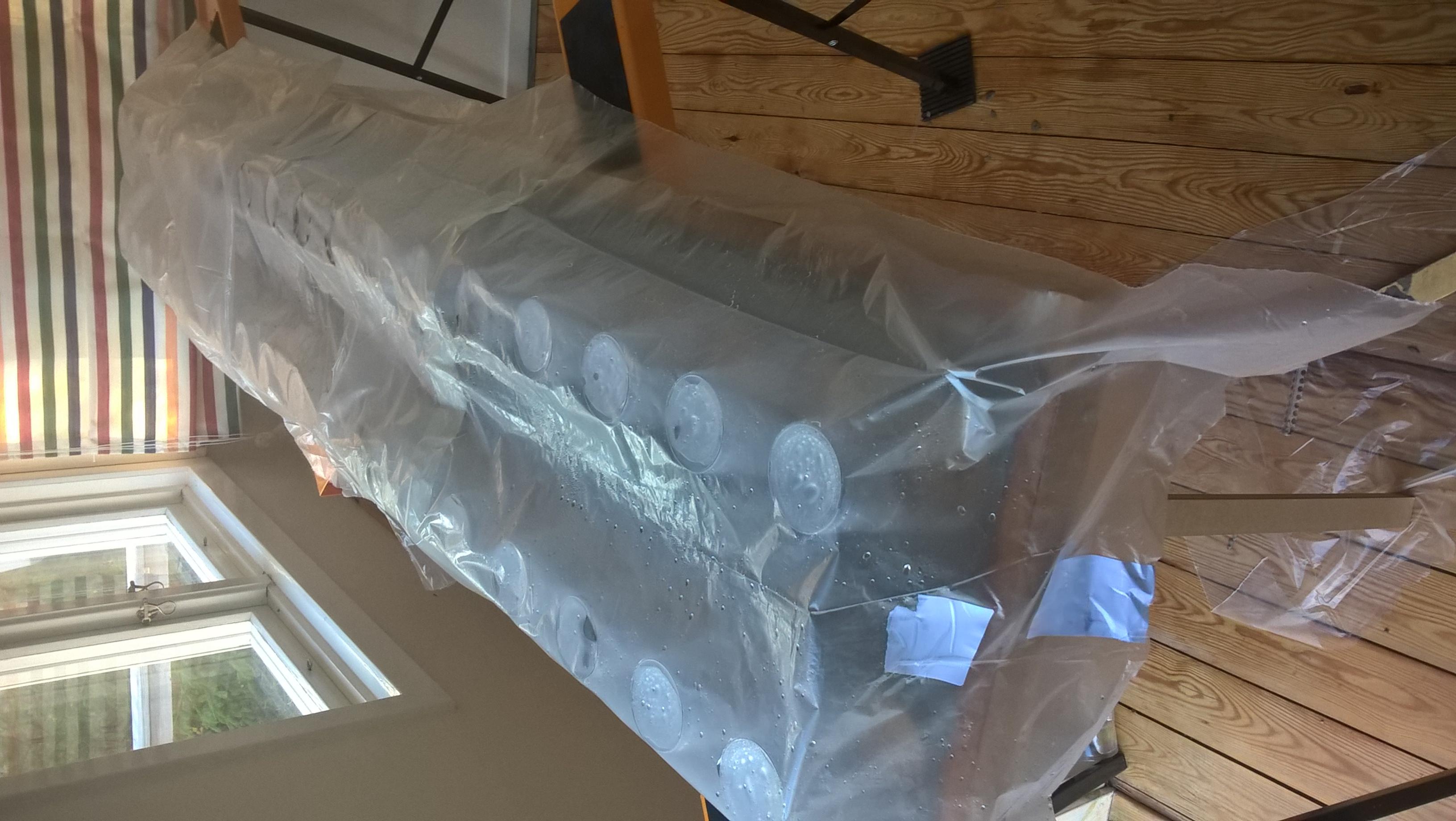

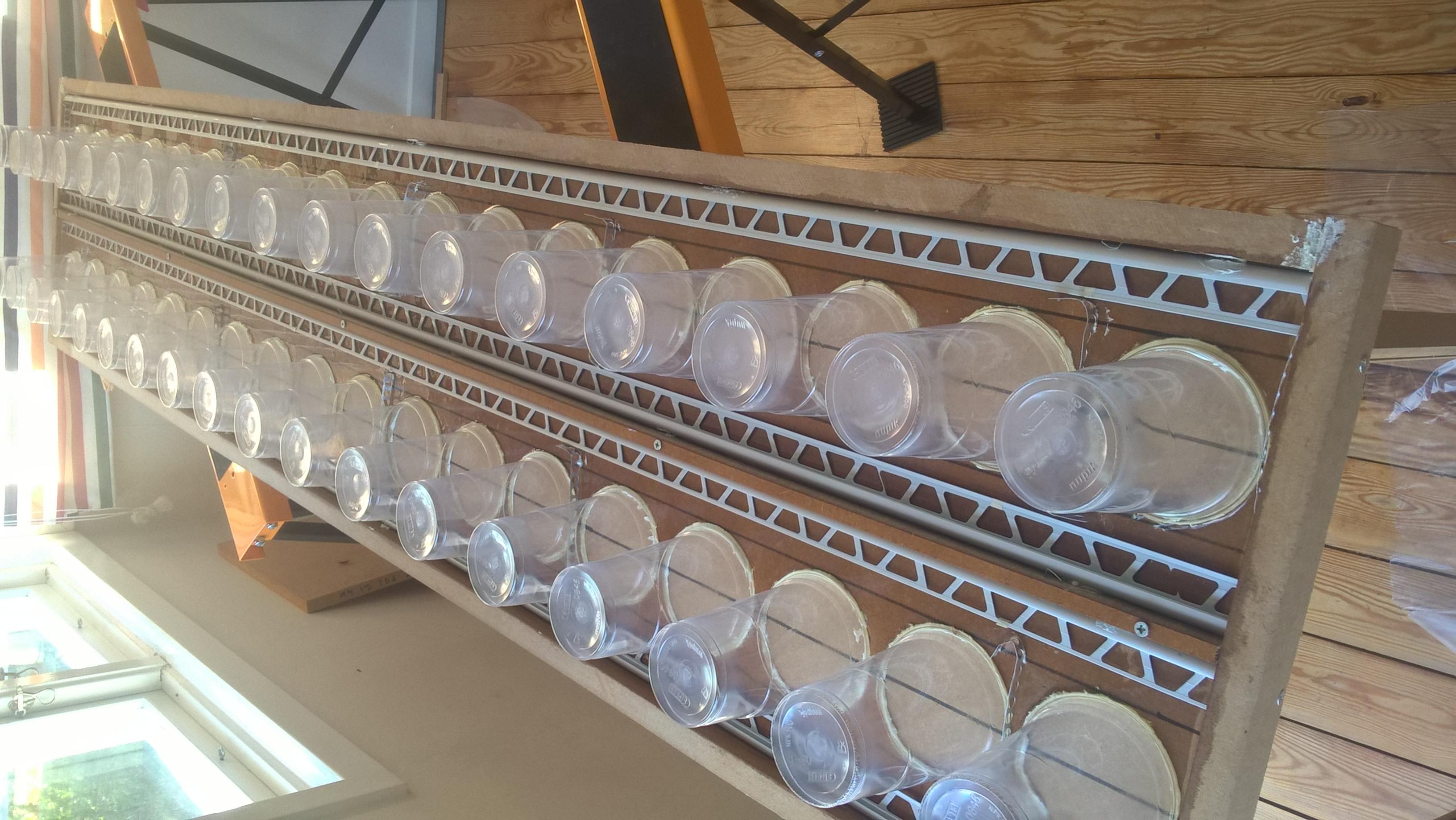

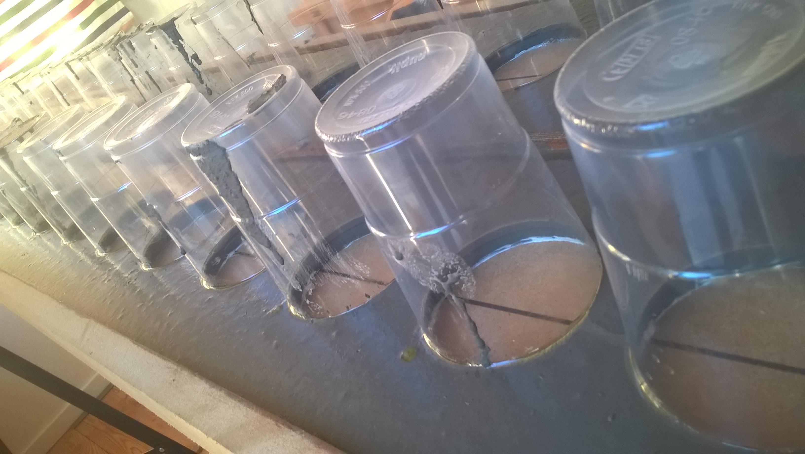

My FR10HM corner-ceiling-floor-array
Poured the concrete today. Now on watering schedule...
Cool project! Keep us posted. I built something similar with the TC9. Looking forward to your impressions.
I own a pair of 10f/ and it seems that are not miles away from Tc9, I think this driver is not as good - but I hope for a decent and engaging result.
We'll see and let you all know the result - warts and all.

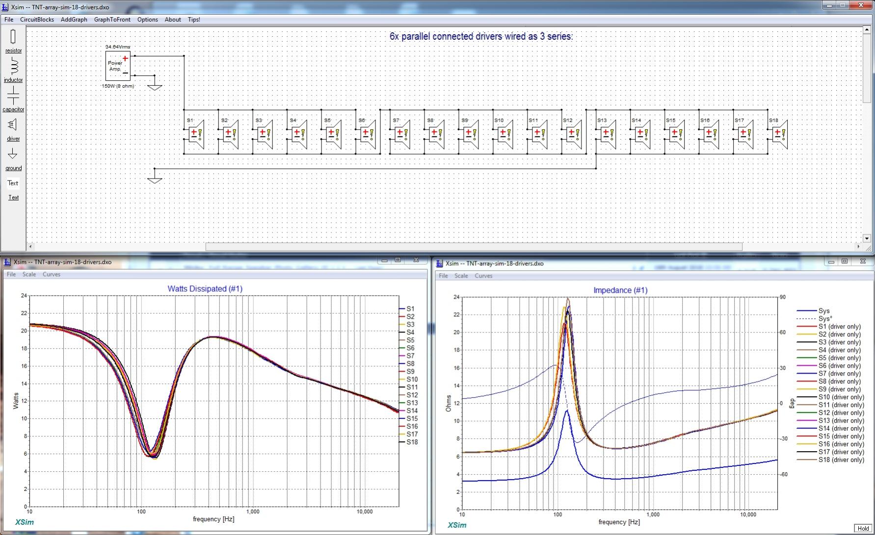

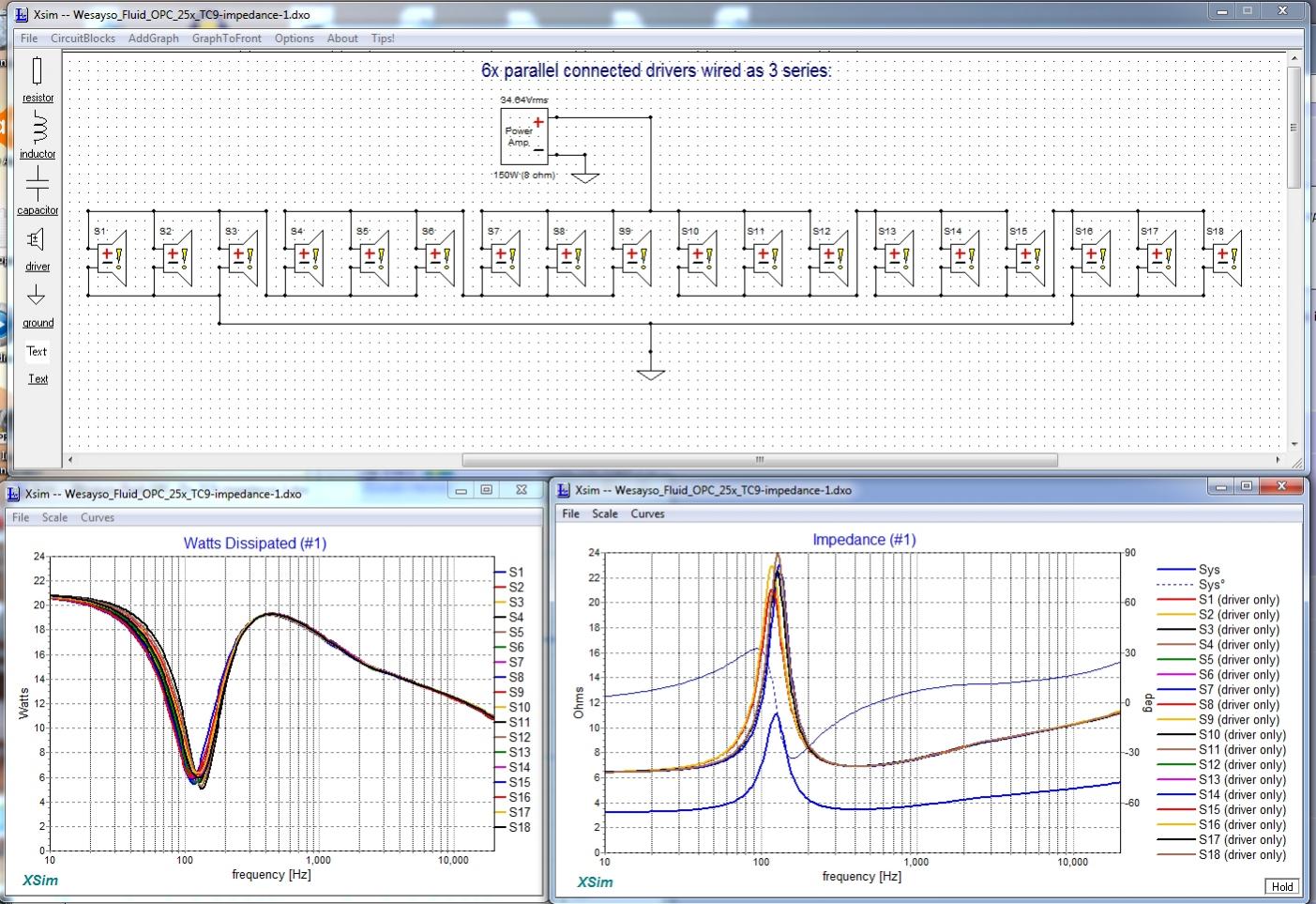

Did a quick sim in XSim with impedance curves (real curves of each individual driver) of a group of TC9's from Fluid (had them on hand thanks to BYRTT who had done some simulations of parallel/series wiring vs Series/Parallel)
Here's the result:
attachment.php

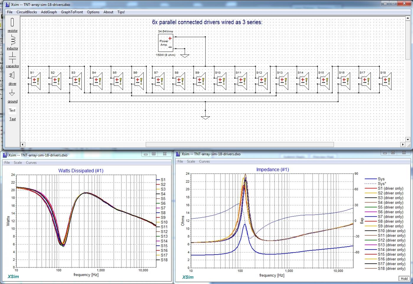

Funny enough, when I connect the ground from driver S9 and S10 it becomes slightly better balanced:
attachment.php

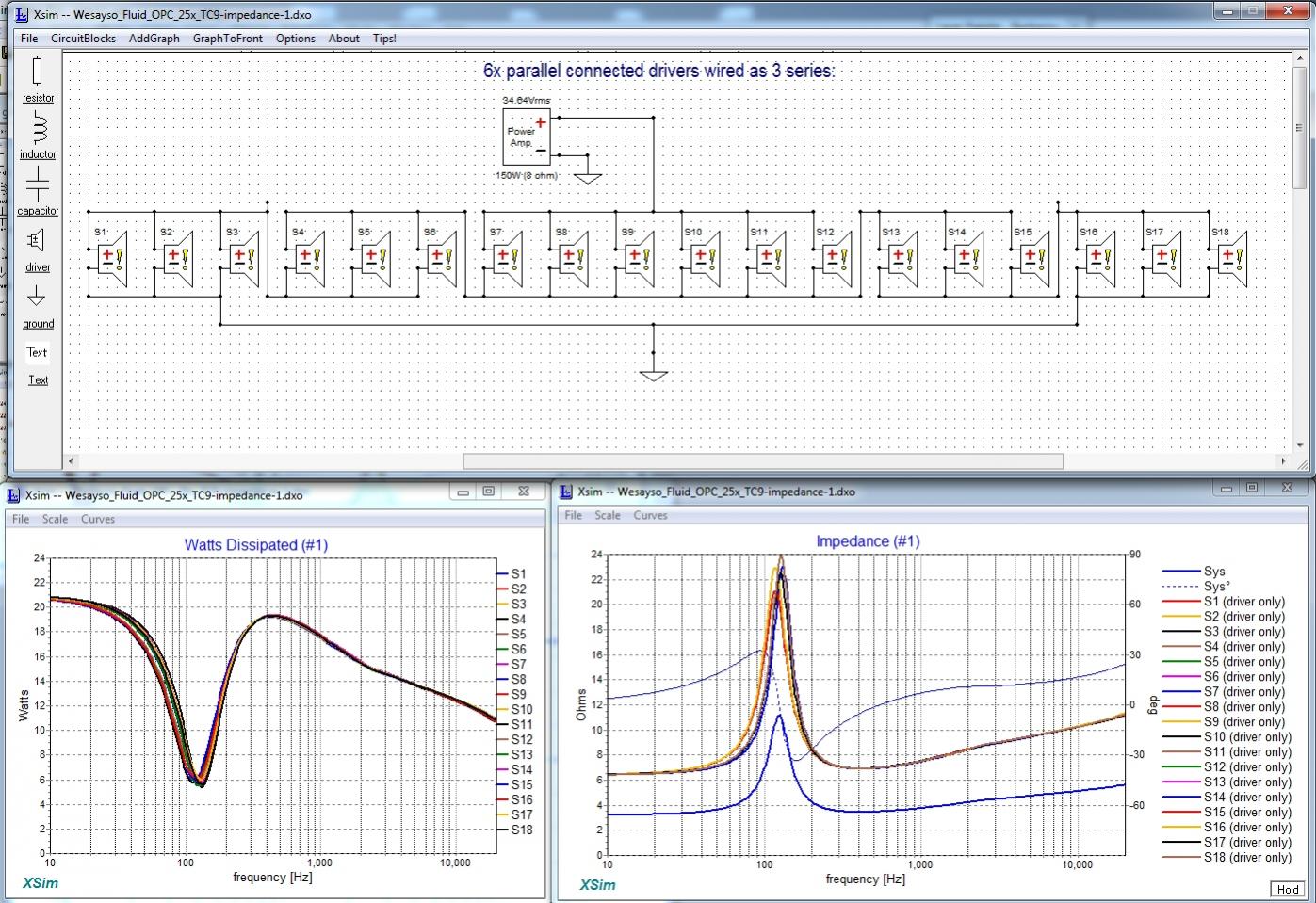

I tried the same on coupling ground on S6 and S13, which only had a minor influence but still a slight change. Might be worth it...
Grouping them together averages out the impedance curves a bit better it seems.
attachment.php
In this example I have put 150 watt on the array, so you can see how much each driver gets. I only upped the power to 150 watt to make the individual driver differences more visible.

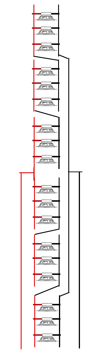

I attached the XSim file for you to play with. Not the impedance curves of your actual drivers, but at least a real curve for each individual driver was used. Your schematic works, but I'd opt to add the 2 ground connections I mentioned.

Can you click on them to get the full picture?
Case one is your proposed wiring scheme,
Second one has the ground wire from series S7 to S9 connected to S10 - S12
Third is one more ground wire between series S4- S6 and S13 - S15
This tweak makes every driver group of parallel drivers connected as a clear group of 6.
At least that was my idea behind it.
