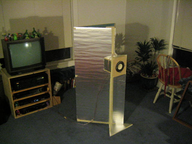

Ok, here's what I did tonight. I had to work today, so I had all day to think about everyone's input so far (thank's, by the way, I do appreciate it). My main concern right now is to restore the clarity in the midrange and highs. Get back the 'sizzle', so to speak. The easiest one was to try reducing the size of the vent at the top. 80 percent reduction cut the bass too much. 50 percent just didn't sound right. 25 percent reduced the bass enough to bring the speaker into better balance, low's, mid's, and high's, but it still didn't help the clarity issue.
I then considered changing the box behind the driver, but that would require too much surgery right now. I don't feel ready to do that yet.
So I cut off the top part of the 6-inch X-baffle, above the driver. That did it. The midrange and highs opened up beautfully. No question about it. I could almost live with this speaker as it is now except for the resonance from the foam. It's like the reverb they put in FM radio. You notice it, but the sound is still very nice.
Here's a photo of what I did tonight. I then will have a bunch of questions. I want to build another prototype. Something closer to a final design.
Doug

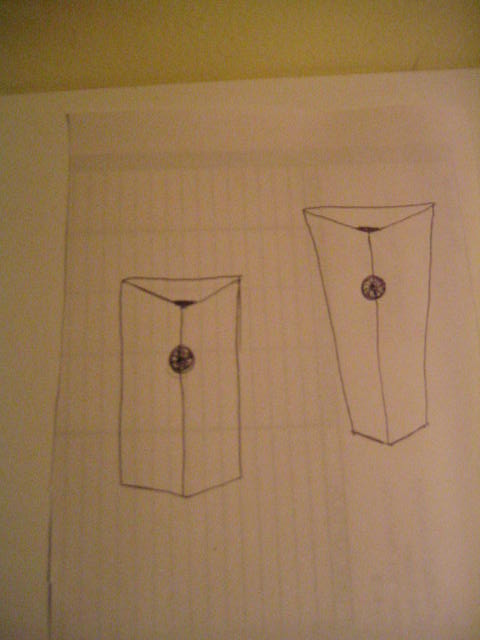

Some questions:
1. In a TQWT design, what is the ideal pipe length for this driver? Or is that too vague a question? I'm seriously math challenged, so I need help on this. I can't do algebra at all. Right now, the pipe in the triangular column is 96 inches (243 cm) long. The driver is 16 inches (40 cm) from the small end of the pipe, which puts it 32 inches (81 cm) from the floor. I would like to reduce the overall size of the enclosure (wife's request). I could make the cabinet taller to compensate, if necessary.
2. Do I need some kind of compression chamber behind the driver? In looking at Fostex's back-loaded horn design, their chamber behind the driver is 1,566 cubic cm (17 cm x 18 x 6 minus blocks #29), and the opening into the horn is 35.7 square cm (17 cm x 2.1). This gives a chamber size to horn opening ratio of about 44:1. In my next prototype, I can build it so the driver fires directly into the pipe in the triangular column or I can put a compression chamber in first. I just need to know what is best for a TQWT design.
3. What do you think of a tapered design (see attached photo)? Do you think this would mess up the soundstage by reflecting sound downward? I much prefer this look to straight edges, but if it messes up the sound too much, I will stick with straight. One thing I did try with the existing prototype was to hang blankets over the large triangular panels. It totally killed the sound. So this proved to me that there is a lot of stuff happening off those surfaces.
Sorry for the rambling questions. Any input or help is greatly appreciated. I do seriously consider everything said so far. Some things I can't change right now, some things I will try at a later time, but everything so far has been a great help.
Doug
Some sketches for the next prototype:
I just noticed. The driver on the tapered sketch will be plumb. It won't fire downward.

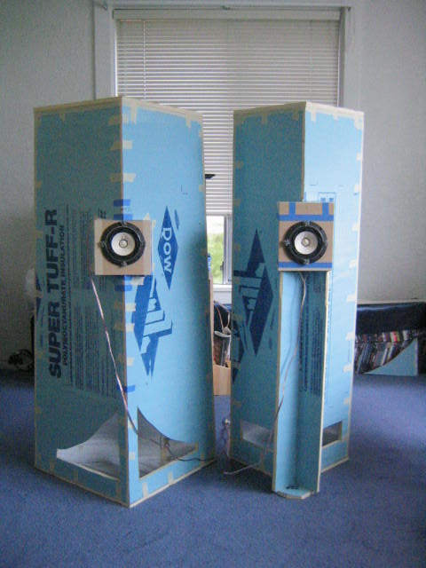

Last week and over the weekend, I put together three more prototypes: #2, #3, and #4 (real original, huh?). I figured out how to front port them at the bottom to get some floor reinforcement.
Right now, I am using Fostex's front-loaded horn specs for the compression chamber (1560 cm2) and vent size (62 sq. cm), and horn length (77 inches). Sizes are approximate, within 5 cm, due to foam not being real accurate. Driver height is 32 inches on all prototypes.
Box #2 (left) uses 18 inch sides but taper to 15" at the top. It's a folded horn with two internal baffles. The vent is at the top of the compression chamber. It lacks bass extension and loses some resolution. I do not think this design will work.
I learned on this one that lots of bracing tightens up the sound quite a bit, which is a positive sign for eventually building out of wood.
Box #3 (right). It uses 16 inch sides with the X-baffle being 3.75 inches. It too is a folded horn with two internal baffles. This one is not so overwhelmingly big. It has a Footprint of about 16 x 13 inches. Figuring the math and layout on this was a bear. It took me almost two days to build. It's built as accurately and tightly as possible.
The sound on #3 is really nice. Good bass into the 60 Hz range. There is something happening with the little wings in front. I've noticed this now on every prototype I have built. The speaker comes alive. I don't know what's going on here, but it's a totally different sound.
I also built a prototype #4. I will cover that in the next post. Here is a photo of #2 and #3.
Doug

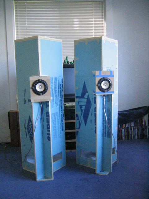

I concluded that prototype #3 is the best so far and one that I will focus on. Due to the difficulty in building this, I first wondered if I could get by with just one internal baffle by shortening the horn to the 60 inch range. This required placing the vent at the bottom of the compression chamber and using a single baffle to direct the backwave up and then down to the bottom of the cabinet. This experiment resulted in #4. Otherwise, #4 is identical to #3.
#3 kills #4 in A:B testing. I did a frequency sweep, and #4 dies out around 100 Hz, while #3 sounds clean and loud into the 80's and gives very usable bass in the low-60's. #3 has more resolution as well and just sounds louder and better. The sound of bass strings being plucked is very clear in #3, not so much in #4. There is no question; #3 is the one to go with. Unfortunately, it's going to be a bear to build out of wood.
I did some very critical listening this weekend on #3 and #4 with a variety of music. This design excels at small group acoustic music and vocals. Patsy Cline, "12 Greastest Hits," brought tears to my eyes. Mark Knofler, "The Ragpicker's Dream," lovely. Cowboy Junkies' "Trinity Session," better than ever. Classical sounds okay if a bit distant. Jazz is really nice. Cassandra Wilson sounded great. Rock is the weak spot, but it's listenable.
So #3 is the one I'm going with. I will do a box out of MDF first and then finally see how the foam prototype compares. I have a feeling it will do fine, as it sounds really nice as is.
I have more pics of the construction of #3 if anyone is interested. I plan to build the MDF enclosure over the next few weeks.
Prototype #4 is on the left, #3 is on the right.
Doug
