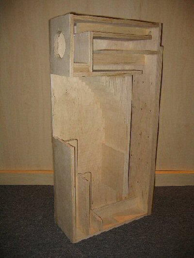

Still I doesn't understand why the Fostex design isn't a back loaded horn. I did some calculation and a fond out that acourding to the demensions it's a proper part af an exponential horn. If you look at the following site: http://www.melhuish.org/audio/exphypcalc.html you will find a Exponential / Hyperbolic Contour Calculator. The following specs are from the fostex design:
- Throat area (cm2): 40
- Flare freqency (lower frequency cutoff) (Hz): 30
- Size factor (1 for mid or high frequency front horns, bass horns: 2 for center of room, 4 for against a back wall, 8 for corner placement): for example 4
- M (the degree of hyperbolic influence: 1,12
- Desired width of horn cabinet (cm): 17
When you do the calculation, the mouth area at the length of the Fostex design ( 210 cm) should be 443,8 cm2, it is 450,5 cm2. So (with a very small differance) by the calculation the Fostex design is a perfect exponential horn. It's only a part of it. At back wall placement it scould be 5,18 meter long with a mouth of 26.171,5 cm2. But I have never seen such back loaded horn design. I agree the horn is a bit short, at a quarter wave of the flare frequenty ( 30 Hz) it should be 2,7 m long and it is only 2,1 m long, but according to the calculation, it is stil a part of the exponential horn.
And if it's a hybrid of some kind, I have never seen another design with a pressure chamber ??????? I rest my case.
For the Back loaded horn fans a picture of the inside.
Alexander

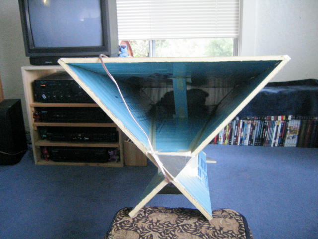

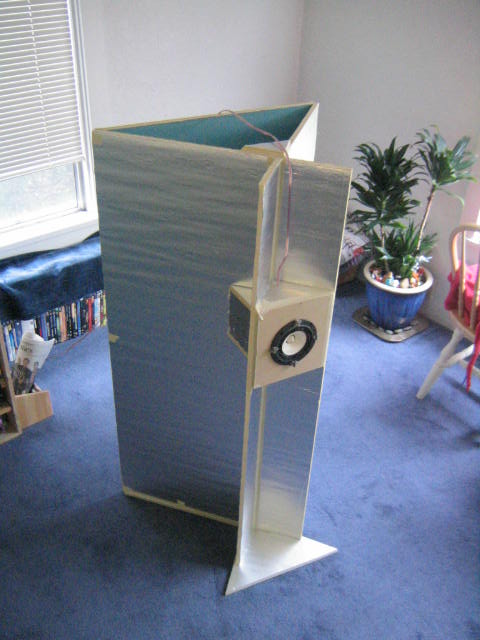

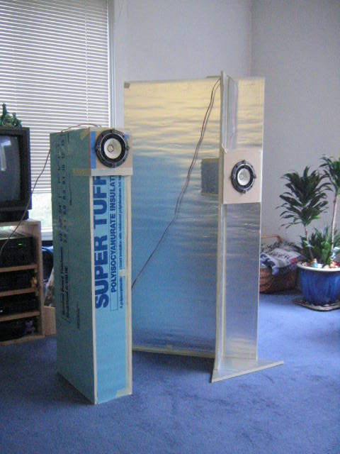

Well, I take a week off and stuff happens. All these theoretical discussions are very interesting, but let's put some rubber on the road: (Oh yeah, Alexander, nice job).
My drivers now have about 180 hours on them, and I absolutely love them. They are perfect for my listening habits.
Last Monday, I built these two prototypes, a Buschhorn MKII and the "X-Baffle." This was the most fun I have had in many months. It took me eight hours to build both these enclosures. I used my test baffles for the driver mounts.
I bought two sheets of 1/2 inch (14mm) foil-backed rigid foam insulation and a couple rolls of masking tape. Total cost was about $22 U.S. I already had a hot glue gun.
The buschhorn I won't go into. It sounds exactly as described here and in other places. I think I have a pretty good idea of what to expect, so I would like to concentrate on the X-Baffle for now.
I wanted to think way outside the box. I wanted to get the spaciousness of an open baffle with the bass-reinforcement of a horn. This is what I came up with. No hard science here; this is the biggest enclosure I could get out of one sheet of foam. I searched the Internet for similar designs but came up with nothing. I'm sure somebody has tried this before, but where?
I built it and put in The Cowboy Junkies' Trinity Session. My first reaction was "whoa!, we have bass." There was some shrillness in the high end, so I put some stuffing in the tube behind the driver. That cured that, but I could now tell the upper end was lacking clarity.
The sound of the X-Baffle:
Pluses: Warm sounding Ton's of bass, maybe too much. I'm sure the foam resonates considerably, but there is a warmth that is totally lacking in the Buschhorn and the open baffles. Vocals have great weight and presence. Great slam is what I'm thinking. The sweet spot is at least 3 feet (1m) wide. It is perceptably louder than the Buschhorn.
Minuses: The mid and upper range is more muted than the Buschhorn. My wife said it sounds kind of "boomy", plus it's big. She asked "can you make it a little smaller?" Cymbals are not as clear. It's butt ugly. No WAF here, although my wife is tolerating it for now.
Overall, I think this is a design worth pursing further. I need to find a way to get the mid and high clarity back. Plenty of bass, though. If anyone has any specific experience in putting mid and upper range clarity back into a design, I would love to hear it. I want to try at least one more foam prototype before cutting some wood. I think plywood is required, due to the large surfaces. Any reasoned input?
Doug
First Photo: Buschhorn and X-Baffle

The inside of the X-Baffle.
It's a pretty simple design.
The X panels are 24 inches wide by 48 inches tall. The back panel is about 24 inches wide.
The front wings, where the driver mounts, are 6 inches long. The rear portion is 18 inches long.
The internal divider that forms the tube is 4 inches wide at the top and 16 inches wide at the bottom. There is a 7 inch gap between the bottom of the divider and the base of the enclosure. I had to put a brace halfway down because the stuffing kept popping the tape loose.
I used hot melt glue and masking tape to hold everything together. Hot melt glue works great. You can do at least a 36 inch bead without problem.
