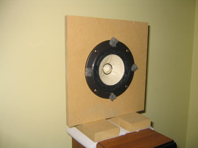

First, break-in. Tonight, I will cut some baffles out of MDF and mount the drivers. I will use the 10w amp for my computer speakers to drive them. This way, I can run the drivers day and night with all kinds of voice and music.
Question: I understand volume is important to breaking in, but how loud? That's one thing I can't seem to find.

I won't have anything specific to add to this thread for a week or two. Until then, here's a picture of the break-in baffles. The foam is to protect the finish from the screws I used. I will not use the Fostex screws until I put the drivers into their final enclosure.
Doug

Taperwood said:
As for an enclosure, I am ultimately shooting for a Buschhorn, but I have so many ideas floating around in my head that it will be some time before I actually build something permanent. I want to experiment with the sound of open baffles, tubes, pipes, X baffles, concentric rings. The ideas just keep coming. The Replikon (sp?) looks really cool, and now I wonder what that sounds like. My wife likes Terry Cain's Abbys, so maybe I can come up with a smaller version (the "Babby").
Let us know how the experimentation goes. Although I will say from personal experience, that the fostex 108es is quite limited as an open baffle driver. It has such a small x-max that it's limited to either low level play back, or an extra large tweeter on an open baffle. Quite a nice driver though despite it's limitations.

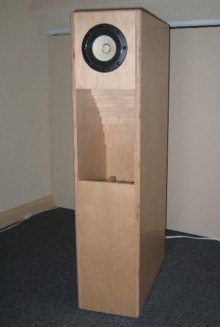

Hi Doug,
Nice to hear that there are other fanatics around the world with the same passion for Fostex drivers. You won´t believe it but I finished monday my Back loaded horn with the FE108E Sigma. I used the original Fostex plans. The result is amazing!!!
It is my second project with a fostex unit. My last project was a basreflex monitor with the older FE164. It sounded good, but it needed a notch filter to smooth the midrange. Stil the mid sounded a bit to loud. Also the bass was a bit to soft. Because I realy wanted to build a horn, because of it´s bennefits, I sold my speakers and began the search for a new pair of units. Because I din´t like the high frequentie response of the bigger Fostex units, I decided to go for the FE108E Sigma. It has the smootest response, but I was conserned thet there would be enough bass. Let me tell you, there is, a lot!!!! The speakers sound better, louder, faster and deeper in bass then my last fostex speakers, with only a x-max of 0,28 mm. In your search of plans for the FE108E Sigma, you have to rememember that the excursion is very limited. In my nowledge, only a bashorn can deliver high SPL with limited excursion. Also the unit is kept under control because of the small compressionchamber ( 1.57Liter). If I hear the amound of bass produced by the horn and hear it´s added volume at the mouth of the horn, it´s amazing. And it is also a deep sound, totally without booming and because of the damping clear of amplefied midrange by standing waves inside of the horn. I really doubt that another enclosure could produce a better bass.
I have added a picture of my project, so you can see the end result. I wish you good luck with your project.
Alexander

Alexander,
Nice work! How long have you broken in the drivers? I'm currently looking at the 108 to replace my 206 in MLTL, and was concered about bass also. How low do you think or know it goes? I was also looking at the swan, but the fostex design has better WAF.
Thanks,
Chris
The drivers now played for about 25 hours, just on normal music. The big differance was in the first 4-8 hours. In the geginning there wheren't much high frequenties and the sound was very flat, like there was a thick curtain in front of it. Also the music didn't came loose from the speaker. After these first hours the changes are minimal I think. But still every time Iám amazed what they can do.
I do not know how low they go, because I can not measure it. The only information I have is the frequentie response from the fostex site http://www.fostexinternational.com/docs/speaker_comp/pdf/recom_enclose/108ez_encl.pdf.
This response shows a -3 dB point around 50 HZ. I think when lisening to them, thats correct.
Alexander

Looks very good -the FE108Esigma horns seem to have a good reputation; it's a pity the Fostex designed horns seem to be hammered by some horn enthuiasts without good reason. Chances are if I had a pair of 108esigmas, these are what I'd build.
Cheers
Scott
