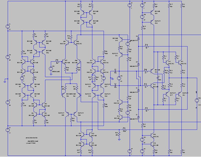

I’m having limited time here to export my CAD package files, so I’ll just do a few quick and dirty screen grabs from my sim files, which pretty much represent the final circuit under construction anyhow.
Figure 1 is a detailed diagram of the VAS, the VAS buffer and the bootstrapped voltage clamp.
Figure 2 is just a zoomed out screen shot for a topological overview of the (almost) entire amplifier front end. Yes, the circuit is extravagant, but anyone who thinks that it looks complicated just hasn’t seen my +/-90V Vout linear series pass regulator for the (triple EF) power output stage yet.
The diamond buffer is biased by an LM336 2.5V voltage reference. Consequently the (bootstrapped) diamond buffer input transistors run at a healthy Vce of about 3V. To minimised VAS loading, these can be low voltage, high beta types. I’m using BC550C and BC560C in the prototype build.
The bootstrapped isolation diodes (D1 and D3) for the VAS voltage clamp are returned to the opposite terminals of the diamond buffer biasing voltage source. This achieves the operating reverse bias (of ~1.25V) that I mentioned in the last post.

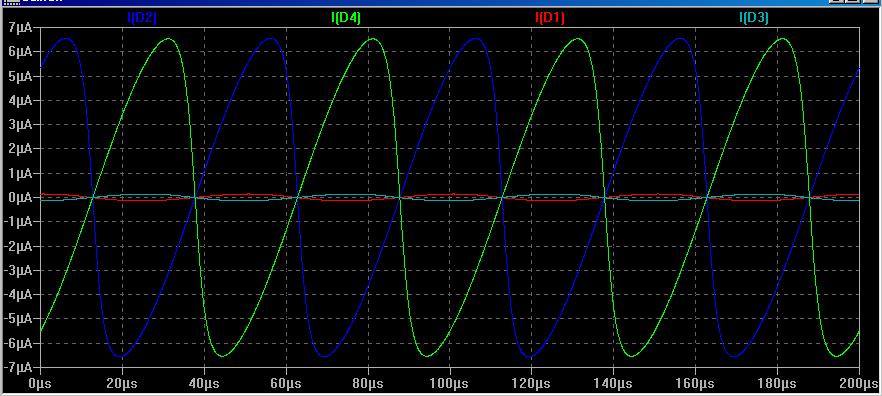

Figure 3 shows just how effective the bootstrapped clamp is. Figure 3 shows the diode currents with the output swinging 160V peak-to-peak, with the diamond buffer driving the 8k feedback resistance.
The red and cyan traces show the current through the bootstrapped isolation diodes, D1 and D3, which are connected to the VAS collector. The green and blue traces, on the other hand, show the current through the actual clamp diodes D2 and D4, which are subject to the full signal swing.
This is the current that would otherwise be loading the VAS, if not for the bootstrapping, or “flying clamp” operation.

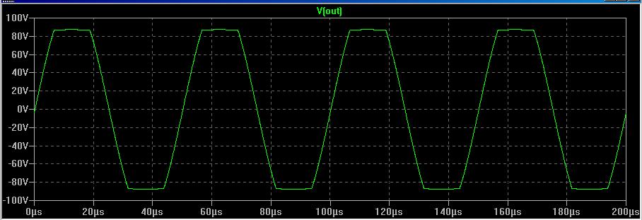

Figure 4 shows the circuits clipping performance at 20kHz. The great clipping performance is courtesty of the simplistic shunt compensation used to stabilise this “single stage” design – there simply are are no complex feedback compensation loops to tame.

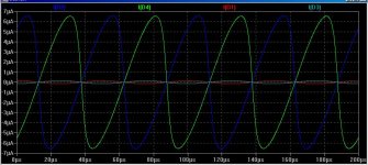

Hi Glen,
Very, very impressive. Do you intend to build that circuit or it has academic value only?

On the extravagant biasing current sources / mirrors. These are based on THAT arrays, SSM duals and discrete hybrids. This may look over the top, but with 0.01% tollerance emitter degeneration resistors, it's an easy way of generating temperature stable, highly accurate complementary biasing currents, to a fraction of a percent, without any need for trimming.
One thing that I should have also mentioned in my opening post on the folded-cascode "VAS" linearity, is that, for minimum distortion, the "VAS" current needs to be defined by a constant current source, not a biasing resistor.
Otherwise the Vbe variation with signal current of the folded cascode transistor becomes a de-linearising factor.

Hi Glen
Have you considered adding resistors in parallel with C1 and C2; perhaps 470K or 330K? This would reduce open-loop gain (increasing distortion), but would extend the open-loop bandwidth to 20 or 30 kHz.
Assuming that distortion is more objectionable at high frequencies than at lower frequencies, it seems to me to be of questionable value to pursue lower distortion at low frequencies than at high frequencies.
On the other hand, there may be a benefit in terms of sonic "naturalness" if the characteristics of the amplifier are consistent throughout the audio band.
With distortion around the ppm mark, I doubt it would be audible either way, so perhaps it's more of a philosophical question ...
Any thoughts on the above?
Regards - Godfrey

so...there are some authors calling for buffers before and after the VAS. The Hawksford paper (J10) refers to base currents and the alpha factor as the cause of base-collector distortion, advocating a before-buffer cure, apparently originated from the misconception that the BJT is a current controlled device.
Actually, the main cause of the Vbc nonlinearity is the reverse transfer capacitance, which should be principally attended to.
I recently came across this article: Distortion in power amplifiers, Part III: the voltage-amplifier stage | Audio DesignLine
Now I know where the often cited bewildering statements come from.
For me, reading Self is not love at first sight, I have major trouble reconciling myself to his views. Also, building audio amplifier theory upon LTSpice distortion analysis is just not a serious approach. All kinds of distortion should be taken into account, THD is not a universal measure of goodness.
For instance:
And so on...

Hi
The effect of the THD dropping with frequency is a function of the open loop gain roll-off, and does not represent any trade-off made in terms if high frequency THD. In fact the opposite is true - a resistor loading the VAS to provide a 20kHz open loop bandwidth would dramatically increase the distortion throughout the entire audio band.
The level of distortion here definately isn't at a perceptible level anyway.
Also, a VAS load resistor to kill the loop gain would also dramatically reduce the PSRR at the lower frequencies (ie mains ripple).
Gee I missed this while in China, I need to catch up. In any case on the SSM parts no need to spend your overtime money.
