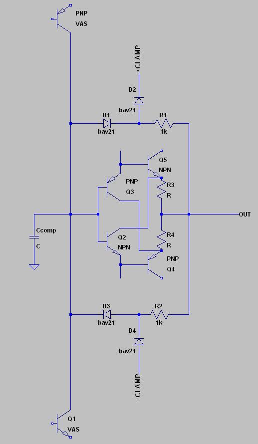

Here is a simplified diagram of how I buffer the VAS and implement a bootstrapped anti-saturation VAS voltage clamp.
D2 and D4 are the clamp diodes proper while D1 and D3 are the isolation diodes. D1 and D3 are bootstrapped by R1 and R2, having their A-K potential maintained at 0V until the clipping point at which either D2 or D4 become forward biased.
This effectively isolates the non-linear junction capacitance and leakage currents of the clamp diodes from the sensitive VAS node.
That was just a simplified schematic to demonstrate the bootstraped clamp operation. However there are issues to overcome.
When the diamond buffer is called upon to deliver current, a voltage drop is developed across one of the output emitter resistors (R3 and R4). This means that the output voltage of the diamond buffer will be either slightly higher or slightly lower than the input voltage to the diamond buffer.
If the load current is sufficient, this will cause either of the bootstrapped clamp isolation diodes to become forward biased, thus loading the VAS.
The trick to avoid this issue is to run each bootstrapped isolation diode with a small (a volt or so) reverse bias. Later when I have the time I’ll export my Protel schematic showing the non-simplified VAS buffer and clamp circuit which achieves this (and also increases the operating voltage of the diamond buffer input transistors with a biasing voltage source at the input, between the transistor bases).
Glen,
in my humble view, there´s no need for this kind of trickery, it is unlikely to work as intended and is aesthetically displeasing.

decorating audio amplifier designs with a bunch of nonlinear diodes is a bad habit. Saturation distortions will arise long before that simplified anti-saturation VAS voltage clamp starts acting.
