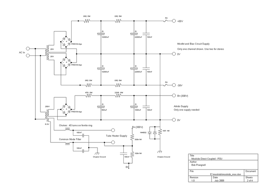

Actually I've found the best way to do earthing is like this : Use the normal practice of star earthing all the electronics. But don't connect the star earth point directly to the mains earth.
Instead use a pair of back-to-back diodes, in parallel with a 10R resistor, then connect the mains earth (and any other metallic chassis parts). You can see what I mean on this circuit diagram, which shows an amp power supply, but also is the power for an aikido. It's located at the bottom right hand corner.

FANTASTIC, I think I have a pair of 4002's in my junk box, it's full of goodies.
The 10R I think I have leftover from the unused bits in the Aikido kit.
It almost looks like the back to back diodes create a sort of half wave....maybe so only DC has ground and the resistor is for ballast?
OK, I have the pot rewired to the input and the ground modified with 2 diodes and a 10Ω 1W resistor.

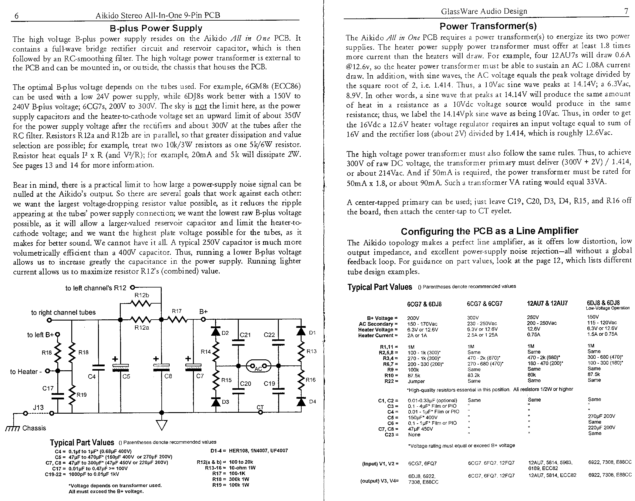

Reading through the manual here says that with 6CG7 (what I have) at 300V (What I Have) at 1k cathode you get 26mA.
It was suggested to run these tubes at 10mA each.
The manual says to run a recommended 470Ω on the cathode for my 6CG7's.
At 300V B+ what am I getting for cathode current?
I'm not understanding this formula in the manual for cathode current.

Looking through some other threads I see that others are having a low frequency motorboating issue from power supply instability.
Should I look at using the 240V tap on my secondary instead of the 220V and use a higher dropping resistor value?
