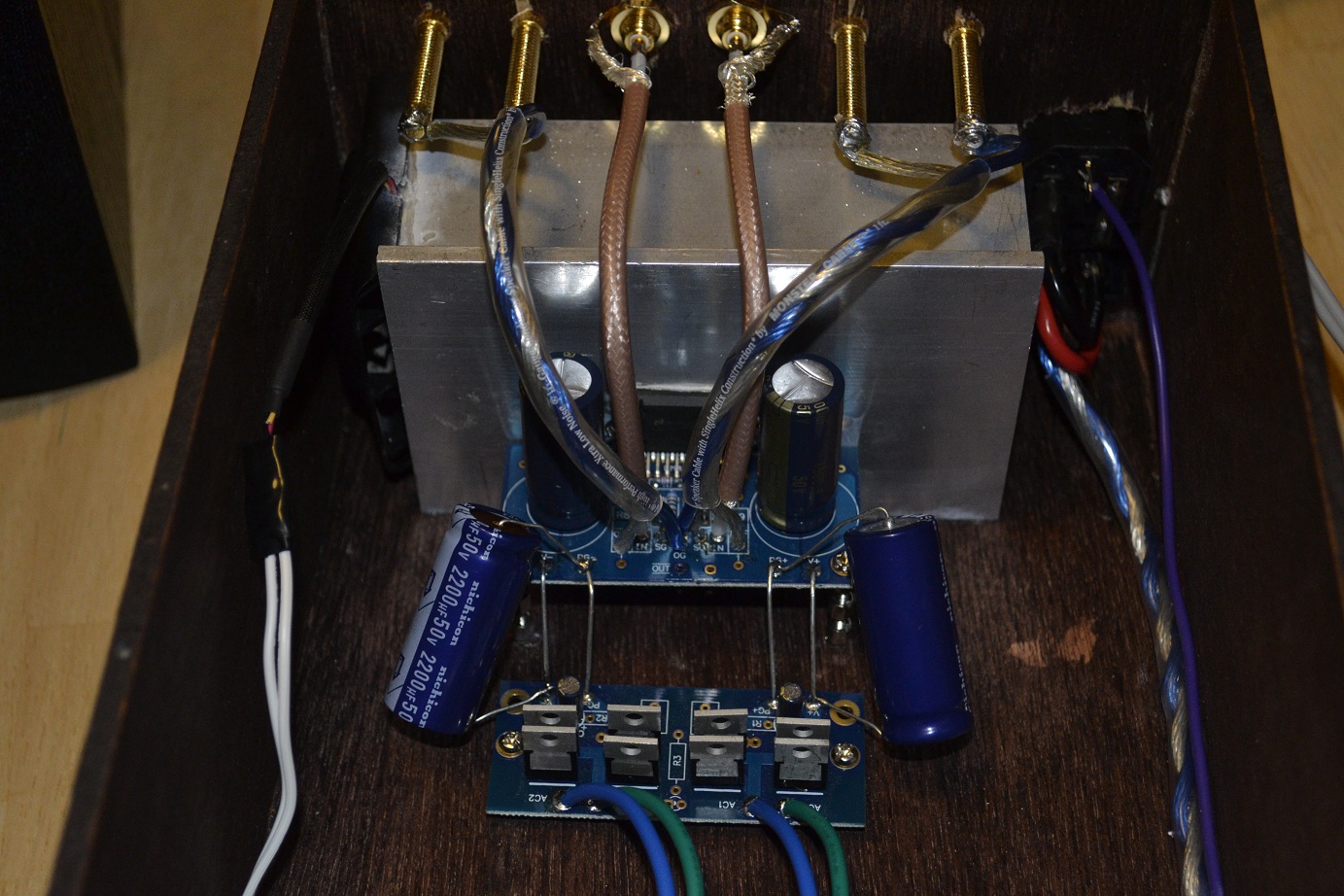

Woofer moving issue : OK the reason your woofer is moving is because some DC is getting to the woofer. As the power amp is DC coupled, any DC on the input will be amplified.
So first thing I would check is this : Is there any DC voltage at the preamp output? There should be absolutely none. The output is capacitor coupled, and it's connected to ground via a 1M resistor.
Also, with the preamp turned off (and left to cool down so no PSU voltage left), measure the resistance across the output. It should read 1 meg ohm. That's the value of the resistor that connects to ground.

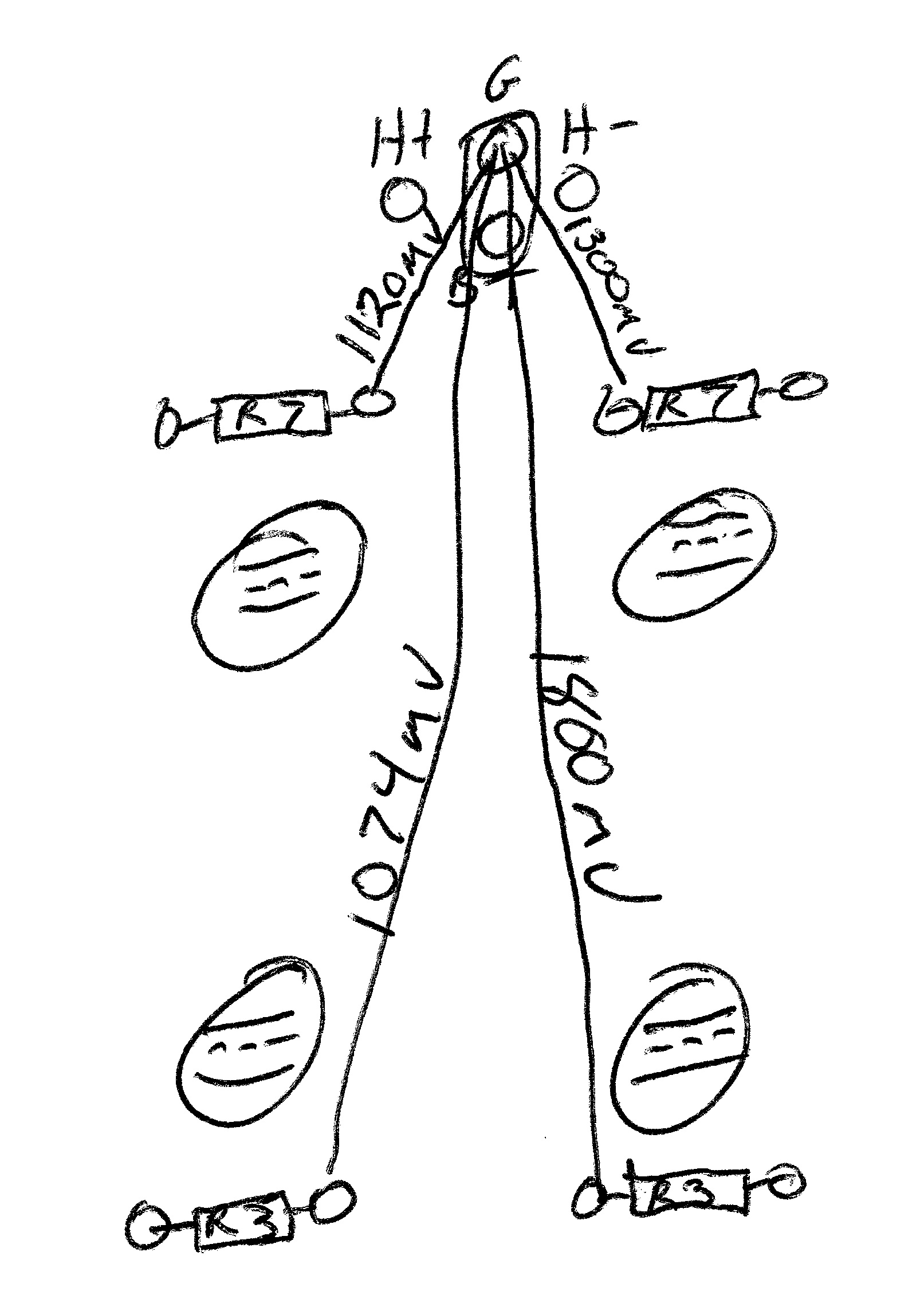

How (exactly) do I measure the voltage you need to know.
I know this must sound dumb but when I make measurements from either side of those resistors to ground I get little to no voltage.

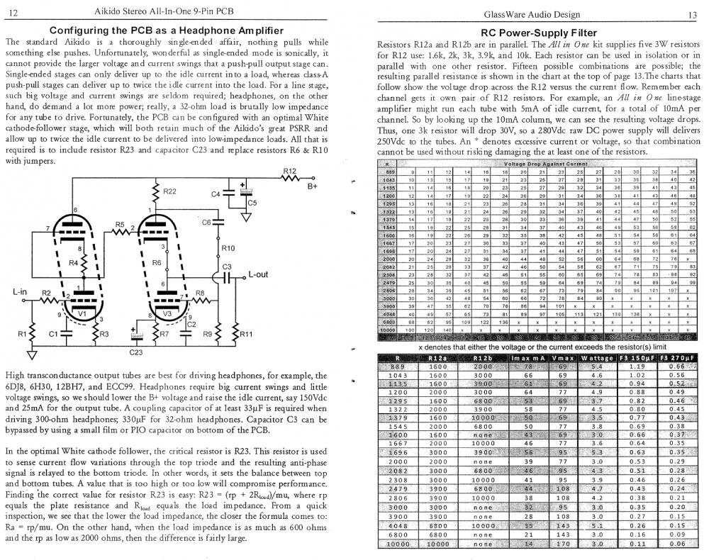

The circuit diagram you have posted there is called "Configuring the PCB as a headphone amp" and shows the normal output stage converted to a White Cathode Follower. Note that in your circuit, R22 should be a jumper (ie 0R) ,R10 should be 83.2k and R7 should be 470R. And C23 should be omitted.
Assuming that you have built the standard aikido circuit and not the headphone version, the cathode resistors are R3 and R4 for the first stage, and R6, R7 for the second stage.
1000R is OK for the first stage cathode resistors. For the second stage you'd want 470R
To measure the voltage across the resistors is simple. Put one multimeter lead on one end of the resistor, and put the second multimeter lead on the other end of the resistor. You should see about 470 x 0.01 = 4.7V across the resistors.

I merely posted that picture because it was the only diagram in the book that showed the R3,4,6&7.

Not sure at the moment. I was trying to work out if the basic parameters of the circuit are correct. For instance, what value are your output tube cathode resistors. You said that your input tube ones are 1000R, but I'm not sure what the output stage's are.
OK then we need to know the voltage(s) across the resistors, so we can check that you are getting the right current flows.

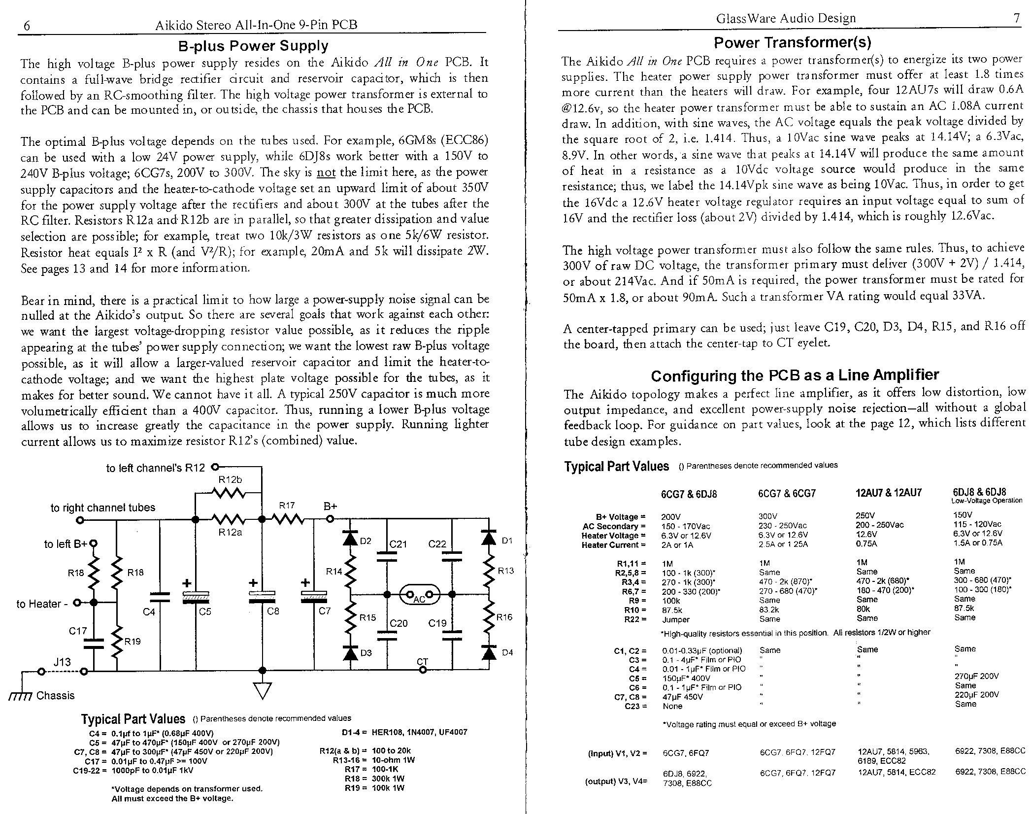

OK, I noticed in the manual it says that you should use the highest value dropping resistor.
I'm using the 220V tap on my transformer and I could change to the 240V tap and use more dropping resistor.
Or....Maybe I have a bad capacitor???
How can I help diagnose this power supply problem?
