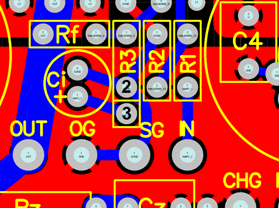

Alright i have a quick question about the circuit...
If I add an attenuator should I leave out the input resistor of 22.1k?

Q #2: What is this CHG pad for?

llmobll,
1. If I remember correctly, you can take it out if you would like, I'de go ahead and leave it in there.
2. I'm guessing your looking for chassis ground. Make a star ground from your two boards to the AC ground on a single point on your chassis.
