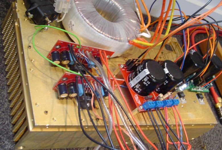

Finished up my first 3-channel gainclone. There is another identical one in the works.
http://www.whatisrazar.com/gainclone1.jpg
http://www.whatisrazar.com/gainclone2.jpg
http://www.whatisrazar.com/gainclone3.jpg
