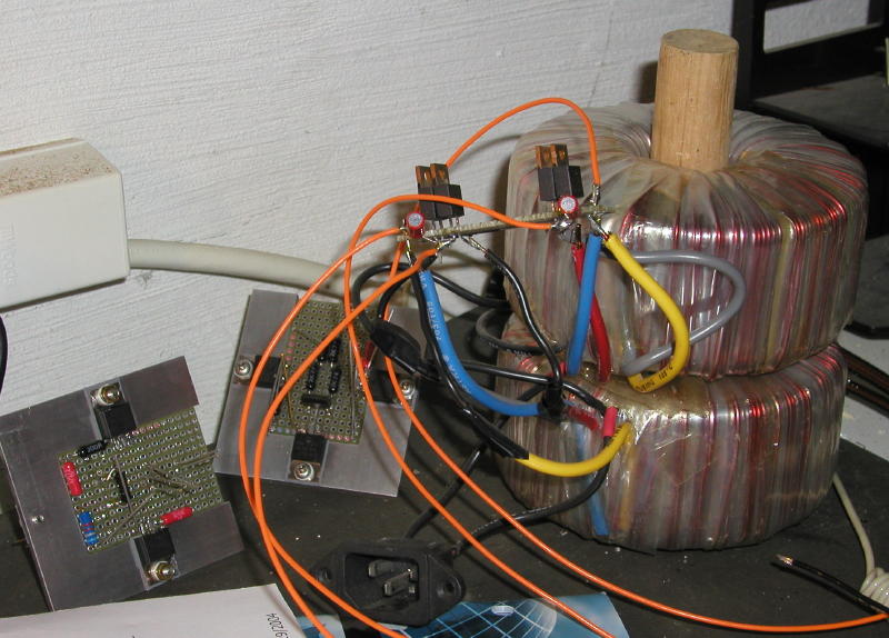

Actually I tried both. The EI transformers maybe weren't the best quality, but they looked definitely well made, with flat magnet wire. They were definitely worse sounding than Plitron.
In the pic is my setup for your second suggestion (made also with Plitron transformers) it sounded slightly different than a single toroid, I thought it was better, but only marginally. I did those tests almost a tear ago, so it may be a good idea to refresh my memories. Maybe this time I will come to different conclusions😉

Peter Daniel said:Actually I tried both. The EI transformers maybe weren't the best quality, but they looked definitely well made, with flat magnet wire. They were definitely worse sounding than Plitron.
Peter,
You always impress with the breadth of stuff you try. I should have known you'd already tried these things!
An EI transformer should let much less junk come through the AC than a toroid. There must be other factors that come into play.
If you try the full wave / two transformer idea again, try a snubber at the transformer secondary and also a couple of small (47nf) caps from the secondary +/- to the CT (which is GND in a full wave circuit.) I think this will provide some benefit without interacting with the PSU caps on the other side of the diodes.
I'm going to try your 100uf BG N caps tweak as soon as I place my next order with MP or Parts Connexion!
