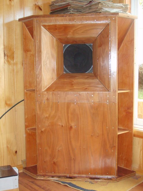

Yes, the Autograph is coherent and natural; a "point source" transducer that is a well deserved and relaxing reward for the tired warrior's afternoons.
There is nothing like horns to reproduce life-like dynamics. This Tannoy enclosure has a mid-bass that is punchy and articulated. What cannot be transmited through the camera is the ampleur of the soundscape...

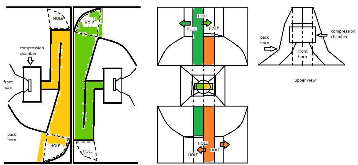

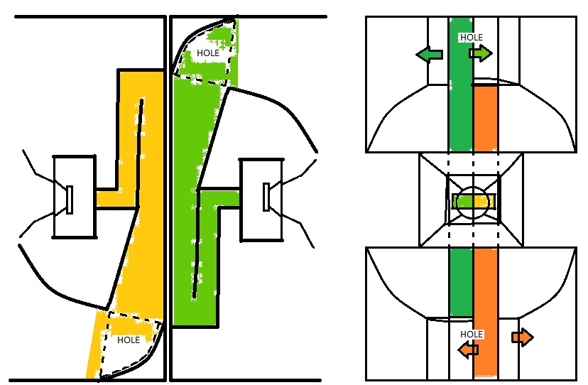

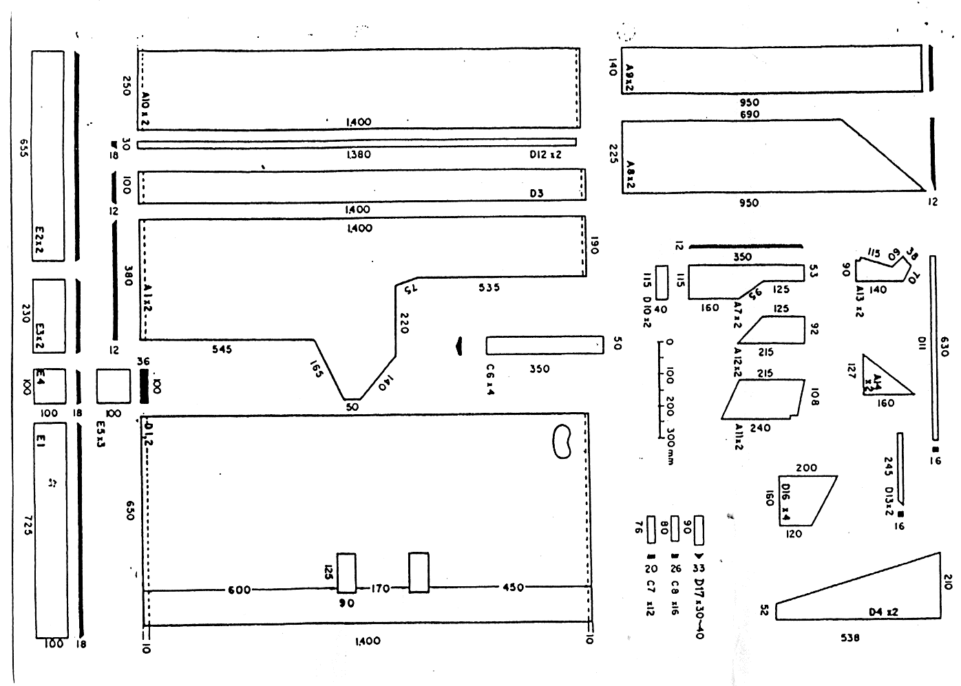

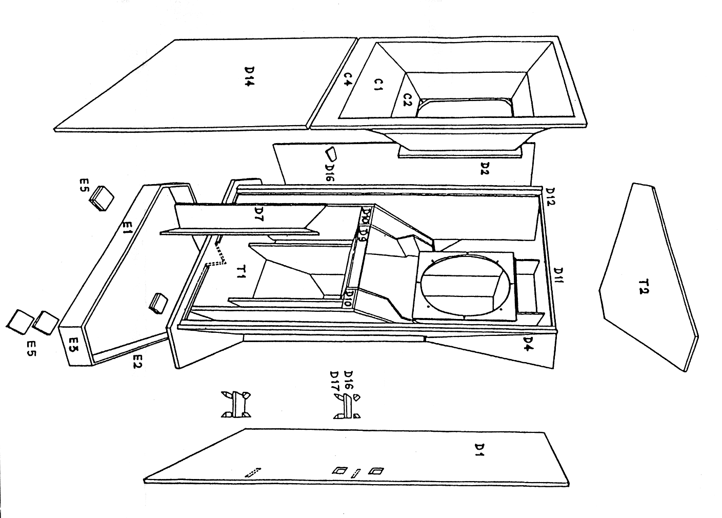

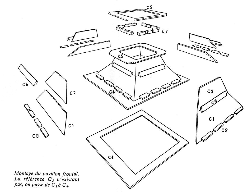

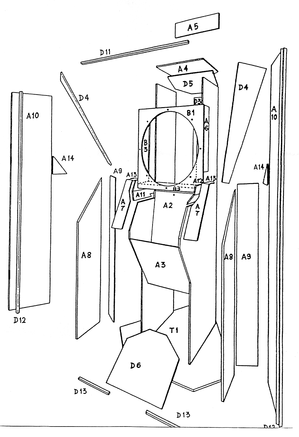

Look. This is a "transformer-like" evolution of the Autograph, but which can be placed anywhere (not corner loaded, in principle). The good quality plywood sheets measure here 2.2*1.2m, so I guess 2.2m is the height and 60cm the depth...😀 We need three of these to make the core. This is a folded rear horn, split in two, mirrored horns: one goes down and the other goes up 😉
A hole must be done in the panel to allow the horn to be completed.
The front horn is not indispensable, given the driver. Absence of front horn (present speaker with only lower bass horn) makes the speaker disappear, litterally. 😎
I will chose AN super10, so the front horn will be there, probably.

Sorry. Little mistake on the drawing. This is better, with upper view:
I'm dumb
more graphic info , please ........
Well, this is no place for the mentally challenged, my dear...

Why did you build Autograph and not Westminster? Is Autograph harder and more elaborate than Westminster?
Hi Veeman,
GRF Autograph is better. Period. 😀
IF you have good corners, this is the way to go.
Corner loading is quite magical for bass reproduction. That way HF, midrange and bass are better integrated into a "wall of sound".
Integration (of the electric and acoustic crossovers) is the key word.
If you listen to Autograph v/s Westminster you will feel what I mean and you will notice that W. sounds leaner.
Corner speakers have a hidden advantage: High WAF as they use less real estate in the room.
Also, if you build a fulranger, corner loading is essential. You can't make a bass loaded horn FR too big...
