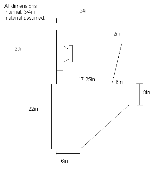

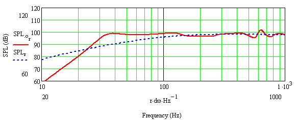

I did the attached example for a 15in Monacor PA driver last week. It's good for 100db 1w / 1m to 35Hz, with an F10 of ~24Hz before room-gain is factored in.
I'm staring at this... thinking it is kind of an upscaled compression chamber.
How WIDE is the cabinet? I see every dimension on the drawing but that.

Aaaarrrrggggghhhh! It's not a compression chamber! The room is the compression chamber of a back-loaded cabinet! 😉 (See my post on the previous page.)
Anyway, the box is 19in wide, internal. FR plot of this cabinet attached.
IMPRESSIVE!
