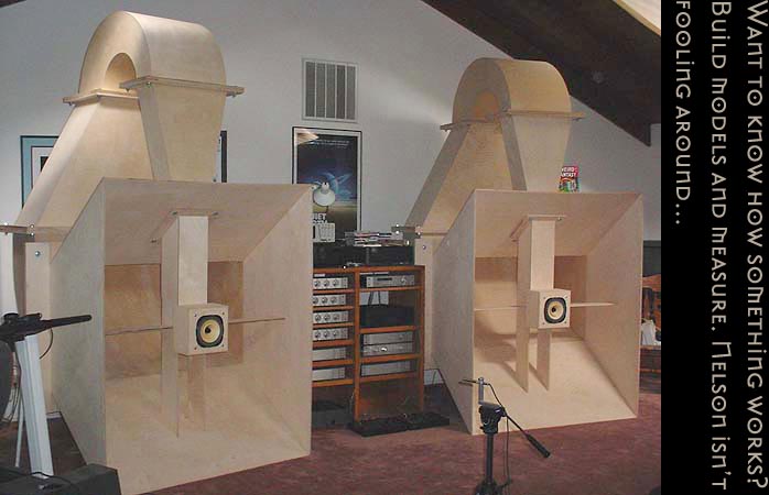

have a look at Nelson Pass' rear loaded horn. It has only one long radius fold but takes up a bit of space (like warehouse sized space).

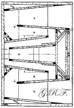

Thanks Qi, that was an answer for a now deleted post.
Hi JRKO,
I was about to post this on my other thread...
For non-perfect rooms, three options:
1) as you mentioned put the speakers on long axis wall. The sound (HF) change a little if you are closer or farther than the focal point but not too much. Bass should not be a big problem given the nature of Autograph's bass, but bass traps/panels would help if any boom appears.
2) put wood panels on the sides of the speaker, prolonging the rear horn.
3) modifie the rear wall with nice woodwork with high WAF 😉 as with second option.
Last 2 options as per my drawing wich is not to scale. Only for orientation:
A denotes Autographs (or other) and blue lines represent modded rear wall or good looking wood panels. 😎
What do you think?
M

Hi JRKO,
Sorry about WAF 🙁
You should read the opinions about sound comparison between Autograph and GRF corner, wich has only rear horn (I think GRF rectangular can't better it), here:
http://users.on.net/~richard.norrish/Autograph/
Rick's page has trully excellent photos.
Hey Qi and JRKO! I found an Autograph Pro rectangular tribute page with upper view:
http://www.ominous-valve.com/big_spkr.html
My rectangular adaptation looks easier though...
I may still have my Autograph plan on my PC, I'll see.
http://melhuish.org/audio/horn.html
Lenght, throat to mouth ratio and shape all influence sound and Freq. response. Too complicated to me, that's why I prefer a proven design.
For other Tannoy options see:
http://www.hilberink.nl/speaker.htm
Goto "cabinets, DIY and design Info"
M

Maxlorenz!
It is just that the compound folding in your Autograph (and the Westminster) is much more complicated / developed.
The GRF and rectangular Autograph have the much simpler / less developed flair. It is really an expanding pipe -- not a horn at all.
PIP's 3d rendering (albeit corner-horn) shows the same flair development as the rectangular Autograph you referenced.
That was my only point.
My preference is the more complicated compound flair -- as in yours -- as does the reviewer on Richard Norris' site...

if the area is square (vertical as well as horizontal) then you have constant expansion.
I think the vertical section shows a much larger expansion giving an exponential or something close.
But either way, they are horns.
Nice try but, no no no...
The flair I posted is all you get.
The top and bottom panels are parallel giving no additional flair.
Once again -- an expanding pipe...
I am not asking you to post a design on the Forum.
I am saying that the Autograph has a vertical section that tapers more strongly than the horizontal section shown in your post.
If you estimate the cross sectional areas at various distances along the horn you will be able to see that the expansion rate is either constant or varying.
If the area doubles with each increase in distance from the throat then it is exponential.
If it only increases but does not follow the doubling rule then is is something other than exponential. Faster increase is moving towards hyperbolic and a slower increase moves it towards conical.
The flair I posted was to prove MY point -- not yours.
My position is that the flare rate of the GRF is SIGNIFICANTLY less than on Mauricio's corner Autograph (and on the Westminster).
They expand on the horizontal AND vertical planes.
The GRF expands only on one plane making it look more like a TLINE
But, of course, this is my opinion.
Each to his own...
