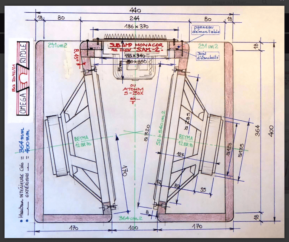

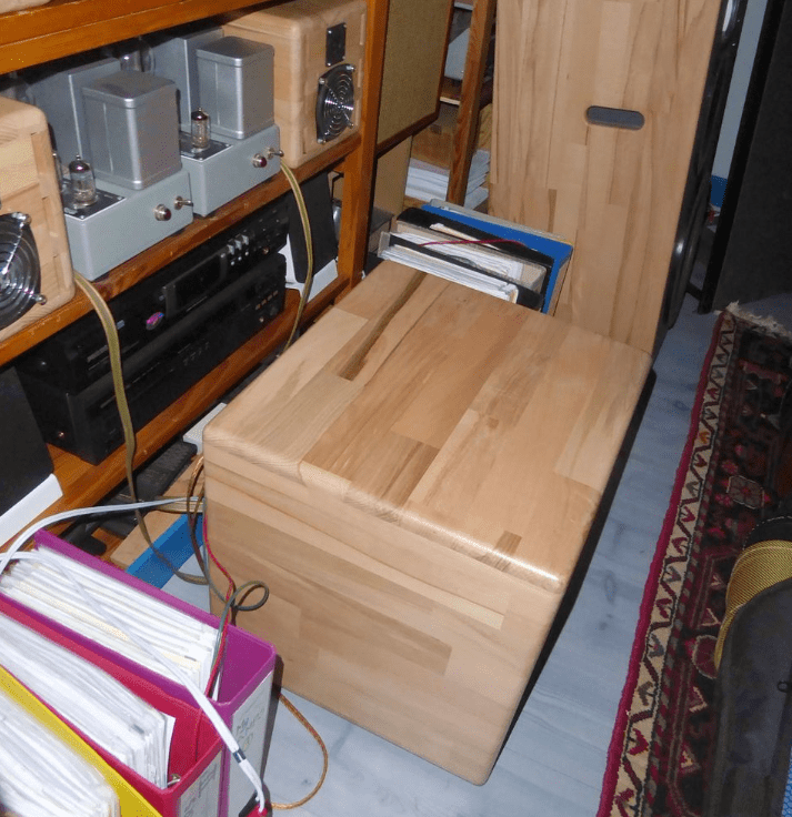

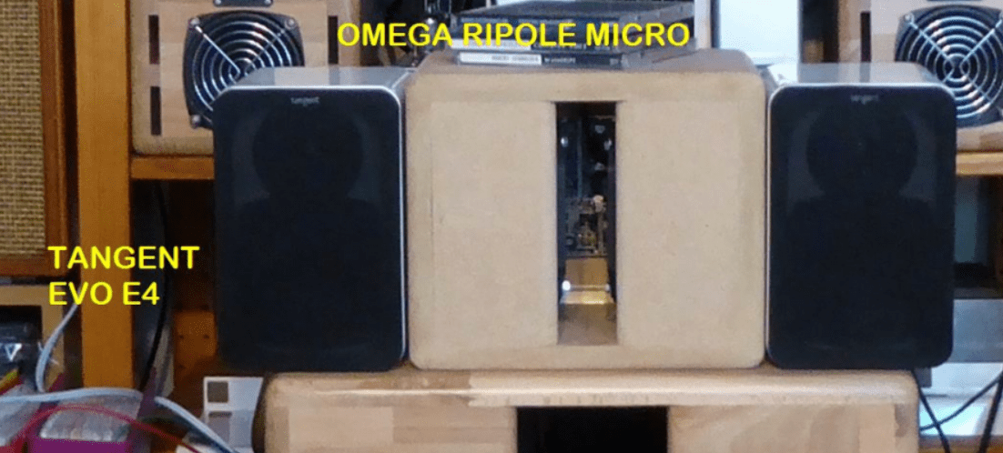

Not amazingly convinced by the tone quality, I tested the Ripole Subwoofer, as described and patented by its creator Axel Ridtahler, a German acoustic engineer. Here's the general principle :
And here's my take on the subject : the Omega Ripole.
I even declined it in smaller versions for testing :
The only issue on these smaller versions was to find a quality compact integrable subwoofer module, and it's where I failed : I found none...
Other than that, the performance is very interesting : very low, deep, floating bass extension (think 10Hz below the resonance of the speaker), no boxy sound at all, swift impulse response in attack and decay, amazing compactness...
The only drawback is the reduced efficiency, which is circa 6 (2 spkrs) to 10dB (1 spkr) under the nominal efficiency of the speaker, and if you are not listening to the loud usual earthquakes, explosions and thunder from the Home Theater, but simply music, even quite louder, this is easily compensated by the subwoofer module.
T

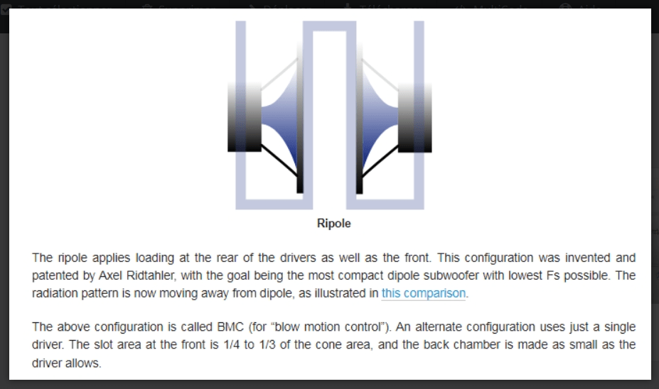

Ripoles are good as nearfield subs. They give directional bass and can be tuned quite low. Few people have the luxury to put two speakers right at their seat though. I like the smallest one in your picture. It may be a good idea to put it on top of a regular sub and measure the polars.
Yes. According to Axel Ridtahler, the Ripole offer an even front dispersion of 90°, but with a minimum of pressure level placed perpendicularly, that is to say at each L and R sides of the Ripole. The ideal position of the Ripole is centered between the speakers, with some distance from the wall to free the back openings.
But as you note it, placement speaker is not so ideal for most people, and subwoofer placement is often in an angle of a wall, somewhere in the room, where a discrete place is available... This is usually fine with BR and sealed SW, but not premium for Ripole : that's a drawback too.

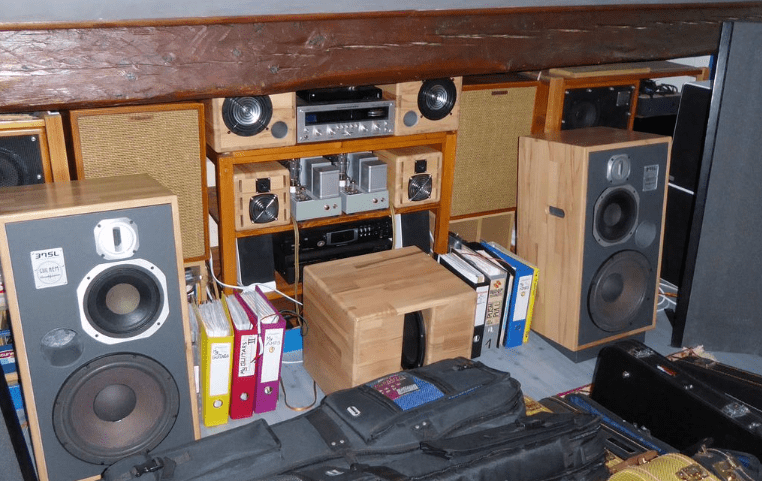

I tested successfully my Omega Ripole Micro with this configuration below :
The result was amazing : a deep, natural bass extension to 25-30Hz was possible for such a small setup, without any boxy sound, BUT the SW module was the serious one used on my bigger Omega Ripole 2x12", used here as a stand. And it made all the difference...
With the small SW module originally intended for this Micro-Ripole, it was merely catastrophic : LPF frequency and slope setups possibilities were poor, and therefore, the result was simply awful in comparison... That's why I abandoned this project, otherwise, it would have worked very fine !

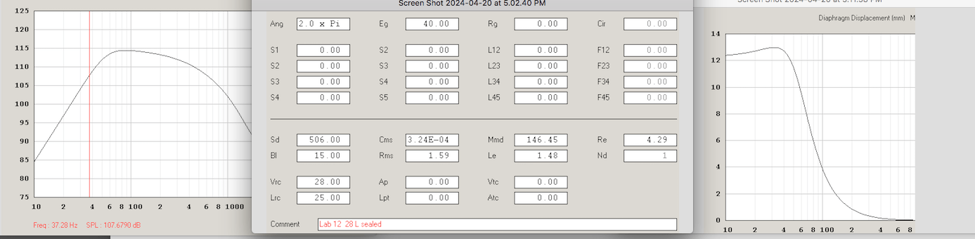

I built subs with an Eminence Lab 12 driver in a sealed 28 liter cabinet, with calculated F3 of 37hz. The sound quality is excellent. I think I paid $250 (usd), so a bit out of budget....but I think most drivers with a cast frame will exceed the budget.
While designing, I found there were not many drivers that would achieve low frequency in a small sealed enclosure, atleast not without a lot of DSP. I wanted the "natural" response to match my target.

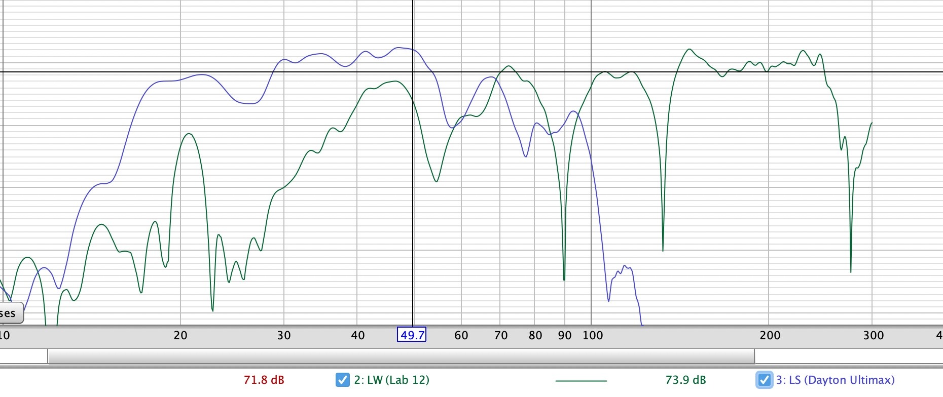

I have built lots of different subs using LAB12s, and measured their response.
28L is a tiny cabinet for a LAB 12. At 37Hz it's response is ~-6dB, F3 closer to 47 Hz.
I've found Hornresp simulations to match the measured response quite well.I would do less reading and instead spend time with a simulation software! I like VituixCAD.
I don't want to contradict you, because I was lazy and I didn't re-do the simulation when I posted that. But I did glance at my measurements of the cabinet I took recently. I was playing with the subwoofer integration. Despite these spiky traces, the combined result was quite good. (Lab 12 is the green trace, measured from listening position).
But yes, it is small. The only reason I made it so small is it is part of a 4 way speaker, and I was struggling to keep the overall size under control.

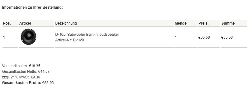

Probably you are right. I tested pricing for smaller 165, it was smth like this:
I bit weird pricing practice, and I still did not understood 53.93EUR is for the D-165i woofer + postage + VAT?
OK; to explain: €34.99 is the speaker including VAT
Then, there are two different ways to calculate postage at reck.com. I take the one from the German website, which seems the new, increased price and is
€15.50 + €0.95 per kg (the small woofer is 3kg).
Everything gets more expensive here.
So you got a total for 3kg of €53.34 what is what you have to pay for it, delivered to your door step, no extra cost.
This contains 21% VAT, which makes €9.26
Price without VAT, only important for commercial working people with customs registration, is €44.08. They pay the VAT in their home country. In Lithuania this is 21%, just like in Germany. So nothing to win doing a complicated customs declaration.
You are a private person, so in the EU you only pay the VAT of the delivering country and NO VAT in yours!
The 10" woofer will cost you 6x €0.95 per kg + €15.50 + €89.90
