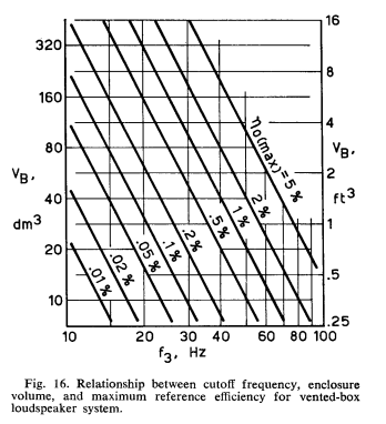

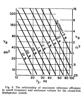

Hofmann's Iron Law: low response, efficient, or small-pick two

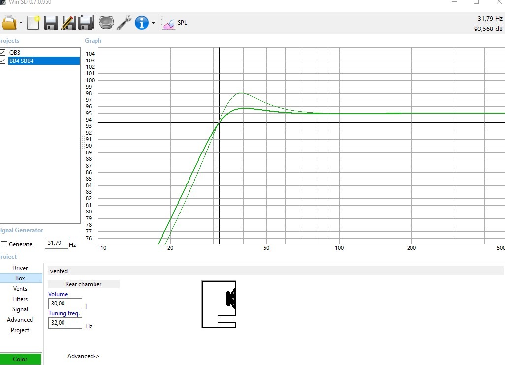

With WinISD I get this result:
MFCL45-4
Vented, 40L box, 38Hz tuning, vent diameter 10cm, vent length 33.3cm.
Vented, 40L box, 35Hz tuning, vent diameter 10cm, vent length 40.6cm.
Vented, 30L box, 35Hz tuning, vent diameter 10cm, vent length 56.6cm. Attached
WinISD shows cone excursion limit at this tuning is ~25Hz at 100W.
Seems too good to be true. I made mistake somewhere in driver parameters or WinISD is not suitable to calculate boxes?
GM,
From your pictures I see that:
Vented 30 Liters, ~36Hz, 0.5% efficiency
Closed 30 Liters, ~36Hz, ~0.3% efficiency
Does that mean, that I will lose Watts or just that the slope of the closed box is not suited at all without DSP?
In other words: vented box is the only option with simple plate amplifier in reasonable size able to play low Hz?
