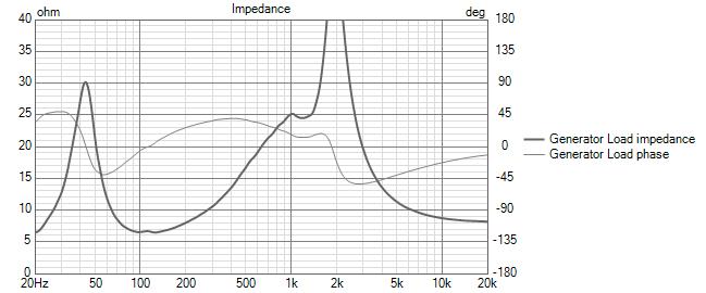

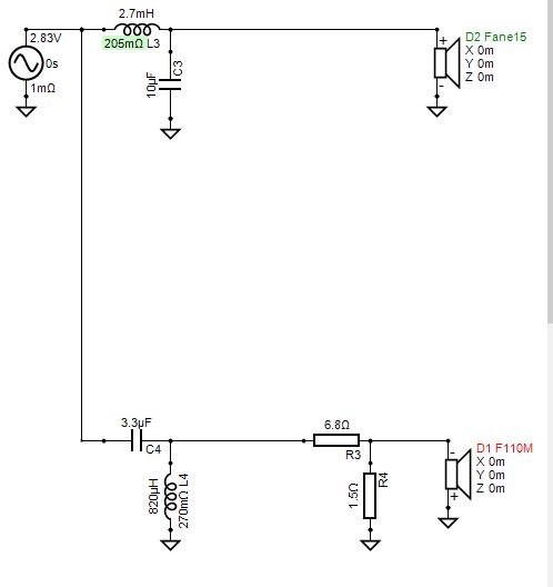

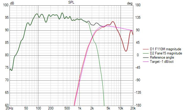

I traced the the curves for the woofer and the compression driver and put together this XO. I used the diffraction tool on the woofer and just the raw data from the compression driver because I have no idea how to model the horn. Here is the XO, obviously there needs to be measurements to get this right, but it looks like a fairly simple crossover might be possible. Is the huge impendence spike at 2kHz is the resonant frequency of the compression driver?
Thanks, I was just about to do the same!
seems so.
in addition the "linkwitz riley" low pass with the thread starters values creates a 2 kHz resonant peak.
Also a combination of 20 uF series cap and 75 uH parallel coil makes the impedance drop to near 0 ohms at 1,5 and 5 kHz. Kills the amp.
The impedance drops to 0 = dead short.
Look at the peaks in the electrical transfer function. What you are looking for is a smooth roll off in most cases.
When we talk crossover slopes and orders we refer to the final acoustic slopes not electrical. That is placing 4 components doesn't create a 4th order LR. It's the acoustic / final response of the driver that must follow the 4th order LR to be called that with 360 degrees phase rotation
Reactions: stv
suspect that the horn will change both the frequency response and the impedance of the compression driver. Until you can measure the driver on the horn I would ignore the spike. I have no experience with horns so I will leave it to others to explain what is going on.

Ah so the name of the crossover refers to the electrical response created rather than the components used to create it?
Well sort of.... the name of the crossover = driver in box response + crossover / filter applied. that is - your LR4 at 2KHz would be what the final response looks like for the driver - allowing for all the crossover manpulation. for a woofer already rolling off, a simple 2nd order electrical (coil and cap) may be all that is required to reach the LR4 target.
In otherwords - you may not need a 4th order electrical filter (2 coils and 2 caps) to get a 4th order LR response.
I prefer to call the order of the crossover components the "electrical filter". It alone has it's own order when allowing for driver impedance.

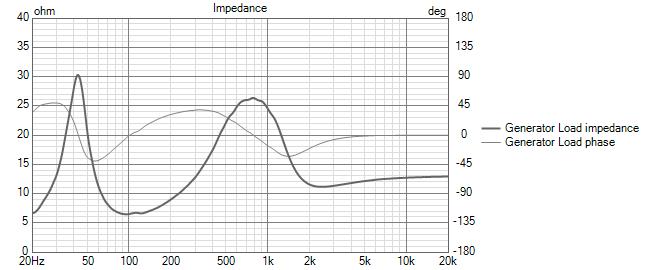

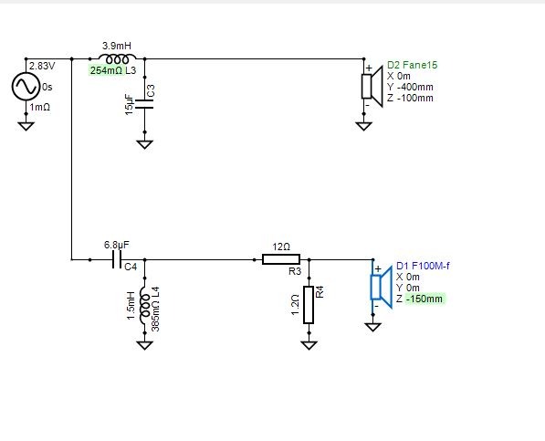

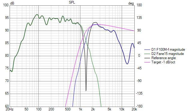

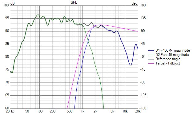

I was bored today with no internet so I made a second attempt at an XO. This one has a smaller impendence spike, a better null with the tweeter reversed. The driver offsets are just WAGs so take this for what it is.

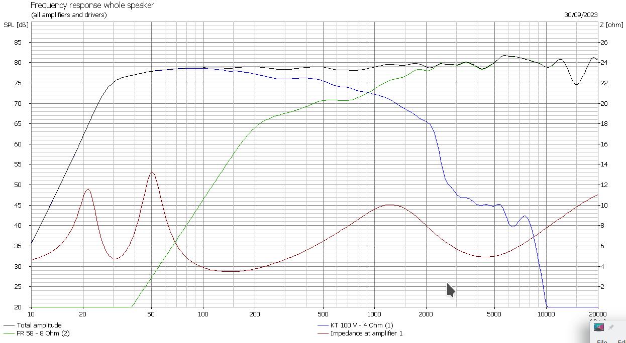

An F3 of 30Hz is rather low for a 100mm driver. Max SPL due to xmax is ~78dB. Not enough really so don't take the numbers seriously. Max drive at ~50Hz is ~3vrms.
😉 I bought these drivers - really it's best to do the design firts. They may be ok with an F3 of 40Hz, almost bound to be at 50,
