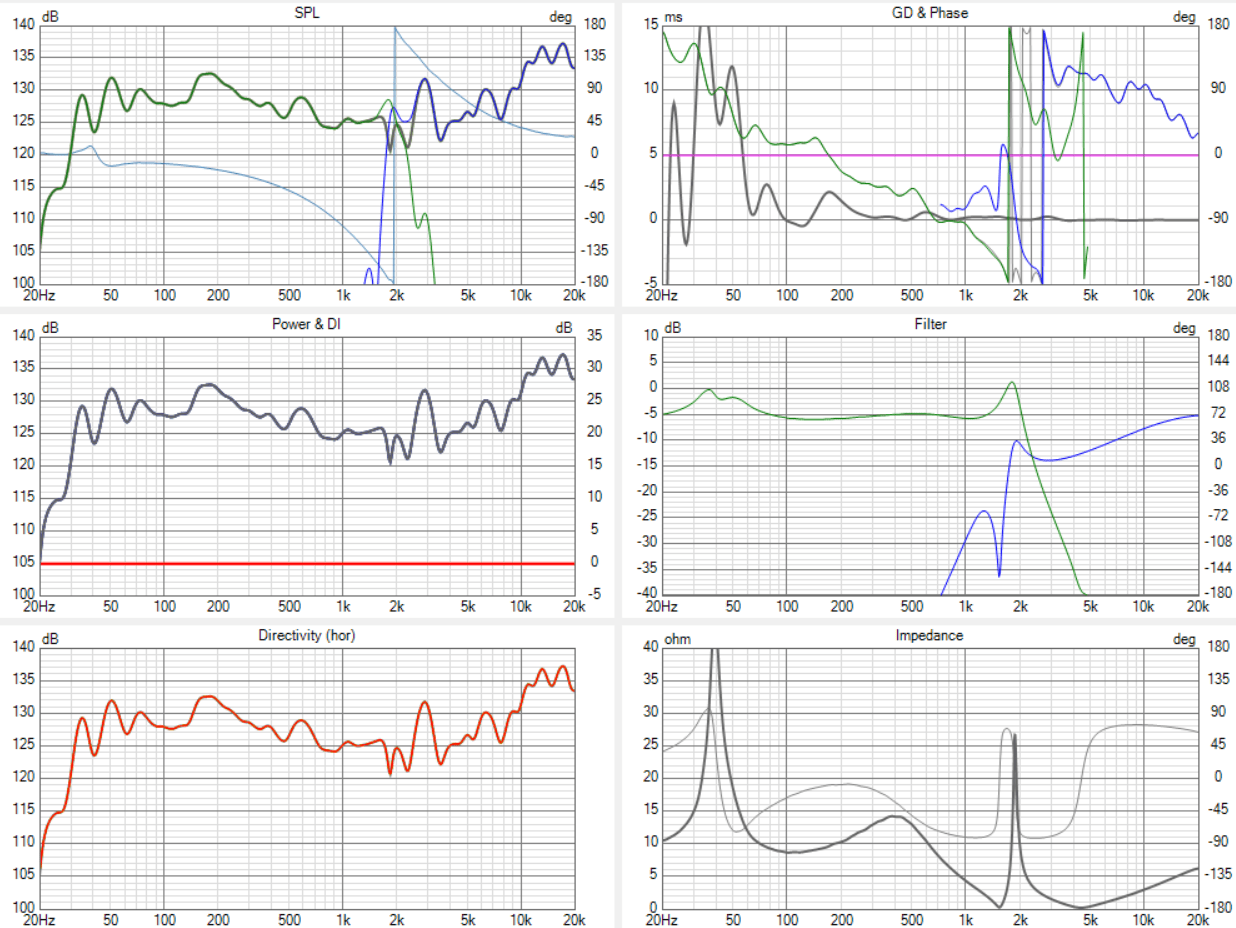

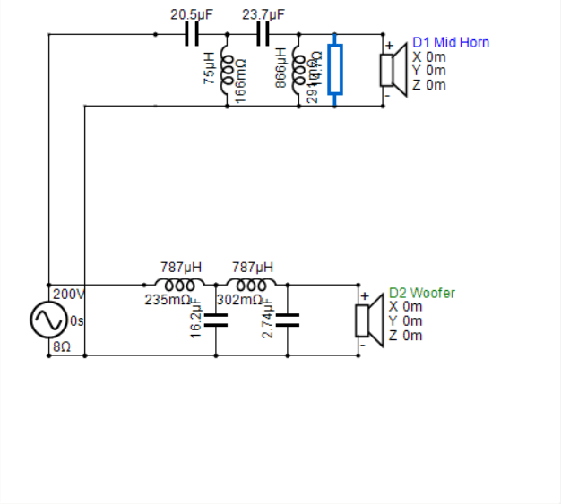

I've had another go at making the crossover! I decided a 4th order linkwitz-riley setup that I found online as I liked the crossover value of 2khz for the drivers that I am using. Here are the results:
I'm quite happy with how the SPL curve came out although the high peak around 2-3khz isnt ideal. I think this may be resulting from the impedance spike around the same point. Im going to attempt to add an Lpad onto horn driver to correct this and make the higher frequency response flatter and more level. Any more pointers on how I can improve this ciruit are always appreciated!!

I wouldn't be.I'm quite happy
It's a bathtub response with +10 dB top end. It will not sound good.
The 2 kHz peak will hurt your ears.
The "found online" crossover does not match your drivers (mainly impedance curves, i suppose). That produces peaks of both woofer and tweeter at 2 khz.
Again, you need to gain some crossover developing skills (not just use the simulator).
Otherwise use an automatic optimizer.

This causes further spikes in the spl gaph and changes the phase slightlyWhat happens if you flip the polarity of the tweeter?
I mean I more happy with the progression through the process rather than the results I've been getting, I'm aware non of the circuits so far have been very well developed or able to produce good quality sound but it is somewhere to start! I'm currently searching for articles online about passive crossover design so that hopefully my next circuit that I upload isn't as much of a shamblesI wouldn't be.

The better way is to reduce the output so there isn't a spike at the crossover. Rather what you have there is a combined response reduced by the phase being greater than 90 degrees apart. This makes the spike (or equivalent) happen off axis instead. The spike energy may manifest as a room echo.This causes further spikes in the spl gaph and changes the phase slightly
