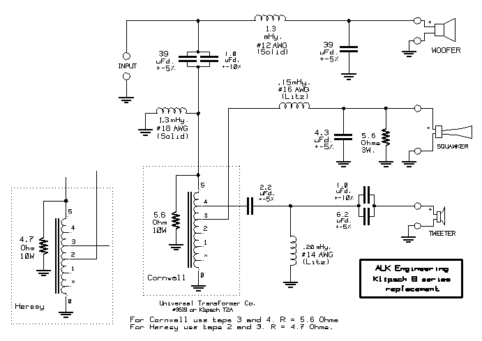

One more question, please. In the ALK schematic Marcus posted, and I'm attaching again here...The caps and resistors I have. The autoformer gets reused. The inductors are all new. How should I wind these? I see to use solid wire for some (magnet wire right?), and Litz for others, but I'm not sure how large of a gap to wind them on, or, if other types of cored inductors would work as well.

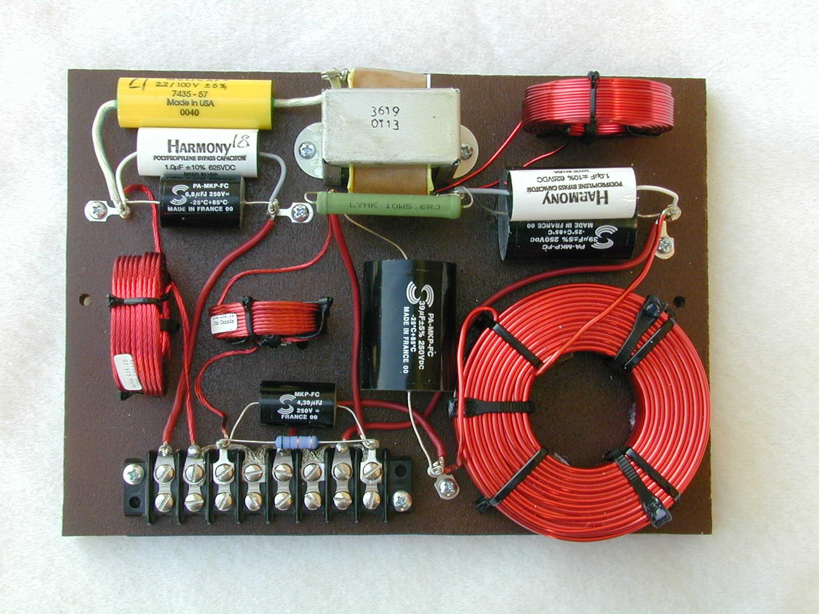

The ALK crossovers typically used commercially available air core inductors, like those available from Parts Express, for example. Litz wire can be a beast to solder unless you have a solder pot.
Here's photo of an ALK crossover:
Inductors likely sourced from Solen (as are all the black caps).

Awesome that does it. Thank you both. Spent an hour and a half searching...holy cow they've gotten expensive. Surely better to wind my own, right?. But everywhere I looked for enameled wire was about the same at $45-50 per 100ft 12ga enameled. For the 12awg 1.3mH alone I'm looking at about 240'. Anyone have a suggestion, maybe somewhere to shop in bulk? Or, would it likely be OK to use insulated wire with the thinnest jacket I could find?

Other than the use of a parallel resistor across the autoformer, I'm not a fan of ALK's crossovers. All his measurements were voltages across resistors...unrealistic. His woofer filters were based on his thoughts that the inductance of the driver should be subtracted from the woofer inductor. A type E2 has a 4mh series inductor followed by a 33uf shunt capacitor. Above he somehow determines that the inductor should be 1.3mh. IMHO that crosses the woofer way too high. Litz inductors are a waste of time and money...again, IMHO.
Mboxler- Agreed all the inductors can be solid wire, the litz wire seems like some "audiophile trick". I'm also wondering about that one feeding the woofer, as there's no reason it should have to be 12ga. wire just to support up to 100w. I was looking at a chart yesterday and I think even 14 or 16awg should be plenty large enough to handle all the power these could ever take anyway, and definitely enough to handle any tube amp they'd ever be paired with. But as for value I didn't think it was too far off. Original in these type Es is 2.5mH, but that's without the parallel cap at woofer. I figured 1.3mH was what worked because ALK took that parallel cap to 39uf (and that there I could probably use one of my many motor run 40uf caps. Still need to find a good source for winding my own either way. Thanks,

As another point of reference, E2 Crossovers used 4.0 mH and 33 uF on the woofer. There are other reasons to use larger gauge wire than just ultimate power handling. Too much series resistance will effectively destroy any damping factor your amp may have.
I agree...12AWG is overkill and expensive. In fact, ALK moved from air core to iron/steel core woofer inductors a long time ago.
When one moves from a first to second order low pass, the inductor value must increase to offset the lower impedance the shunt capacitor creates at lower frequencies. Otherwise the FR of the woofer will overlap the FR of the squawker.
