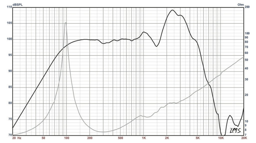

Very nice efficiency, but what about that 2khz - 10db peak ?
It doesn't look like it can be unnoticed..

Interesting, TRaskutis, but i have to be very honest I do not audibly notice it in my present set up, not yet anyway. If you read my above posts I did mention that there was a lift in the speakers upper range when I first heard them and it seems therefore I was very accurate in this audible assessment. However, in the set up as it is at present moment, I am using two of these speakers in series and also (forgot to mention) that I have added woolfibre into the rear of the chassis, not to mention various other factors associated with the room placement ,air support, open baffle board positoning etc etc. Shame I have not got measuring tools. However, I think throwing graphs into this assessment defeats the purpose, as I am only intertested in what my heart and soul gains from the music heard.... numbers will always only play a smaller role in my assessments.
