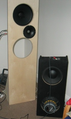

My first open baffle speaker
This probably constitutes an ancient thread, but it's the first one I've found that is directly related to my own project. So, I write for those who may be on a similar journey and will find this thread.

After so many years out of audiophile-land I am making my way back with my first speaker build and, as it turned out, it's an open baffle design. Actually no-baffle or naked/nude baffle, whatever. At the moment the drivers are solidly mounted to a frame (not a baffle board) but will soon enough find themselves suspended from the frame. Right now, though, the task is to get the drivers to work together and give me the tone I'm looking for.
Where I think I got lucky was finding Trans-Fi Audio and the coupled dipole - two woofers firing face to face and in push pull. Pretty much the Celestion SL6000 configuration. I found Vic at Trans-Fi while looking at building a Bastanis Mandala clone - hence the Eminence drivers. I'm using twin 18 inch drivers that are currently running full range. The dipole coupling reduces the higher frequencies giving it a natural acoustic rolloff. Already I have a full bodied sound to complement the Betas (I'm aware of the dipole peak etc and will tackle all of that later).
The second part of the solution is bi-amping, where I'm able to manipulate the balance between the big woofers and the Betas. The final trick is the use of an old Sumo Electra preamp and it's tone controls. Of course, whether this stays in the system or not has still to be decided. But I must say that I have achieved a milestone. This system, as it stands, is neither an audiophile product with the requisite neutral and accurate presentation nor is it a bottom of the pile sonic mess. Rather, it is a system that provides incredible dynamics, plays ludicrously loud, sounds like it has a turbocharger attached, has intricately detailed vocals, richly resonant piano (my reference) and, most surprisingly of all, plays any type of music you'd care to throw at it.
Synergy is everything. The Betas by themselves suffer in open baffle guise. Even the Bastanis Sagamartha Duos came in for some stick over their lean midrange. Ok, they don't use Eminence drivers, I believe, but the design hasn't changed. Godzilla loved the Betas, but he bolstered the bottom with Alpha 15s crossing over higher than 100Hz, which is where Bastanis cross over. I'm suggesting the Alphas put more harmonic body into the music.
