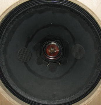

Done some more experimenting. Rather rare in my experience to see 12" drivers have their dust caps cut out and replaced with a plug.
Well I literally pulled off the dust caps from the Eminence 12" drivers, with great ease and no apparent damage. I played them like this and they had subjectively lost a lot of the midrange,e.g voices sounded very thin and bright. So I lowered the tweeter freqency crossover to 4uf and the midrange returned once more but still clearly had tonal abberrations, the worst of which was sibilance in the treble, which seem worse than before the surgery. Time for these phase plug things.... Added rdc cones into the holes and this absorbed so much of the enegy that it sounded dull and lacked dynamics. Replaced these with aluminium cones and boy did I get a surprise. In very simple subjective terms, I had my original sound back before the dust caps were removed but with the treble edginess and sibilance gone, much more obvious smoothness to the mid range , giving voices a more realistic feel to them and thereby improving their presence factor. The cymbals now sounded so much more sweeter and more solid sounding then the shrill lighter sound before. The lower midrange also had the feeling of being fleshed out which added to the overall more natural warmth to instruments and voices. I will never be able to do an A/B comparison for obvious reasons but every track I listen to just seems so much more real, relaxed and natural sounding now.
Some of you will think that changing the tweeter crossover might be the major factor, well let me tell you i have played with the crossover time and again, up and down like a YoYo before these latest round of mods, and the treble sibilance, lack of midrange and lower midrange warmth was never achievable in the way it is now.
There is no doubt the woofer dust caps were contributing to the midrange sound I was initially enjoying before being sacrificed.

I have made headway with that midrange tonal colour/timbre/warmth thing.
Messed around a bit more with those round tabs. After much experimentation i discovered that a lot of that shouting and midrange tonal thinness was due to the woofer paper cones and had nothing to do with the tweeter. By adding specific sizes and specific numbers in specific sites i was able to dial in a much improved tonal quality to the midrange and much needed warmth, the hollowness is now pretty much gone, there is hardly any treble uplift and the shouting thank god is no longer noticeable.
Let me stress you need to add ONLY TWO of the 4cm size tabs (other sizes have less favourable effects), and they only work best placed at the mid point of the radius of the cones at opposing ends. I would say the changes are dramatic in subjective audible terms, possibly one of the most dramatic of all the tweaks I have made.
