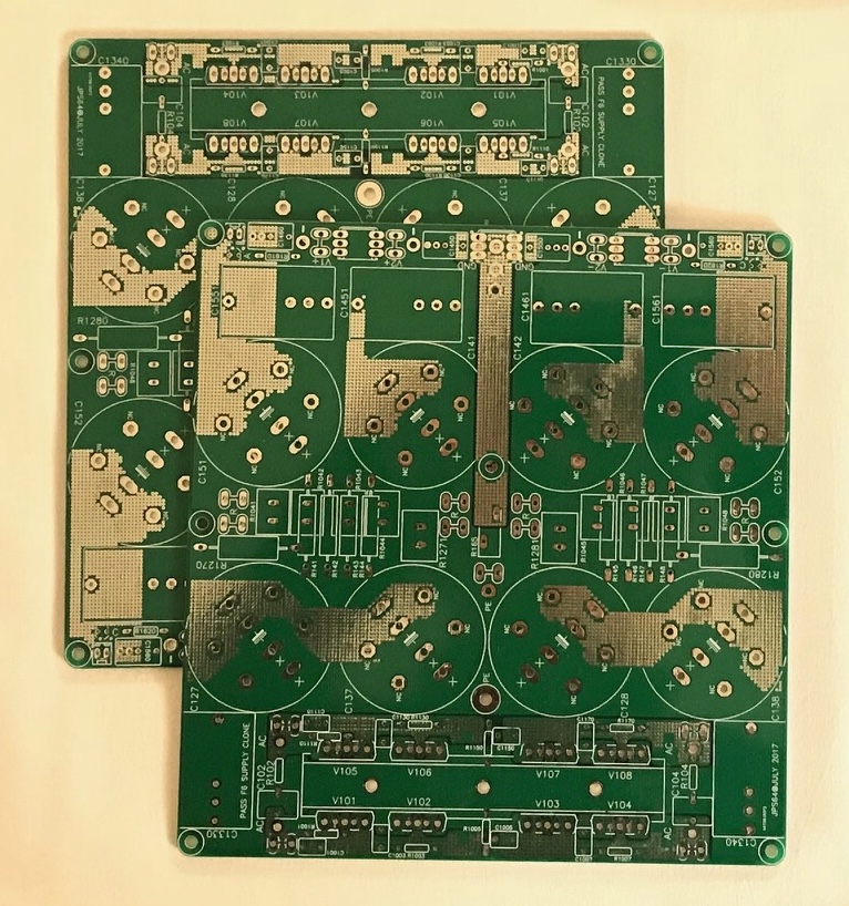

Hello BK,
for the power supply I´ve used Fischer Elektronik SK492-100mm.
But you could use drilled 12mm thick alu rail?!
JP
Thanks, JP! I have not been able to source this in the USA, or without a large minimum order quantity via europe. Seems like an aluminum piece is the way to go. If anyone has a USA source for SK492 please let me know - still the most elegant solution.
BK

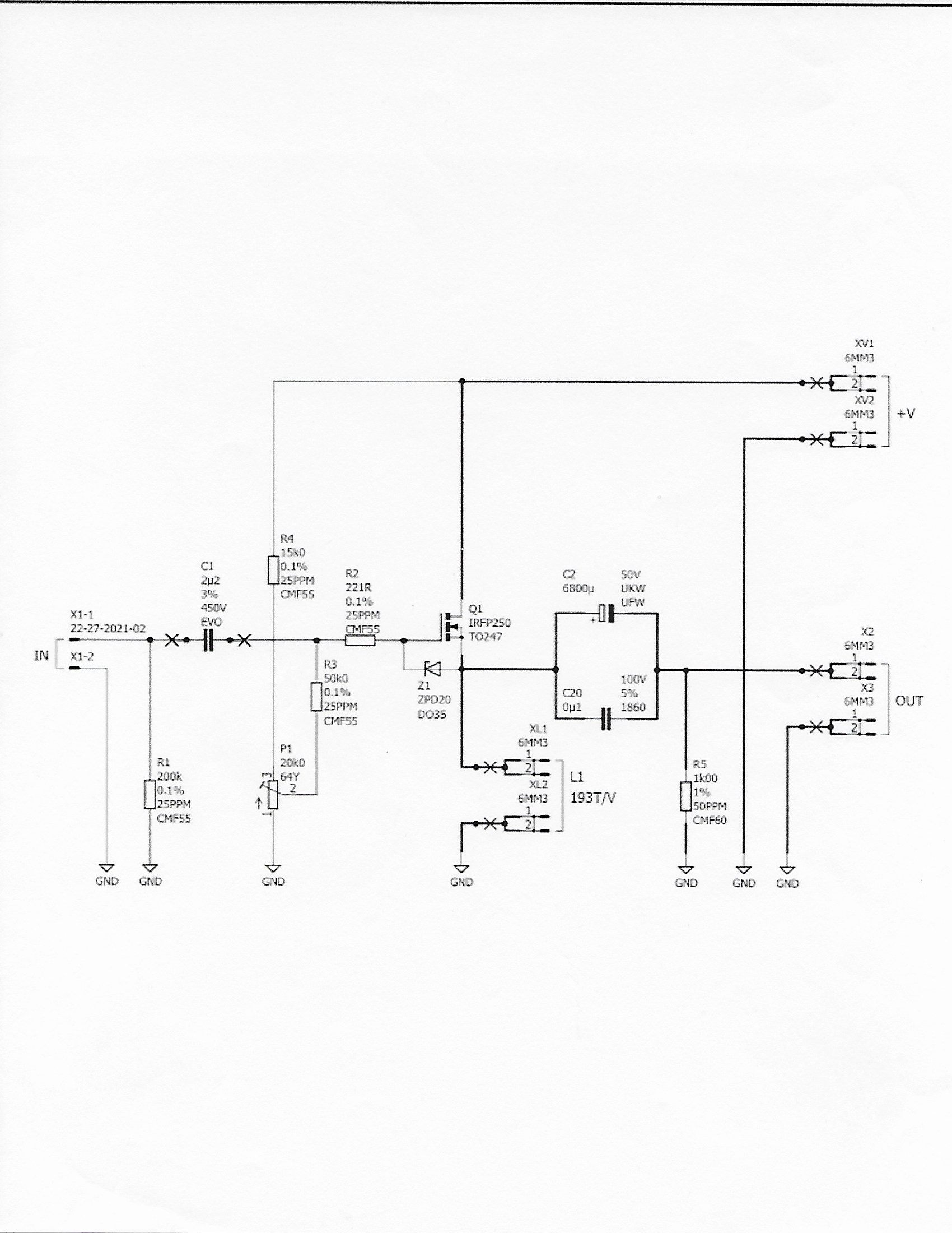

Hi JPS64,
Do you have schematics for your MoFo board? Getting ready to populate it 9will pair with SLB SR PSU and Melbourne SMT preamp board) - probably simple enough to guess but... better if there is already a schematic. I think others may be interested in your MoFo board as well...
Thanks,
X
