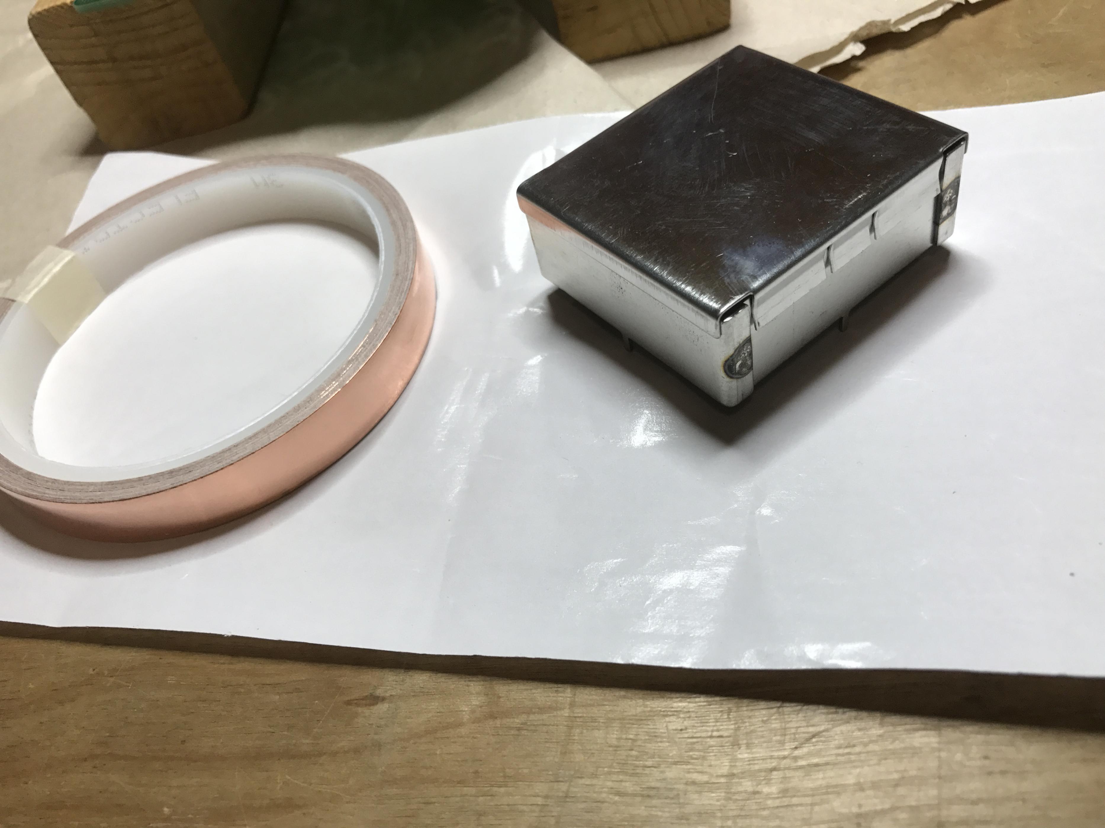

Beware of the need to magnetically shield the signal transformer on the M2 to get good results. Otherwise, intolerable hum from EMI pickup from the mains power trafo to the small signal trafo. You can spend a lot of time matching FETs etc on M2, but it is all for naught with hum from EMI. Need mu-metal shield box or locate power trafo outside main case, or use SMPS PSU. That's my experience and for me, too much hassle so M2 is now out of the big Class A case for another amp,
I have copper foil to make a belly band (Gauss band) for the little Edcor, and a steel Teko 3710 case (JP has designed the PCB to fit this case) for magnetic shielding.
attachment.php
Let's see how it goes ... :)

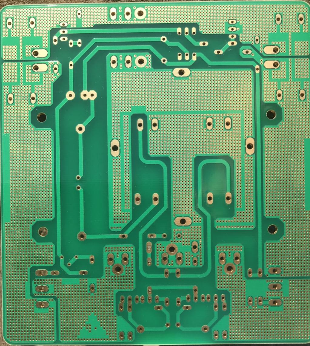

M2 Schematic resistor names need swapping
Just an update from my side:
I haven't started my build yet, still waiting for output MOSFETs and source resistors.
I did check the PCB thoroughly yesterday and found that, compared to the most current schematic that I have found (attached here again), the designations of two pairs of resistors need to be swapped to match the PCB.
This would be to swap the names of R114 with R125, and R113 with R122.
Maybe my schematic was outdated ...
All other designations, and all connections appear correct when I trace them.
Again, this is not changing the values, just the names, so that the names on the schematic match the ones on the PCB :p.
Hope this could avoid some confusion when populating the boards,
all the best, Claas

Thanks Claas, you´re right, corrected, see attachment.
I´m working on a small piece of copper for JFET thermal coupling, more to come.
I´m also working on assembling manuals for PASS HPA, ACA and M2. F6 still pending...
JP
  • DIY-NR002_002_SCH.pdf

Joined 2016
Just started up my first channel of M2 built on JPS64's boards. No problems in building it, and worked perfectly at first start-up.
I needed to re-drill and tap my heatsink, so it took me a bit to find the time (second one still to do).
I built it with Toshiba Laterals (2SK21530/2SJ201). So far, works very well, no issues with bias, offset, stability etc. Haven't listened to it yet, need to build second channel first.
One thing, probably coming from a resonance in the Edcor transformer: I'm seeing a small overshoot on 1 kHz and 10 kHz rectangle, has somebody else seen that ? (I should take that question to the M2 thread ...)
Thanks, Jean-Paul, for providing the boards !

Hi JP,
may I know what is the usefulness of these asymmetric PCB pads (don't know the exact name for it) as seen in the attached picture, I just want to learn, thanks.
ps. keep up the good work, I like your PCB designs, they are both artistic and professional!
