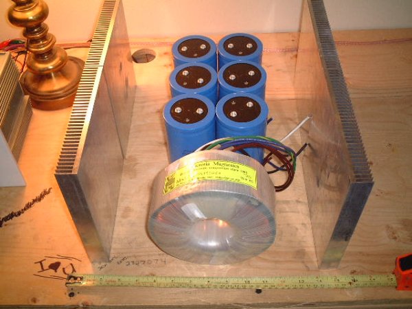

Well here is a picture of my layout for my aleph 2's im ordering my aluminum in a few days to start and finnish the chassis. Then to start Populating the Front end boards and the Fet boards then i should be done. So far i have spent lots of cash on these. They better sound good. : O )

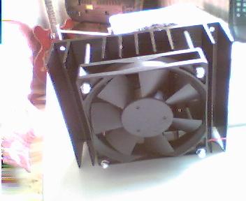

I´m happy to say that it worked exellent!!
I put the pieces together enough for a heat test and with both channels at full bias the temperature measured directly on the Mosfets reached 56 degrees Celsius!!
That was measured with the fans operating at 4V instead of 12 to get the noise down.
With fans turned of the temp. went far above 60 degrees within minutes.

Since that fan will move alot of air i would personaly make the fan run at a slow rpm that way the noise is low and it keeps it cool. Thus the good thing about havin a hug fan like that cool a small heatsink. ; O )..
Jason
Jason
I'm in good company then! The fans are actually running off about 5.5 volts. I have an adjustable regulator feeding them. Just not on the schematic, that's all. As a matter of fact, the majority of the noise is not from the fan blades at all now, but from the vibration caused by the square wave drive of the fan motor windings. It makes a brrrrrr noise at about 70 Hz or so. I once opened up one of those fans and looked at the voltage waveshape generated by the coils when the fan was spun by hand. It was more or less trapezoidal - square wave but with a very sloping straight line transition from pos to neg. I reckon if I could make an external driver to run it with *that* waveform instead of the normal square one it should be a lot quieter. Someday...JasonL said:i would personaly make the fan run at a slow rpm that way the noise is low and it keeps it cool.
