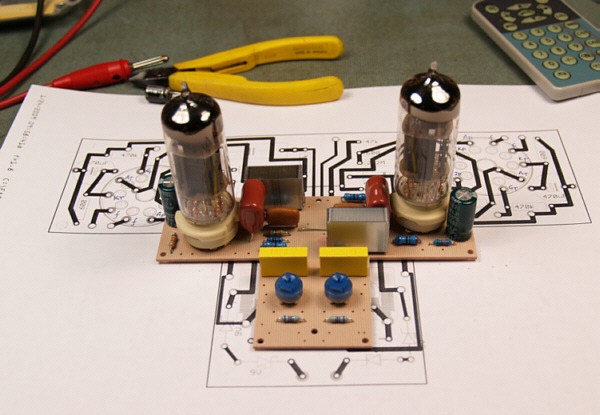

my choke loaded amp

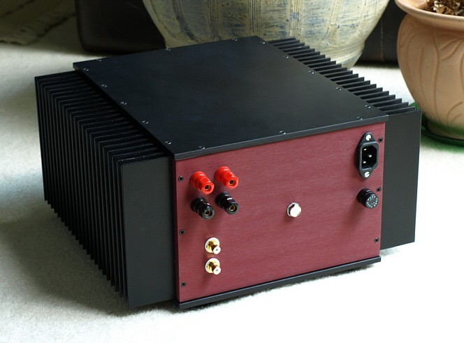

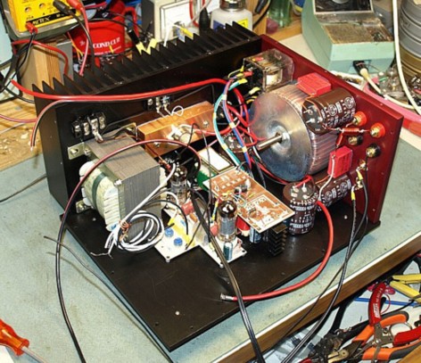

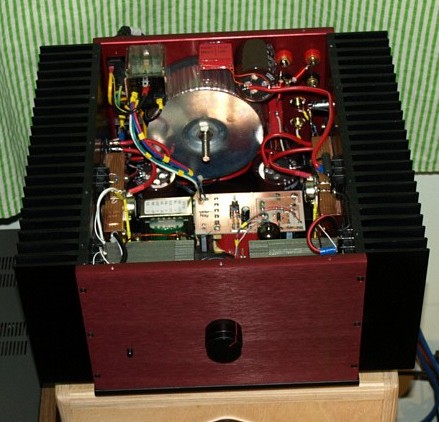

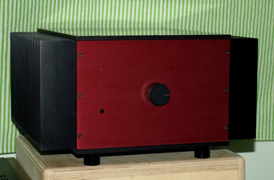

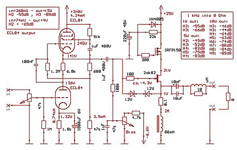

I wonder if I can add to this thread?
It took me two years to finish my example of this amp.
Everything is a hinder, getting the heat sinks, the panel's, the mechanical work ,the parts , brushing the aluminum parts and the anodizing. This is a simple amp made with a Russian equivalent of ECL84 which is the 6F4P as the driver and the 2SK82 vfet transistor, came off the ebay from a Singapore dealer. The general size of the amp and the heath sinks ,only support 10W/CH output, still the weight is up to 19kg and power consumption over 100W.
This is not a green amplifier. I will upload some pictures.
Miklos
Miklos

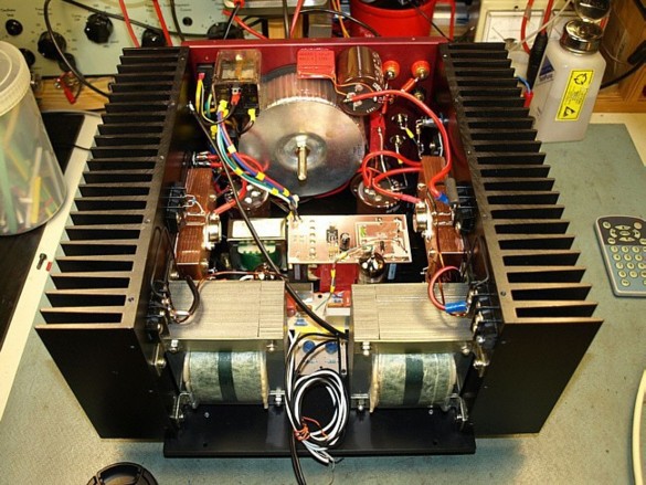

Another thread back to life!
Tyimo did you get your amp working?
Still seems we need a big core for these amps. Miklos can you move your amp without a forklift?
John
19kg, I can lift it, but won't walk far with it.
If one would use a powered sub ,than this amp could get away with smaller chokes.
