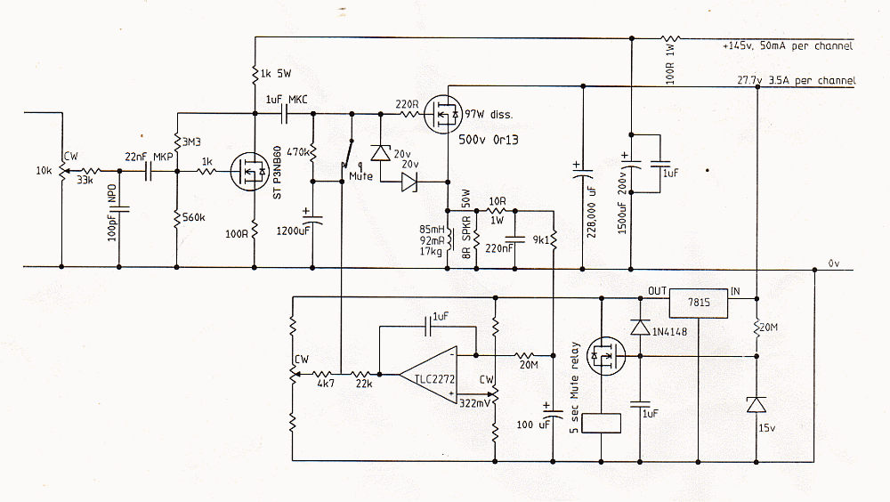

Amp cct.
In the first year or so the amp cct changed back and forth a little. Things like different feedback configurations, different kinds of drain loads on the voltage amplifier, bootstrapping etc etc. Anyway, here is what I finally settled on - remarkably like what I started out with actually. It has been *absolutely* reliable and the only shortcoming is that if you turn it off for 1 or 2 seconds then straight back on again, the bias servo amplifier goes full on... Not good. But she's pretty chunky so I just turn it off quick and wait for a minute till everything discharges properly.
Anyway, enough blabbing. Here's the cct. Nothing exciting to look at but after all this time I still can't hear any deficiencies in it.

It is really cool!
May be couple of diodes between input legs of OpAmp will help a bit?
Circlotron said:In the first year or so the amp cct changed back and forth a little. Things like different feedback configurations, different kinds of drain loads on the voltage amplifier, bootstrapping etc etc. Anyway, here is what I finally settled on - remarkably like what I started out with actually. It has been *absolutely* reliable and the only shortcoming is that if you turn it off for 1 or 2 seconds then straight back on again, the bias servo amplifier goes full on... Not good. But she's pretty chunky so I just turn it off quick and wait for a minute till everything discharges properly.
It is really cool!
