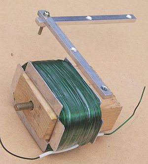

Righto. I wound one winding for my choke and it was a disaster. Wound it over a rectangular piece of wood and it was just too tight to fit over the core! Had a second try this time much looser and using less turns - about 120. Strange thing though, I measure the inductance using a bridge and it was 47mH, yet when I applied AC to it in 10 volt steps from 0 to 100v and graphed the current and impedance (*most* instructive) it averaged at about 80mH at 6 amps before the impedance started to droop as saturation approached. I used a 0.25mm sheet of plastic for an airgap. Anyway, it would have been quite good enough for an amplifier but seeing the winding space was only about half filled the temptation was just too much...
I got busy and made a bobbin for it out of aluminium. BTW, if you have a choice, use a tranny that already has a bobbin; it will make life sooooo much easier. One thing I made sure of was that the ends of the bobbin were insulated from each otherwise being metallic it would have formed a shorted turn.
As you can see from the pic, I used a block of wood with a bolt passed through the centre and the threaded end attached to something solid. The block is rotated by the finely crafted mil-spec handle. Bunged on 234 turns of 1.25mm wire, I did.

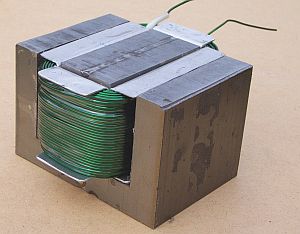

Now the wound bobbin goes into / onto the core. It was just a shade tight so I removed one E lamination. Using rather more sensible sized pictures now; average filesize 20-25k. Makes page load faster.
Ta-dahh!
Now the I section goes on with the 0.25mm plastic sheet between it and the E's. you can just see it sticking out a bit. Then I ran 2 amps through it to hold the I's down tight while I taped it together with ordinary sticky-tape. Even with only 2 amps running through it the magnetic force is unbelievable; I couldn't slide the I piece across pressing as hard as I could with both my thumbs. There was probably in excess of 100kg attractive force! Amazing for 2 amps. Given this version has about double the turns of the previous one it should be good for about 320mH at 3 amps.
See? Now there is no excuse for not using chokes. You have a virtually unlimited supply of suitable transformers in old microwave ovens.

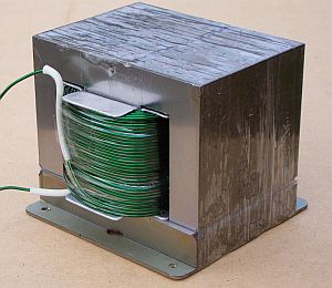

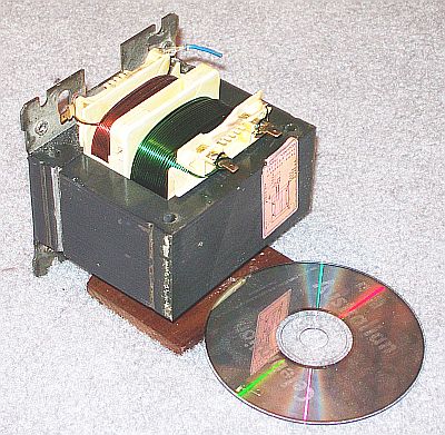

Chokes are easy-peasy compared with an output tranny. Look. Tonight I rewound another one of my microwave oven trannies, this time the one with a bobbin and wow! it was *HEAPS* easier. It should be good for about 350 mH or so at 3 amps. Just a matter of fiddling the turns and/or the gap. The whole thing from go to whoa was about 1-1/4 hours work. Once you haver done it once you will never look back. Just make sure you use one with a bobbin. You can see in the picture I left on the 240v winding because this has 1mm wire and about 250 turns. Would have been ok all by itself actually. This winding measured 1 ohm. I added the green winding with 1.25 mm wire. Both windings in series should come to about 1.4 Henries!
A real father doesn't back away from the most fearful dirty nappy/diaper. A real diy'er is not scared of winding his own magnetics. Heck, it's way easier than building a whole amplifier. Just try it, you'll be amazed. But I repeat once again: use a tranny that has a bobbin.
