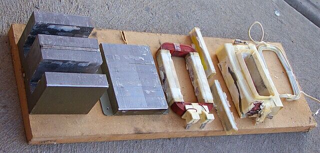

Roll-your-own output choke.
I knew right from the start that the reason why this type of class A amp with it's output choke is not very common in DIY circles is because a suitable choke is sometimes hard to come by and/or not everyone has on in their junk box, let alone two. What's more, most diy'ers are a bit scared to have a go at winding their own. Now a mains transformer might be one thing, with safety issues and what-not, but a choke is pretty tame with it's single winding and no big deal on insulation for low voltage apps. But why use a choke anyway? Because it halves the power dissipation at idle. e.g if you want 50 watts output you will have 100 watts dissipation at standby, whereas if your amp has a constant current sink instead of a choke you will need double the dc supply rail at the same current so your 50 watt amp dumps 200 watts when all is quiet. You end up needing twice the number of power devices, double size power supply, double sized heatsink etc etc. Also, with a choke output amp, if one of your output devices decides to go s/c then it will momentarily pull a voltage across the choke until the fuse pops, the chokeless variety may well give the speaker voice coil a dose of DC trauma.

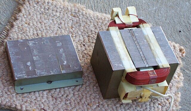

But I digress... I did a bit of "kerbside shopping" this afternoon and came home with two old microwave ovens. One was a Sanyo only several years old but with an arced magnetron.
Anyway, seeing these things are produced in the millions, the manufacturers investigate every method of simplifying construction to cut costs. One thing they cut corners on is the transformer, which judging by the size would be between 300-500 VA depending on the oven power. They actually get hammered quite a bit harder than this and have forced air cooling. To simplify automated assembly of the transformers, they are butt-stacked, that is, all the E laminations are stacked together and all the I laminations are also stacked together. They are plonked together and a seam weld is applied across the length of the joint. Normally transformers have their laminations interleaved with the E pieces stacked from alternate sides and the I pieces fill in the gaps. With the butt stacked method there is a slight air gap between the E stack and the I stack which would normally be undesirable but in an oven tranny the extra leakage reactance caused is actually desirable, sort of like in an arc welding transformer.
Taking a close look at one of my trannies, it occured to me that I could simply run an angle grinder along the length of the welded seam holding all the E's to the I's and then they would easily separate, and what's more, because of aditional welds, each would stay together as one piece instead of going into dozens of separate slices. Once the (one piece each!) E and I have been separated, it is a simple matter to slip off the original winding, also the magnetic shunt that fits between the primary and secondary windings. Throw that piece away. If your particular transformer has a bobbin then things will be easier from this point on. Remove the old wire from it. Wind up a new winding and slip it over the E centre leg and then replace the I piece, and put a layer of plastic between the E and I about 0.5mm thick to begin with. A suitable inductance would be about 100 milliHenries, the smaller the gap the higher the inductance (the higher the better actually) but it also makes the choke more easy to saturate, the magnetic equivalent of clipping.
What wire to use? My gut feeling is to fill the entire winding space using 1.5mm enamelled copper wire and begin with a 0.5mm magnetic airgap. See? Chokes are easy. Cheap too. I'll see if I can post some pics in the next couple of days chronicling my adventures with this approach.
Now we're getting somewhere. You can see where I ran the angle grinder disk along the welded seam so the two halves would separate. I cut in about 2 mm which is probably a little deep. About 1.5 mm would have been enough. The two faces were glued together as well so I had to hit it fairly hard with a hammer to get them apart. Be careful you don't break anything here.
Once the two core halves are separated you then have to remove the coils off the centre pole. This one had a pair of wedges between the centre pole and the coils so that had to be tapped out with a screwdriver and hammer first. Then use the hammer to tap off the coils and you are there. Pic shows E's, I's, 240v winding, laminated iron shunts, high voltage winding, and magnetron filament winding. You need none of those, only the iron core. Next installment will be telling of my adventures actually rewinding the thing.
Different gaps for different chaps...
