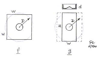

Grandma´s_SUB said:Must be baffle necessary like square(effective area)?
The shape of a flat baffle is not important. Mount the driver at least somewhat off center for smoothest response. Keep in mind that the floor forms an infinite baffle width in that direction, so a woofer can be mounted at the bottom which increases the effective vertical baffle width. Having the sides folded back increases the effective baffle width using the same amount of physical baffle because it increases the distance the rear wave must travel to reach your ears. Folding back the sides, while much more compact, can introduce cavity resonances, but those are normally outside the operating range of a sub.

About open baffle;I will build 12db variable gain, to reach as close as possible 0db, "from eye" Iål need about 16W(88db@1m/1w).I have 100w tda 7294 amp(my 1st home made amp
), so it should be about 100db maxSPL(84W).
-Maybe this will be little of SPL for home parties
-But if I build sealed enclosoure ,there is a 6db peak;

I think you'll be banging that back plate with relatively little power applied. For same output as sealed in the low frequencies you essentially need 4 times the drivers, so 88/1w/1m is more like 82db/1w/m in the low frequencies for dipole. You run out of excursion pretty quickly.

At open baffle, you need more power and more drivers as you said, because bass response is bad
-only good thing is,that you can use "crap" drivers
I read a lot of posts and get this:"dipole/open baffle ruls at hi-fi"
-I compared standard enclosoure and open baffle tran. magnitude graphs(bass response in shortly) and there is no diffirence at all(dipole was equalized and gained..), just dipole had a little beter bass response, but maxSPL is terrible(4 drivers needed)
