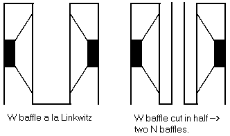

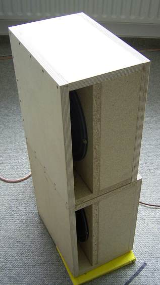

Hi Rick,
I´ve added a picture showing the transition from a W baffle to a N baffle. Note that I have deliberately shortended the width of the front opening (area is 25-30% of driver Sd). That is the essence of a Ripole. (R stands for the surname of its inventor Al Ridtahler)
Back opening should be just wide enough to accommodate the driver. Some people even put a hole for the magnet into the side baffle to keep the opening narrow.
To give you an idea of real dimensions: http://www.klingtgut-lsv.de/shop/index.html?d_dipolsub_Dipol_Sub_von_Axel_Ridtahler312.htm
Because of the tight volume "seen" by the woofer the "in-box" resonance frequency of the woofer will be significantly lower (~20%) than its free-air resonance (in contrary to a Linkwitz dipole, where free-air resonance is almost equal to the resonance "in-box").
Please keep in mind that above resonance depends on the individual driver. Don´t confuse it with the box resonance of the baffle.
My 2nd picture shows schematically where the difference between a standard dipole and a ripole is (red= standard, blue= ripole).
